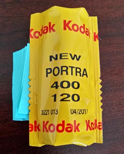

I've just noticed that the OP (moodlover) has added this to his first post:
UPDATE: Kodak Alaris has informed me that in Dec 2015 they fixed this issue. T-Max 400 produced with this new paper starts with emulsion 153. Portra 400 produced with this new paper starts with emulsion 3272. I've come to the conclusion that B&H and Adorama in NYC are still selling old film before this fix, because my batch numbers for the ruined photos below begin with 3231. So Kodak is not at fault here.

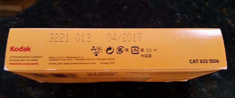

Potentially ignorant question: is batch number on the packaging so a buyer can verify and reject old stock, or is it only between frames 11/12 and require processing to see?
ignatiu5
Feb 16, 2007
334
Philadelphia, USA
Batch numbers are on both propack carton packaging, as well as on the foil wrapper of individual rolls.
Thanks very much. I guess I never really paid enough attention to the packaging.

I am confused too. Kodak Alaris has informed me that it's highly unlikely for B&H/Adorama to hold old stock since their turnover is fast. This is what I expect. But I'm not making this up, I have been purchasing lots of 5-packs of 120 Kodak Portra 400 all of this year and last year from these stores and no where else since I live close to them. I do not hold inventory which some people (even KA assumed) from 2015, I use my film one or two days after purchase. Nothing is saved more than two days, certainly not two years.
I even sent KA invoices of my purchases from these stores that date the purchases past the "fix" but again, probably useless to them since they can't prove anything with that. KA seems to be kind enough to reply, but how can we nudge B&H or Adorama at all?
