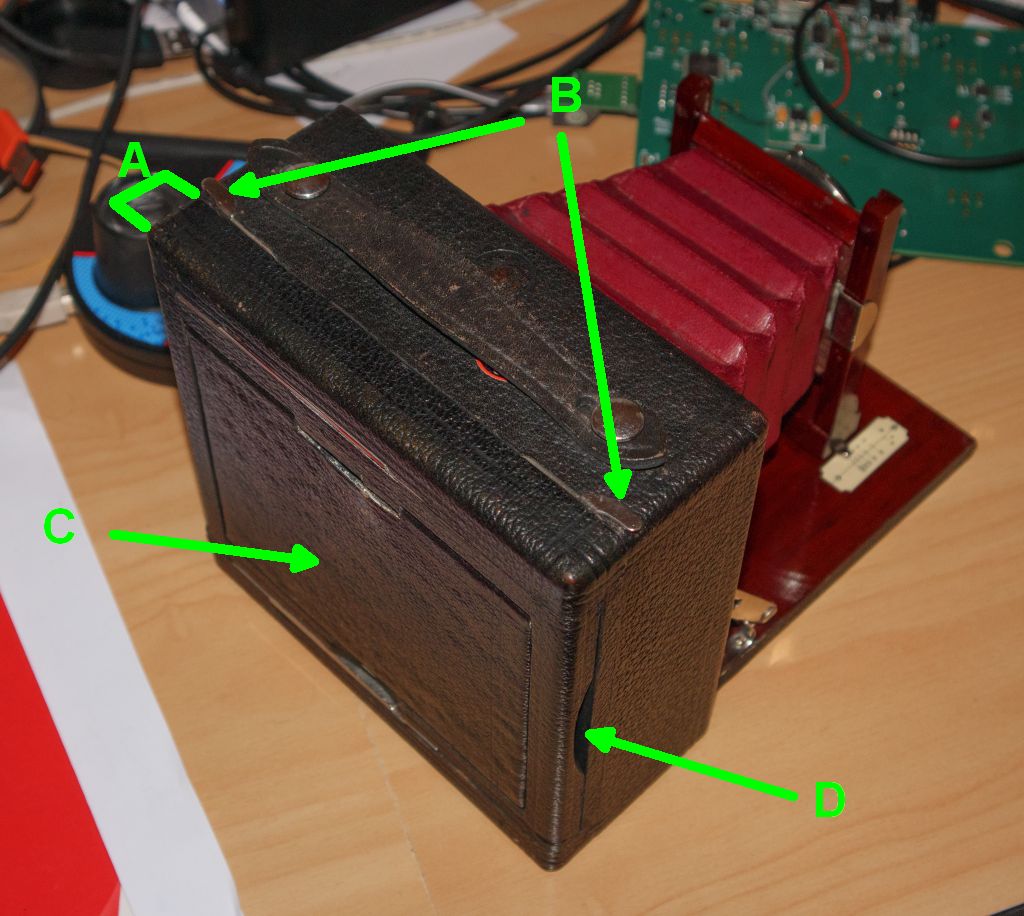

I'm pretty new to this too so my terminology may be wrong but I'm using a Premo #2 and have a disemboweled #3. The #3 has a focus knob that the #2 doesn't. Otherwise they're the same.

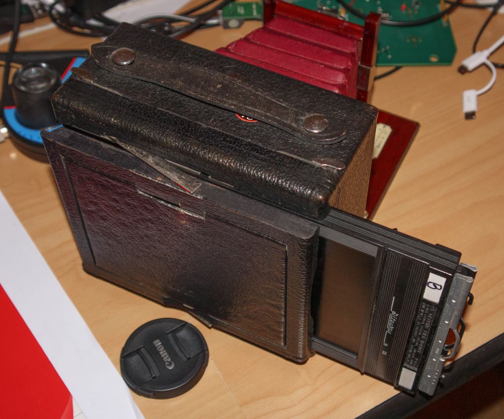

The back section that I've labelled 'A' contains the ground glass and the plate holder holder (?). You can lift the two clips (B) and lift the back section a little and it comes free. You can then orient it for portrait or landscape as you desire. You open the cover (C) to see the ground glass for composition and focus with the shutter open using the 'T' setting. The spring loaded thing is labelled D. Put your finger in the recess and it will pull back to allow you to insert a plate holder. The ground glass is now behind the plate holder and out of the way. Close the shutter, set it to the speed you want and the aperture, remove the dark slide and make it go click. Replace the dark slide and remove the plate holder.
One thing I like about the Premo's is that you can use a modern 4x5 film holder like a Riteway, Fidelity, etc, rather than trying to adjust for the plate thickness with the original holders.

Hi Steve- wow, that is great, thank you. It is a little stiff and I didn't want to wrench it too much until I fix up the leather more, but 'D' in your images is exactly what I was looking for. I was not yet ready to get a little brave with it ; )
That is a great tip about the 4x5 film Riteway etc film cartridges. That is a really neat option to have and those are available used pretty cheaply!
