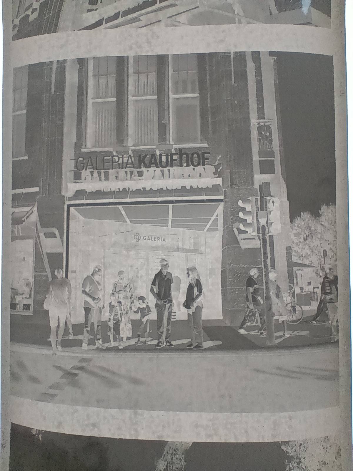

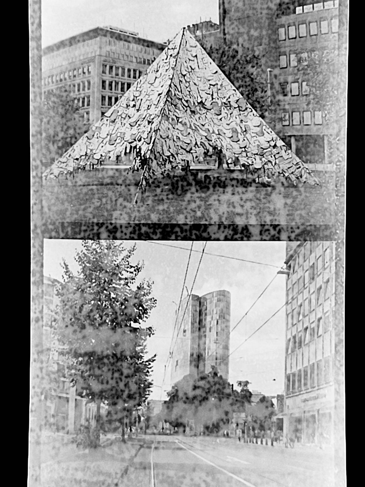

Agfa Isopan IF, Exp. 1972
If it is a 120 film you will encounter some heavy backing paper mottling issue.

Uh, too bad. Stiff acetate base is an issue with old films. I encountered it with Orwo NP15-135, Exp. 1993. The transportation in my Praktica was impossible with the last 10 frames, and the perforation broke due to the enhanced force. When I unloaded the canister in the darkroom, it was very difficult to get the film out of it completely. The base had become very stiff and curled, especially at the end.
