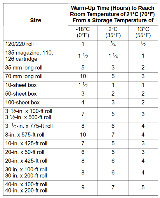

Interestingly enough, in their version of the same sheet from 2005, they do.
"Warm up after refrigeration. To prevent condensation on the surfaces of film or paper taken from a refrigerator or freezer, allow the package to warm up to room temperature before breaking the seal or opening the container."
They provide a table for "warm-up times":
Why did they stop recommending freezing? Who knows. Maybe they thought people were using too much expired film.
It's noteworthy they also say, "While storage in a refrigerator or freezer can be highly beneficial, you should not rely on it to extend film life beyond the “Develop Before” date." That indicates they simply considered refrigeration or freezing to be the proper way to store the stuff.

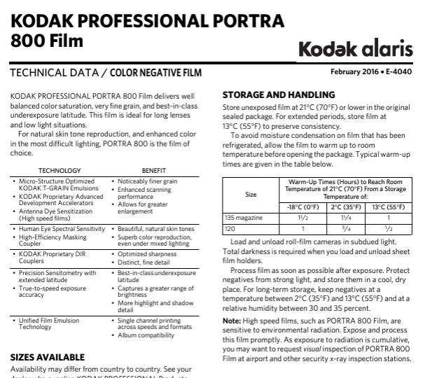

Interestingly, the individual datasheets for Kodak colour films differ with the film.
The Portra and Ektar datasheets include tables like this one from Portra 800, which includes information respecting freezing:
In comparison, the datasheets for Kodak Gold, Kodak Ektachrome and each of the Kodak black and white still films mirror the current Storage and Care CIS E30 document - no recommendation for freezing, although some of those datasheets include information about refrigeration.
