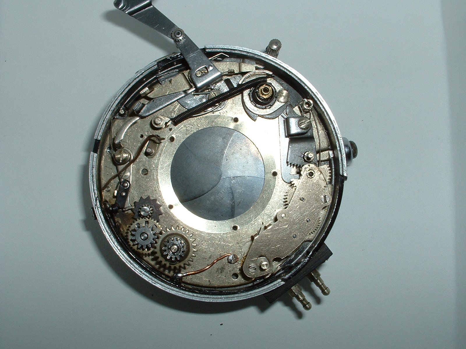

Supermatic shutters are moderately difficult to service if you have no experience servicing shutters.
The service manual can usually be found for $20 online and it covers 3 or 4 versions of the shutter.
I can email you the 10 pages for the Monitor 620 for half that.

Supermatics are often greasy. Which will cause them to bind up, etc. You'll need to get this old grease out and add a small amount of new lube in the appropriate spots.
As to how hard this is, that's your call. If you haven't been inside a leaf shutter before, assume that you will be doing an autopsy, not a repair. You can try the lighter fluid flush system, but for Supermatics this will be a 5-step process because they can be pretty dirty. And there is no guarantee that it will work.
