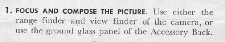

Where did you read that last part about rendering the Medalist rangefinder useless when using the ground glass back???? That one is news to me.
The page may be completely wrong, but if you have the back, its easy enough to test.
That page also mentions an additional accessory that pushes the film plane even further back to give some macro distance. That would definitely throw off the rangefinder but based on the wording/order I interpred the line about the rangefinder as talking about just the straight accessory back.
OK, my bad. I decided to poke around some more and quickly found this document:
On page 5:
So my previous link is clearly wrong, or I misread it.
On page 5:

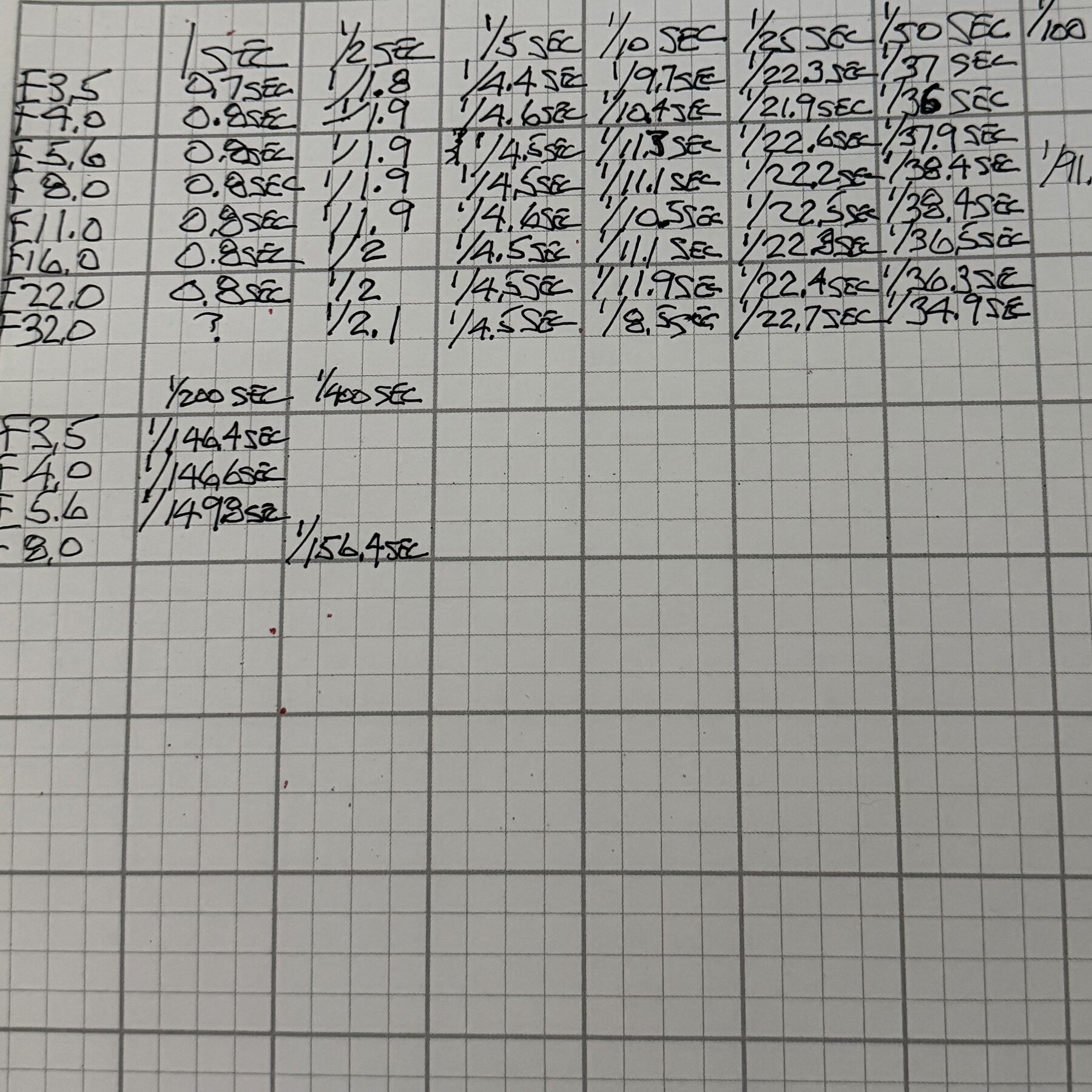

Dan-while waiting on CLA on my Medalist from you(think I’m in line for October),I acquired one of those Photo Plugs that measure shutter speed with iPhone app and flashlight. See attached. Question-is this info useful for setting exposure or best ignored?
Thx

DougView attachment 424817
You'd pretty much average out your number of readings for each speed and use that as your "real" shutter speed for that setting on your shutter. I was told many years ago, by a very good camera repairman, that it's much more important to have consistent shutter speeds that were slightly off the mark than it was to have it was to have a speed be right on one shot and then way off on the next. He also said that even brand new 35mm fancy cameras off the shelf aren't perfect when it comes to shutter speeds. It's almost always the top shutter speeds that suffer from age. While lower speeds usually suffer from gummy shutter blades.
