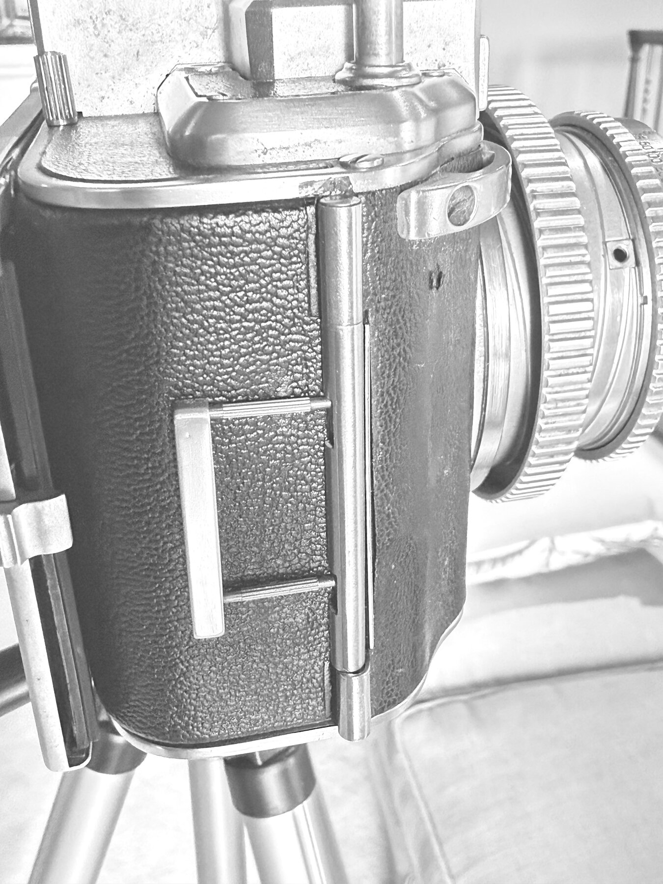

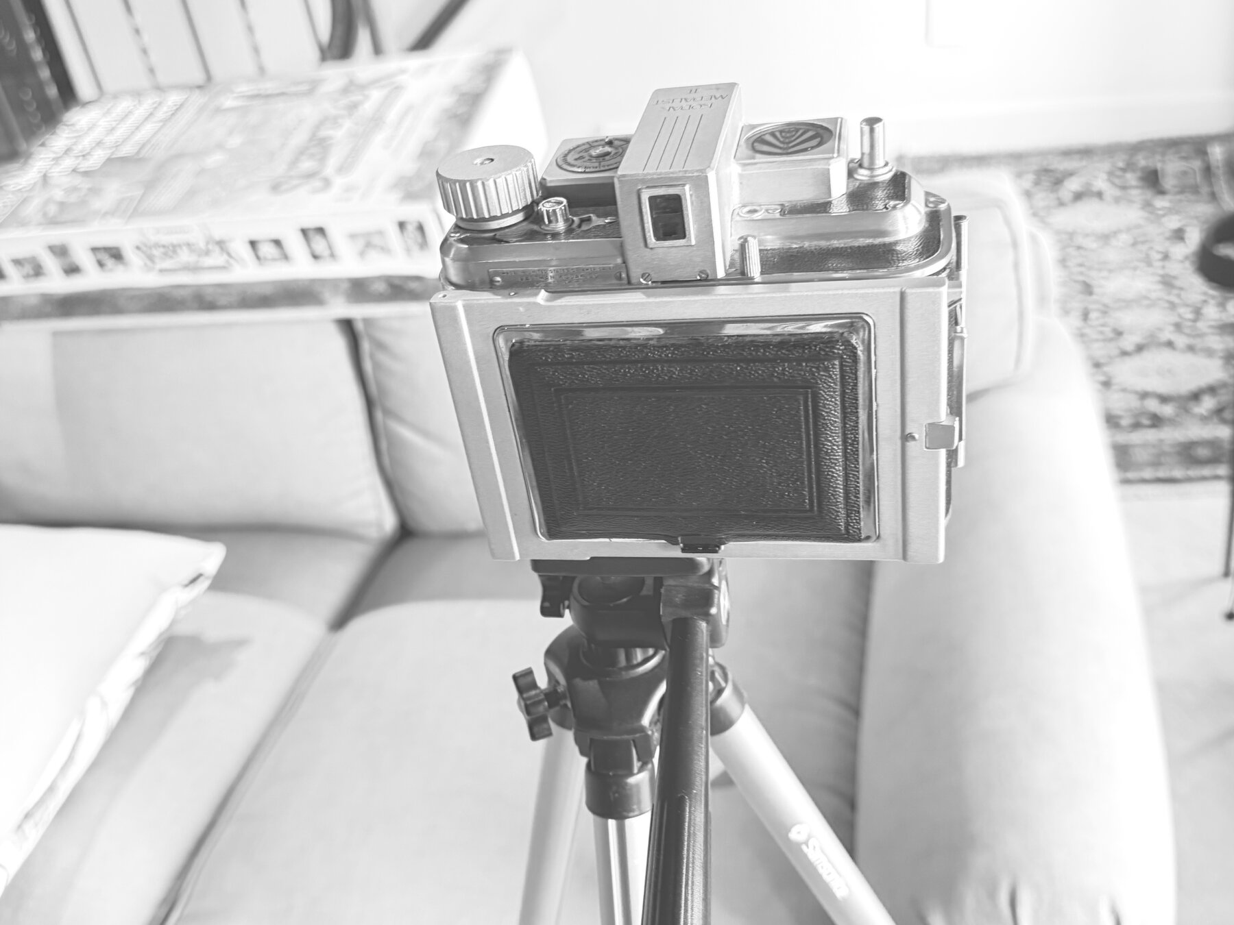

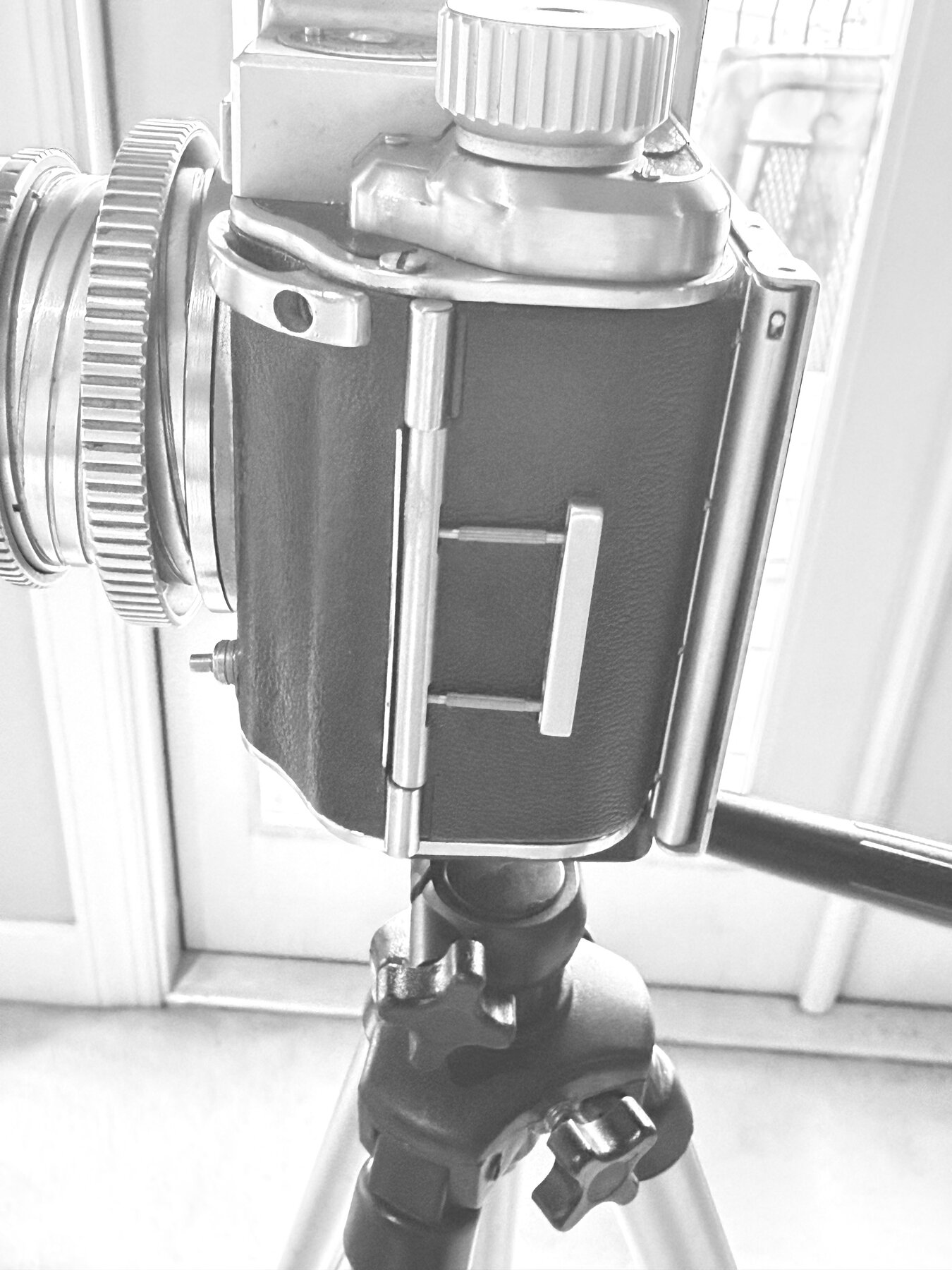

How do you make fine adjustments to hinge pins on Medalist accessory back to better fit camera?

Bought an accessory back for a Medalist II. Trying to get it to attach properly to camera

I've had several different backs and several different cameras and never had a problem attaching any back. Could you take a picture of the problem area? There are also four adjusting screws on the ground glass backs that have to be adjusted in just a certain way to align the ground glass plane into the same field as the film plane of the camera. Other than that there is no special trick to attaching the ground glass back to the camera itself. Unless you are doing something wrong????

Just to check this off the list- the hinges are not symmetrical. The back needs to be in a particular orientation to fit. If you rotate it 180 degrees, it won't fit.

One can probably get by without making the four screw adjustments, but Kodak did have a specific sequence for adjusting those four screws on the back. According to Kodak every back had to be adjusted to mate with a particular camera. another words you weren't suppose to just swap a back onto a different camera without doing the adjustments. I have Kodaks complete instructions for the accessory back and that's what they state. The regular back has no adjustment screws and is mated to the camera right from Kodak. You and I might not even know the difference in a final print as to whether the back was properly adjusted or not. That said, mine are all adjusted and mated to a certain camera body. I'm still having a hard time figuring out where the OP is having problems.
It's been a long time since I installed the ground glass back. Do the adjustment screws affect how the hinge pins on the back would sit in relation to the 'tubes' on the side of the body?
I hear the OP as having the hinge pins not inserting into the body 'tubes' properly, but you are right to ask for more clarification.

I have been a Medalist nut and user since the 70's and have never had problems with the backs. I have had the little sping tensioned holders that hold the back pins lose their tension an not hold the pins back inside the hinge tube, but then just used the tips of my fingers to hold the pin in while closing the back.
As far as the four screw adjustment and back installation troubles? I really don't think that the screws being out of adjustment would have anything to do with installing the back properly. Those screws are for aligning the film plane with the ground glass exactly spot on. Dan, have you ever read the complete ground glass back installation process instructions? If not, I could take some pictures of those instructions and post them here later this evening. Also, I wish the OP would show us where he's having the problem as it would certainly help me try and figure out what's going on.
Thx for replying. I did do all the adjusting as per instructions-four small screws, four larger screws, test with paper, etc. this accessory back won’t quite align where pins will engage. I’m returning it. Do you happen to know where to look for one other than eBay

That certainly sounds like the fat lady sat on it and sprung it out of shape. Alright, maybe I shouldn't have used that "fat lady" line. How about the fat guy sat on it and sprung it? Alright, enough of that, but it does sound like the thing has been sprung out of shape. As far as finding another accessory back goes, I'd say your best luck is eBay by far. But, like you already know, you roll the eBay dice and take a chance. Most of the time you'll win, but a time or two you might lose.

As best I can tell the adjusting screws would not relate to the hinges. I finally got the accessory back to “attach”. Not perfect but pins are in a good ways. I went through the “four screw and paper adjustment” twice. I then focused on one of Dan’s paper targets at 10ft with ground glass and magnifier. When I looked through the split screen range finder, the split image was just a tad off. Do you consider this unusual? I have a ground glass coming this week so I can accurately check the camera focus from the film plane. That could be the issue. Thanks to both of you for your comments! I’m a neophyte to all of this, but having a ball!
