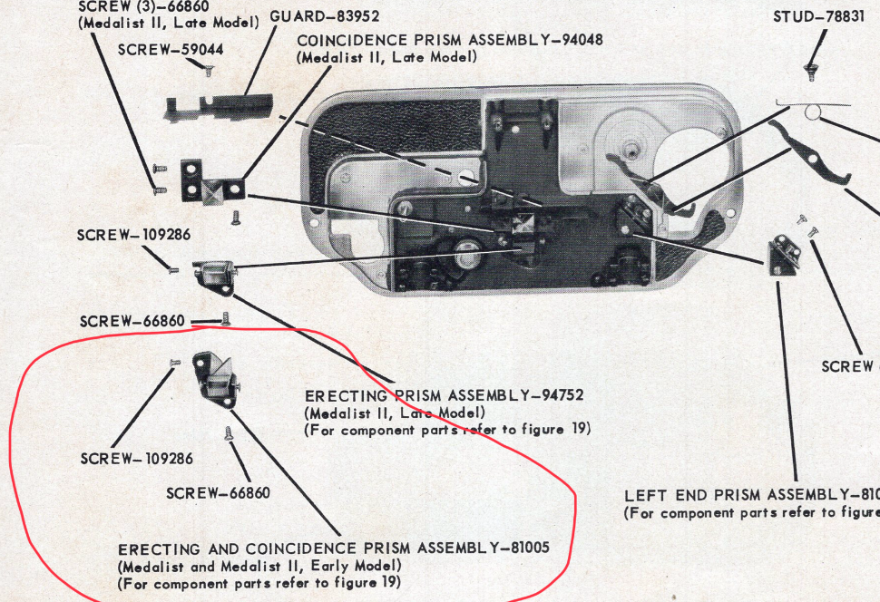

No screw on the follower tip, I think this an earlier-style ragefinder. Looks like adjustment of the left-right alignment of the right prism is done through differential adjustment of the screws on either edge of the prism holder.
Best to not play with those screws on the prism holder. They adjust tilt of the image and are pretty touchy. I do have a way to adjust the tip when there is no screw as on earlier models, but I won't encourage anyone to try it unless they like crude mechanics and have a spare part or two lying around.
