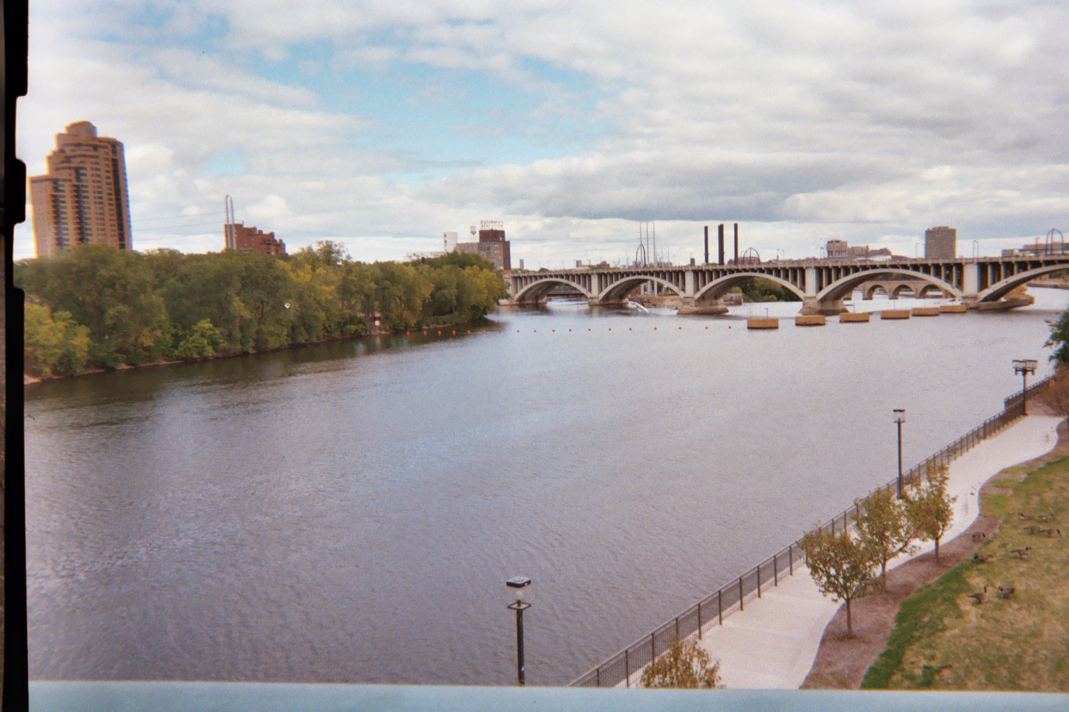

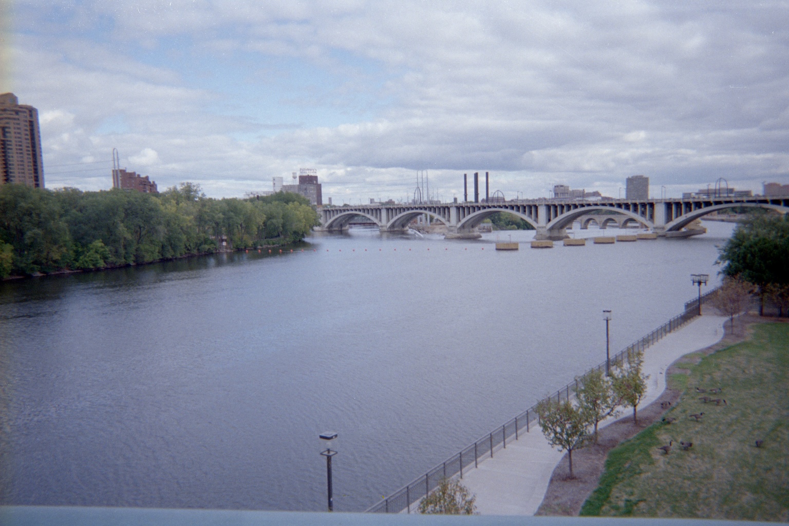

I have some PictureCD 6.0 from 2003/04, I used a disposible camera to take these shots, so they are not the sharpest to begin with. The scans where made with something called Kodak CLAS Digital Film Scanner / HR200 which I can't find much on the internet about. Some were not correctly cropped for the scan, it is unlikely someone in the lab looked at those for more than just a few seconds.
i rescanned the negative a while ago with a Plustek OpticFilm 8200i, which a bit too cool for my taste but I couldn't be bothered to fix that.

I know. But I didn't bother when I scanned it. Since then my process of scanning has changed also. I find those differences between the Kodak and Plustek scan interesting but I wonder what this yellow "fog" on the left is.
I only uploaded the scans because the discussion was about old Kodak PictureCDs and I wanted to show the difference. It was never about the colour of my scans. I might have used weird settings for my scan but I can't remember.

1. I was NOT talking about the colour, please stop talking about the colour of my Plustek scan, it doesn't matter!
2. I wasn't using the Plustek supplied software.
I was just an example of those two scans, also the colours in the Kodak scans are not good either.

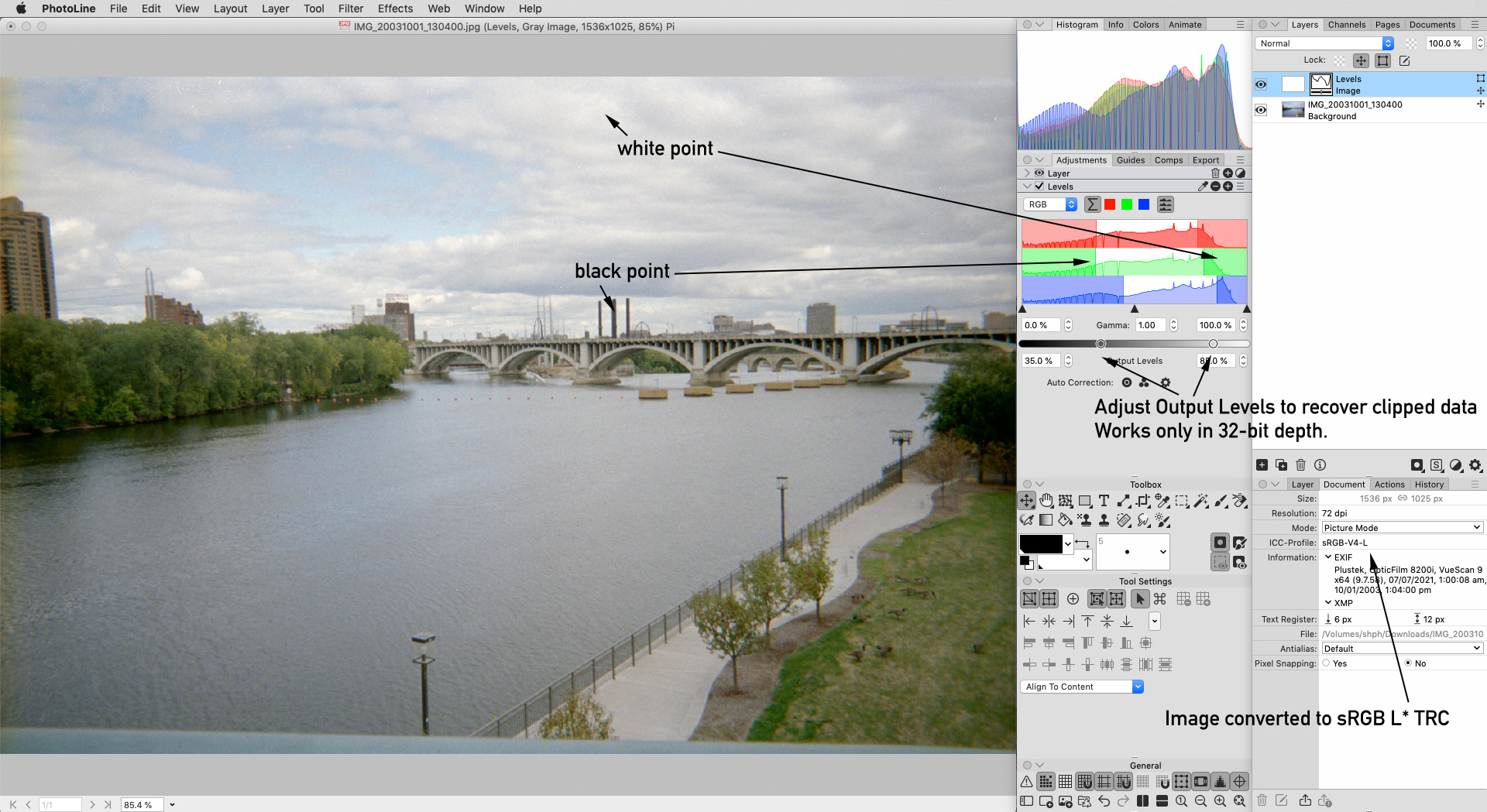

Here is my small recearch about importance of wider color gamuts:
Even if PhotoYCC color gamut is same as sRGB, wider color gamut output makes sense to recover possible hidden data. Here is info from Wiki article:
"This encoding scheme is that it allows Photo CD images to represent colors which are above 100% (up to 140.2%), "whiter than white""
"Kodak expressly allows the use of R, G, B < 0, allowing out-of-gamut (for Rec. 709) colors to be expressed. The effect is similar to xvYCC, which came much later."
To prove theory in real life, i done some tests with PCD example images from https://github.com/wcDogg/test-files/tree/main/Kodak-Photo-CD/pcd and find that some of them have clipping due too saturated colors and too small sRGB color space.
pcdMagic exported to TIFF ProPhotoRGB
pcdtojpeg exported to JPEG sRGB

Here is another theory from Sandy:
"I very much doubt that there is any clipping in those images. The main difference between pcdtojpeg and pcdMagic renderings is that pcdMagic uses scanner specific color profiles, and pcdtojpeg, at least the current version, does not."
And my side by side test. pcdMagic’s sRGB jpeg and ProPhotoRGB tiff both have no clipping:
