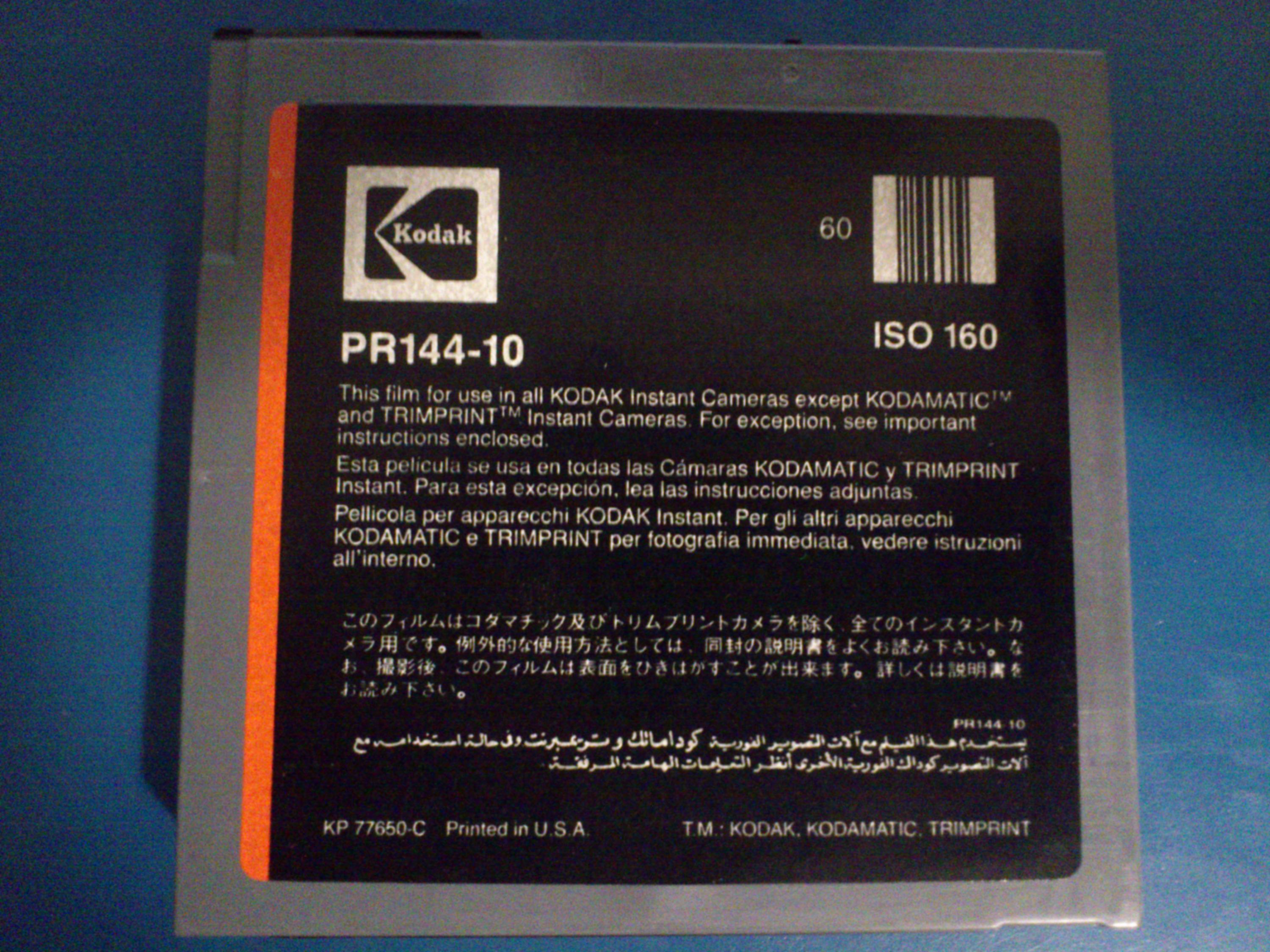

Hi All,
Here she is PR144-10. I bought the colorburst 50 today and started trawling and found this thread. Thanks for the links to modify was curious if the Instax worked as a possible replacement.
Cheers
Johnnie
Prof_Pixel
Feb 17, 2012
1,917
Penfield, NY
Hi All,
Fuji Instax is basically Kodak Instant Film; Kodak licensed the technology to Fuji, and Fuji was never sued by Polaroid so kept on making the film for sale outside the US and Canada. For a while, Fuji film packs could be modified to work in a Kodak camera. This is no longer true.
