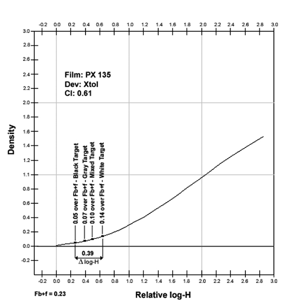

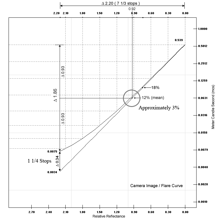

Diapositivo, I am working on an explanation for you. I'm trying to organize my thoughts and distill them down, but it's coming.
FYI, Bill Burk has just uploaded another paper for me. The Incident Light Meter Method of Exposure Determination by D Connelly. It's available at http://64.165.113.140/content/benskin/ along with most of the key papers on exposure. Thanks again Bill.
Flare at the metered point is small. The standards have it as 3%, but in the shadows it is around 1 to 1 1/3 stops for the statistically average scene.
Flare is critical to understanding film development, tone reproduction theory, and exposure. I've posted extensively on flare over the years. Here's an interesting thought, let's put the burden of proof on the doubters. Prove it doesn't exist. Simply not believing in something isn't proof. It's a logical fallacy - argument from incredulity.
Here's a black box test I did. The black box opening was surrounded by targets with different tones. A sensitometric exposure was made and run with the test. The results are plotted on the sensitometric film curve. Without flare all the tests would result in the same density.

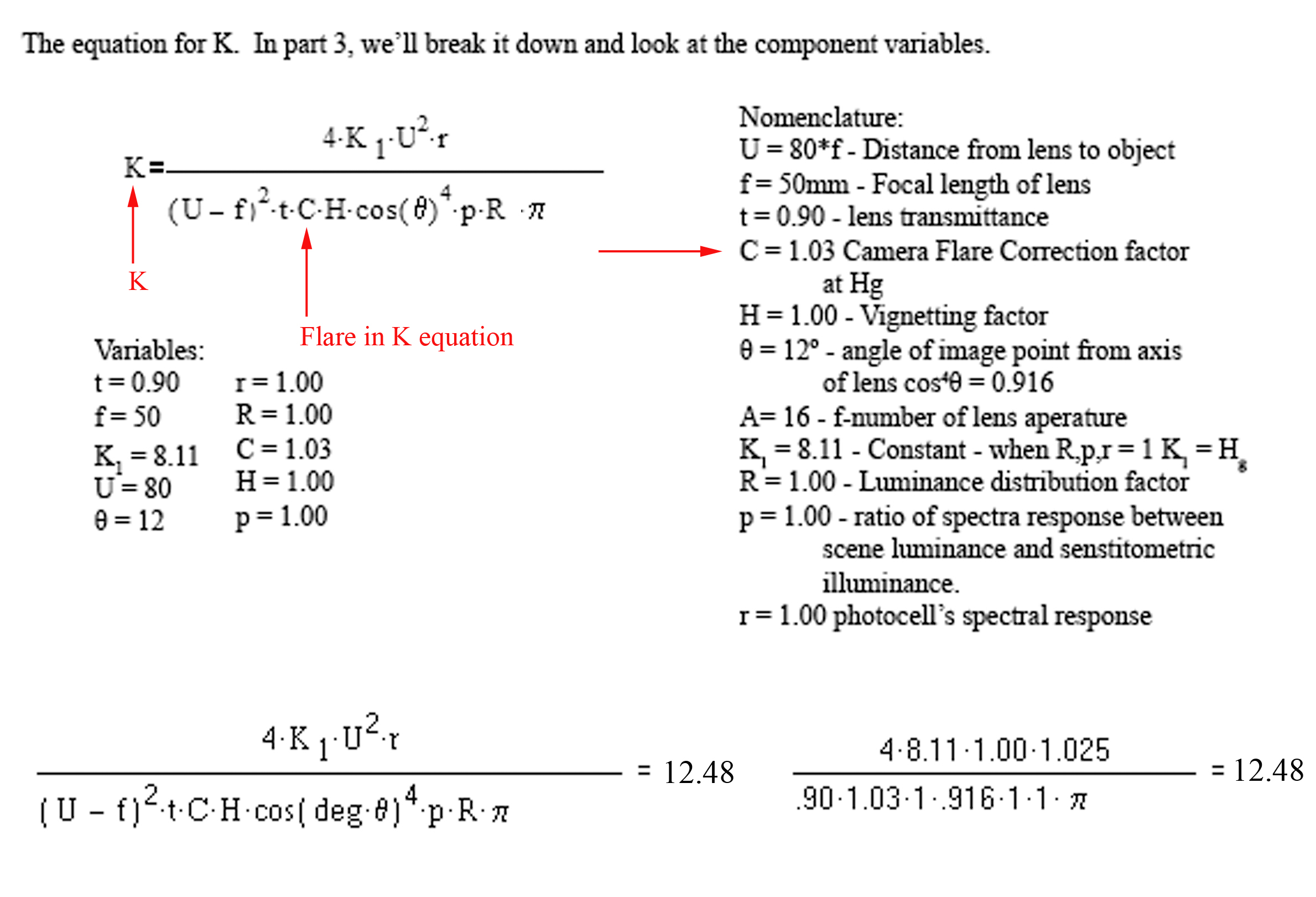

the formula for a reflected meter is:
2Ev = (B*S)/K
EV = Exposure Value
B = luminance in cd/m2
S = ISO Film Speed
K = K factor = 12.5 (using 12.5 equates to multiplying by 8% (0.08) hence B*S*0.08)
So
0.5 * 100 * 0.08 = 4 = EV2
4 = 2Ev so to convert from that to EV you must take the log2 of 4 which = 2
so you get
16 * 100 * 0.08 = 128 = EV7
a difference of 5 stops

Let's not forget an important component.
2Ev = A2/T = (L*S) / K
Ev is for the exposure calculator, but it's important to show the relationship to the camera exposure.

This simple test will demonstrate the impact of flare in your spotmeter.
Find a suitable dark subject at a distance, say the open door of your home from across the street. I opened my garage door instead because I didn't want my dog to run out of the house while I'm doing this... he's tired now since we just got back from the hike and doesn't look like he wants to budge, but I don't want to take chances.
Now walk towards the open door keeping the meter aimed at the opening. As "Black" becomes the dominant tone of your viewfinder, the flare that elevated the original reading will not be elevating the reading. You will have a lower light level reading as you get closer because the influence of flare is becoming less of a problem.
You can say that the camera and meter will both see the same flare, and that's reasonable. They are both similarly impacted by flare. The more detailed formulas break this out separately... when making a spotmeter the manufacturer can know it's own flare, but has to assume how good your lens/camera system is. Adding TTL and OTF metering gives us variations on the theme - where some of the variables can become known. (Too bad the OTF capable camera designers did not include a small reflection densitometer to read the tail during film loading and store the actual reflectance of every roll of film you load...).

Oh, and please explain how it that when K = Film Speed there is no adjustment for flare or are you in denial of that.

Here's something else to think about. P/q = K. So 8.11/.65 = 12.5. What if the lens had a lower transmittance and q equals 0.58 instead of 0.65? 8.11/.58 = 14. This is basically K. So a K of 14 will produce a camera setting that will let more light into the camera, but if the lens has a q of 0.58, the same amount of light will hit the film plane as a lens with a q or 0.65 and a K of 12.5. The idea is to create the same exposure at the film plane. Don't forget the ratio from the speed point to the metered exposure point. This and the film speed sets where the exposure should fall.
There's another proof I thought I'd share. The ISO standard has K1 = L*t*S / A2 as the calibration equation. Example, 3200 * 1/100 *100 / 256 = 12.5. Notice how it's basically the exposure equation without q? If you recall P/K = q. The ISO version of the calibration equation clear shows that K is primarily about the camera's optical system.
