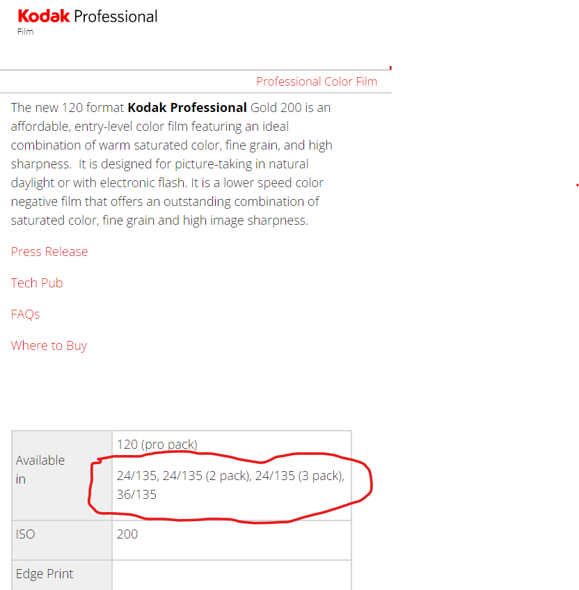

From the Kodak Alaris website:
The listing is for all different available sizes of Gold 200.

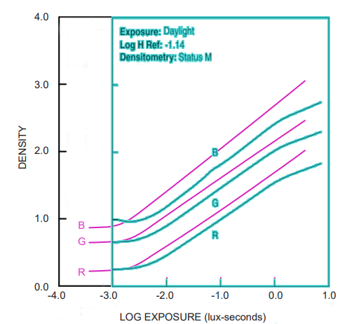

Maybe that's simplifying it a bit. Here are the curves of Gold 200 (cyan-ish) and Portra 400 (magenta-ish) overlayed on top of each other:
Gold shoulders off quite pronouncedly, but it takes quite a while for this to happen. The toe is also not as nicely controlled as in Portra, and the channels of Portra track a whole lot better than Gold's.
Of course both films share a lot in terms of technology, but implying they're somehow the same product slightly tweaked...nah. The data don't add up to that picture.
Gold's blue channel characteristic curve has an obvious plotting error where density decreases with a bit more exposure at the toe region. In reality, it's better than what it looks there.
That's a weird anomaly, yes. It's also so deep down in the curve that it's barely relevant what happens there.

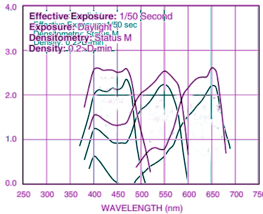

Here's the spectral sensitivity; again Gold 200 in cyan and Portra 400 in magenta:
Note Gold's peak at 470nm, which is a cyany-blue to which it's apparently slightly more sensitive. Portra on the other hand has a thing for deep reds, which probably makes sense since the eye's sensitivity tends to drop there and I guess people like it if those deep reds still 'pop' nicely.
Interesting is also Gold's red/blue crossover; if exposed with a deep violet (400nm is at the brink of UV), it'll start to create a little cyan density (i.e. red positive image), shifting those deep violets to red. Maintain scenes with clear skies and lots of UV may go a little pink as a result. I guess many people will actually appreciate this as it takes the edge of the harsh blue. Maybe.
