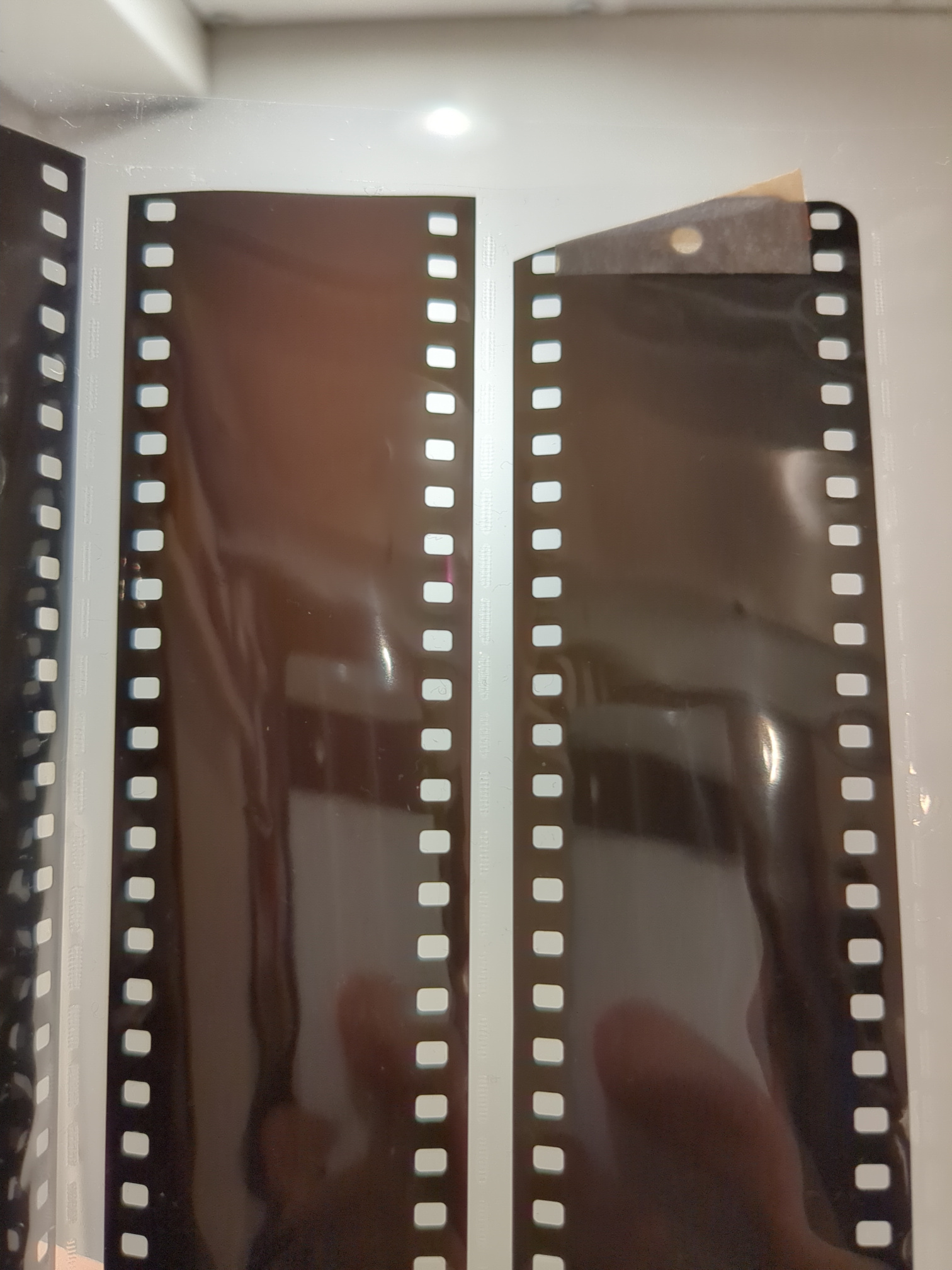

Is it possible that a curious person found the film, and pulled it out of the cassette hoping to see photos, then rewound it back into the cassette?
In that case, the last bit of film that stays in the cassette would have been unaffected. Apparently, that was also fogged. Otherwise this would indeed have been a plausible scenario.

Koraks asked me to chime in on this thread. Relative to the design of Gold 100, the latent image electron/photon traps are strong enough for the film to not go totally black over that time period, so I can't fault the film itself. The tape that holds the film to the core would have to have passed the rigid photoactivity testing to prevent such issues, too. As for fogging of the roll inside the manufacturing operations, there are no lights or LED's within the spooler that could have fogged a roll deemed "good" for sale, and any mechanical intervention for maintenance or supply changes (large rolls of unspooled film or changing a new roll of the film to core tape) would trigger the spooler to change the delivery path of any spools within the process to a waste bin rather than through the exit tube where they are sent for boxing.
I'd wager that the roll was at sometime opened and pulled out and then rewound. I actually did this back around fifteen years ago with a roll of Tri-X that I had received and used to check the winding of my replacement AE-1 and rewound but failed to mark as fogged. I spent a good amount of time in a cemertery capturing pix of lovely grave statues only to hear back from the processor that the roll was black.
It's so absurdly unlikely in my setup, I can't even begin to explain how that would happen. But I suppose nothing is ever completely impossible. Maybe somebody gifted me a single roll of badly-abused Gold 100 at some point and I forgot all about it.
Still, I'm not sure that it explains the even fogging right up to the spool. I would think the light trap would keep the last 2-3cm fully unexposed even if completely unspooled.
edit: excuse the awful snapshot, but just showing that I cut right at the tape. It's the same, even, dark brown throughout, including under the tape, which should have been perfectly protected even if somebody was mechanically screwing around with it.

It doesn't. I don't know what happened to your roll, but I think what to take from @FredK's post is that the odds that it happened at Kodak are next to zero. This roll left the factory in good condition, and somewhere along the road it became fogged. If we'll ever find out how - I doubt it. I do hope that it's the last unsolvable puzzle along these lines that finds its way into your hands!
Certainly agreed, the chances that it was bad at the time of manufacture is probably even lower than the chance that somebody popped this cassette open and then recrimped it 🤣
If you really processed several films together and the problem appears in only one of them, I would rule out the chemistry, and possibly the loading onto the reels as well, assuming this was done consecutively, without any "breaks." Complete fogging of film due to age and background/X-ray radiation is extremely rare - I’ve recovered images from latent images nearly 70 years old. Even when there is very massive fog, it is usually not completely opaque, and in most cases some traces of an image can still be seen. And in this case, we’re not even talking about films that old.
I agree that accidental light leaks of 135-format film wouldn’t make it 100% black either - if the camera back is opened while the film is inside, usually only the outer layers are ruined, while the inner ones survive. Also, the portion wound back into the cassette would show a different tone. My only assumption is that this is a case of thermal shock - I’ve seen films that were truly completely destroyed after being exposed to heat for a long time. Typically, the fogging starts at both ends, near the perforations, and moves toward the center until it eventually covers the entire film. The effect of heat fogging also seems to differ between different films.
