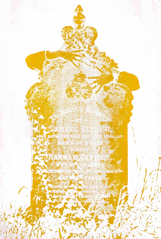

Back in the 1970s I used a similar film in the darkroom

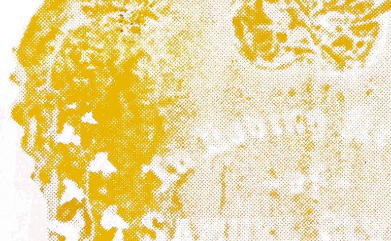

Resizing causes moire patters, but here's an enlarged portion.
I enlarged onto the film then made prints sometimes reversal negatives first. This is an Etch bleach print dyed yellow.
