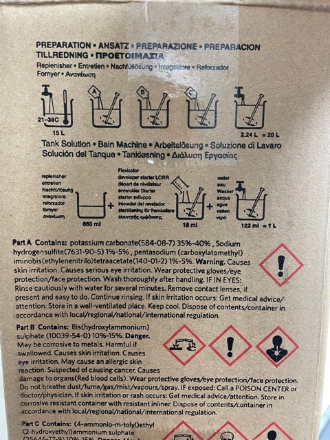

So I just checked the instructions and I mixed the starter with the replenisher to make a working tank solution correctly. 860ml repleshier -> 18ml starter LORR -> 122ml water.
Should I share my negatives? I seem to have done the mixing ratios correctly but still have thin negatives.
That sounds correct. Are you sure about the temperature? Cell phone snaps of negatives are helpful

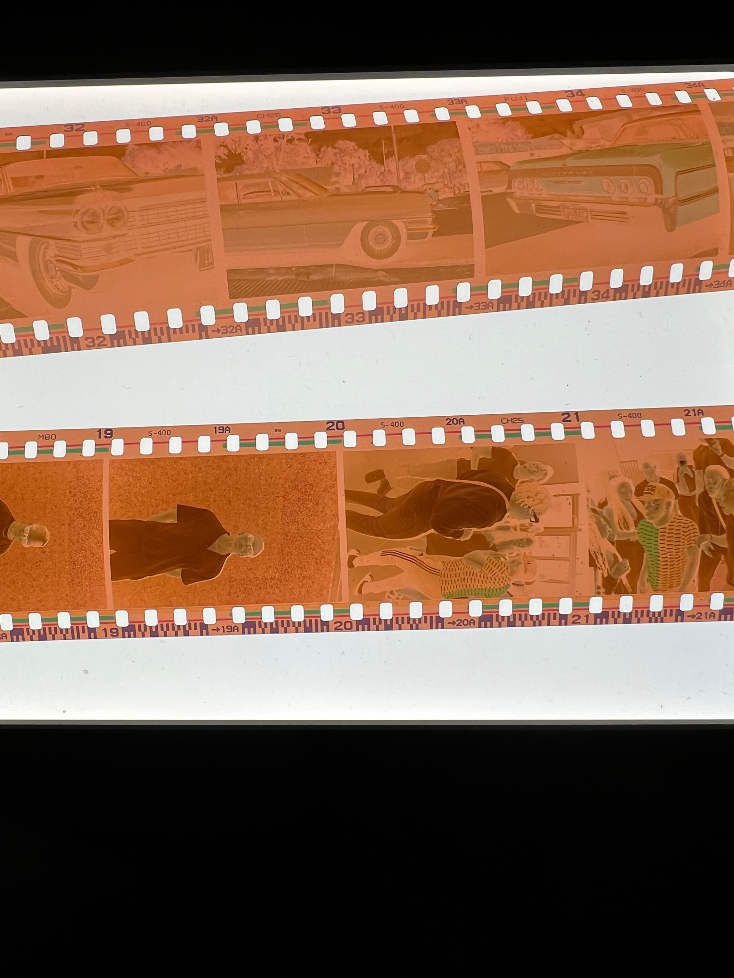

I have been developing at 102F in a jobo cpe 2. I did try a batch at 105F but results were the same.
Top negatives are the recent batch and the bottom is a previous batch before I mixed these.

Looks like the pics of the old Impala are underexposed. Hard to tell.
I run 3'15" @ 100°F in a Jobo.
That's what I was thinking but multiple rolls in the same batch are also like this. Also when looking at the borders they are also thin. Can that be due to underexposure?

To me, the bottom strip looks over-developed, while the top strip looks under-developed and/or under-exposed.

Bottom strip looks normal, top strip is underdeveloped. Check your mixing ratios, verify developer pH and keep a close eye on developer temperature, processing time & agitation.
No, that's the give-away that the top strip is underdeveloped.
Not to me, but I admit it's always hard to judge based on a scan with no absolute density benchmark. But going by what scanners 'generally' produce (debatable statement...), I would guess that the bottom strip is pretty much normal, also given shadow differentiation and how the highlights look.

On my other screen, the bottom strip looks okay :smile:
Which is merely to point out the vagaries involved in these sort of discussions!

I think it may be the first mixture with the starter since the bottom negatives are four batches in a previous mix of flexicolor. I had the same issue with the negatives coming out thin in that first batch but after a few batches the negatives are more developed.
I am using the recommended tank solution mixture from kodak. (On page 5)

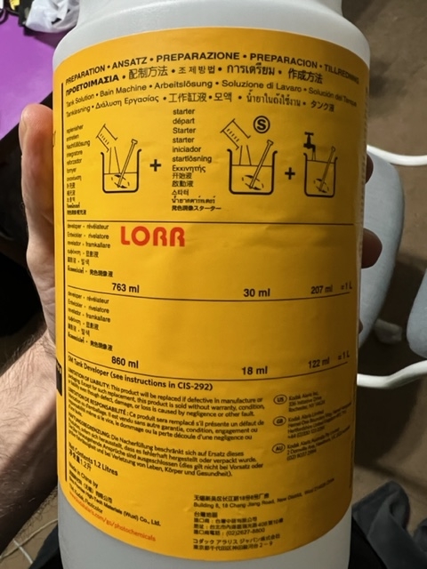

The tank solution mixing instructions for the regular flexicolor replenisher are not correct anymore since the starter listed is no longer available.

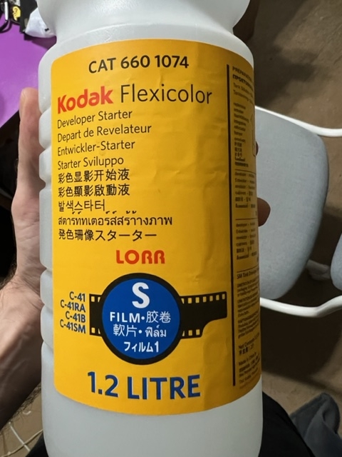

Here is the starter I am using. Someone from another forum had posted the mixing instructions for the flexicolor color replenisher. (3667805). I mixed it into 5L ratios by dividing by 4.
I have tried both mixtures for the starter but both have produced thin negatives.

Here is the starter I am using. Someone from another forum had posted the mixing instructions for the flexicolor kit I have (3667805). I mixed it into 5L ratios by dividing by 4.
I have tried both mixtures on the back but both have produced thin negatives.
The both mixing instructions.
