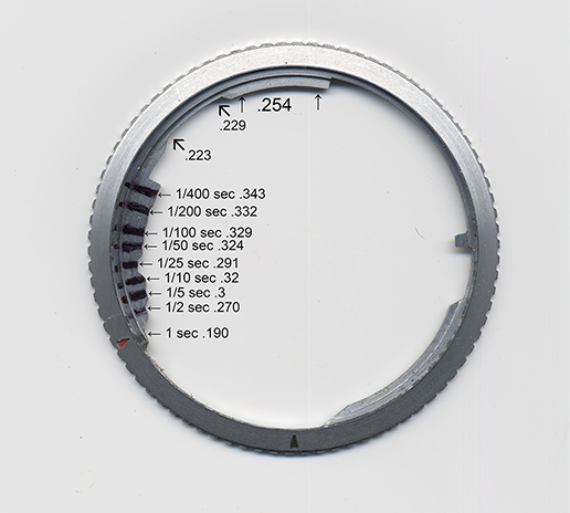

This is a speed ring on a Flash Supermatic shutter.
Inbetween marked settings will not be accurate, use the aperture to compensate as previously mentioned.

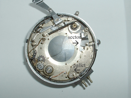

In the photo in post 6 the steps with marked speeds control the sector gear and the section with distance measurements only controls the pallet tension, they work together to regulate the speeds.
Movement is in the direction of the arrows.

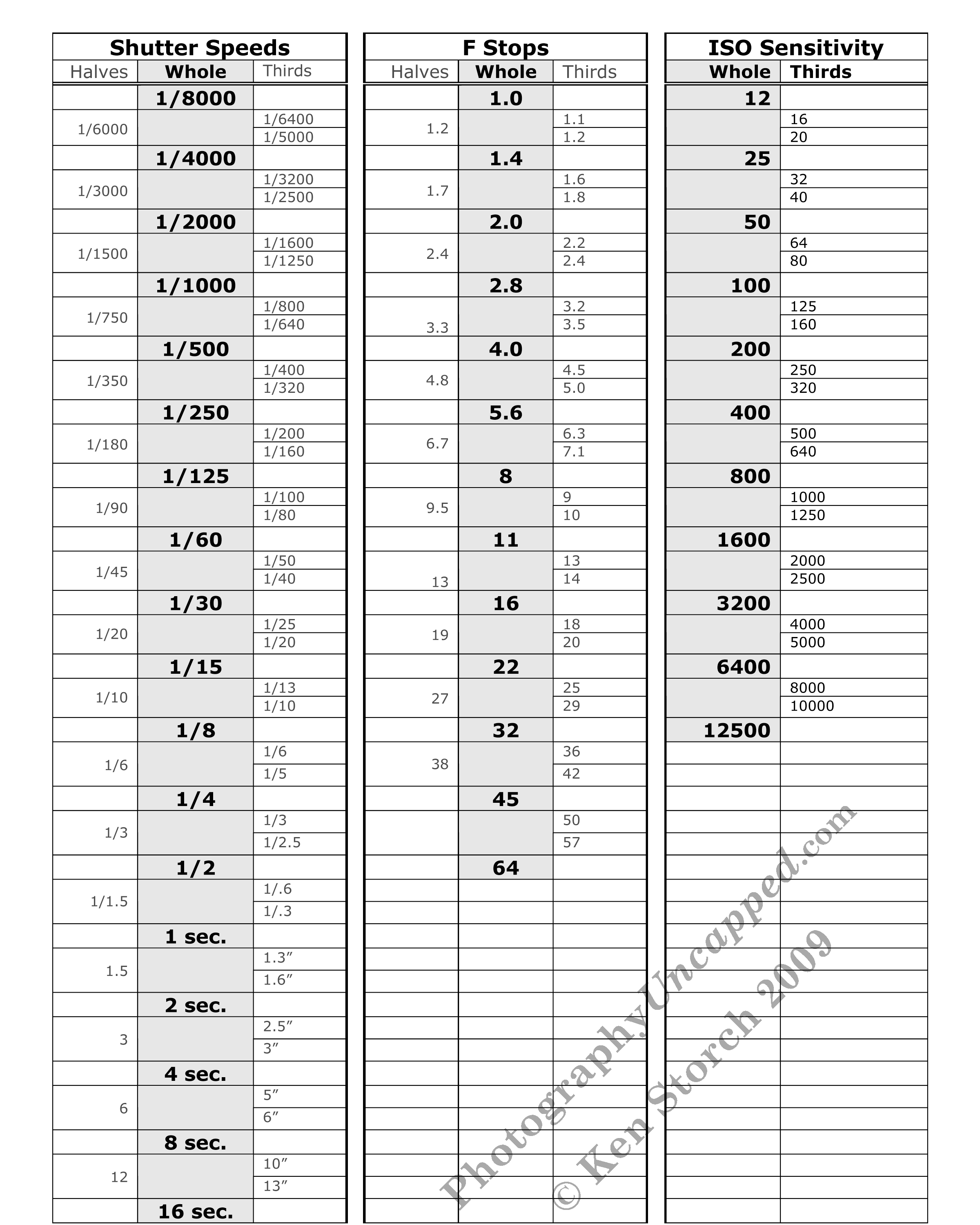

Just for easy reference: Shutter Speeds in approx. 1/3-stop intervals:
1 sec., .80 sec. (4/5 sec.), .64 sec. (2/3 sec), ½ sec., .4 sec. (2/5 sec.), 1/3 sec., ¼ sec., 1/5 sec., 1/6 sec.,
1/8 sec., 1/10 sec., 1/12 sec., 1/16 sec., 1/20 sec., 1/25 sec., 1/30 sec., 1/40 sec., 1/50 sec., 1/60 sec.,
(continue the above row, adding a zero to the denominator, e.g., 1/8 = 1/80, etc.).

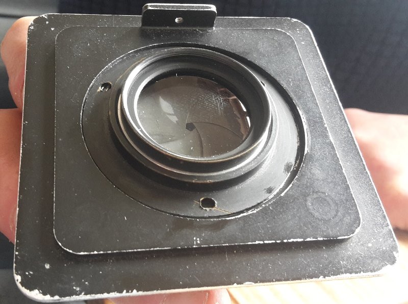

Thank you everyone :smile: I took the camera out yesterday to get a few lighthouse shots and it turned out not too bad just had to raise the blacks a bit in lightroom. So next time I'll try dropping the aperture a bit more :smile: Next problem I need to work out is how to remove the lens from the lens board guessing it requires a tool to do it, just don't want to break it then find someone over here that can give it a service.

Unscrew rear cell from shutter. This will reveal a retaining ring that has two pairs of opposed slots. Use a spanner to unscrew the retaining ring. Pull the shutter with front cell out of the board.
Look here http://www.skgrimes.com/products/spanner-wrench to see what a retaining ring and spanner look like.
shutterfinger
Feb 25, 2013
5,018
San Jose, Ca.
Someone has used a mount flange to attach the shutter to the lensboard. Put the spanner into two of the three holes and turn counterclockwise on the ring while turning the shutter counterclockwise as viewed from the front.
I see some scratches on the rear element, did you do that trying to remove the ring?
Unscrew the rear element by grasping the black ring around the lens element and turning counterclockwise, lay the element aside in a safe place to prevent further damage to the lens.

Thank you Shutterfinger, No I never used any tools I just tryed to give it a little twist with my hand. I'm guess that must of been done by one of the former owners, more like the one that managed to chew the head on one of the ground screen brackets. I'm more of a ask first than get the tools poked in kinda guy :smile:
