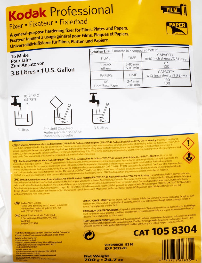

Waiting on the TF-4 from PF, but I got a package of Kodak Professional Fixer. "A general purpose hardening fixer for films, papers and plates." Who knows where it came from, I would not have bought it new, but in my experience the "hardening" part of kodak fixer came in a separate little envelope. This has no envelope attached, tho there appears to be a little spot near the bottom where the "hardening" packet may have been attached. May I assume this is NOT a hardening fixer, or did Kodak make fixer with the hardener already incorporated?
The other thing, I've been using TF-4/5 for so long now, always at "film strength," e.g. 1+3. This packet makes 3.8l, but gives no instruction for further dilution. So there is no stock vs working solution?
And one other thing. It says 2-4 minutes for RC papers, which is all I'll use it for, which for me is a hella long time. Anything wrong with making 1.9l, assuming I can get it all into solution? Again, this is just for RC proofs.

Hm, I recall loooong time ago buying kodak powdered fixer at a local store (ha ha, that is how long ago) and the guy told me to just throw that other little packet away. Actually, I don't plan on toning so i shouldn't care. How about the working vs stock solution? Does this package make 3.8l stock or working? Seems to assume it's working solution, but doesn't really say, and it doesn't say different dilutions for film vs paper.
"kodak fixer" is a "Regular" fixer, not a RAPID fixer. the time for RC ppaer is corect, allow 10 minutes for film. I would avoid this for T-max film.. this is the stuff many of us started with before the Rapid fixers came out. The Rapid fixers are all provided in liquid form. when they came out I know I was surpised how quickly they wqorked. we first got "May and Baker" and then Edwal QUIK-Fix. the edwal did come with a little bottle of hardener. The hardener is baked into Powder Kodak Fixer.

and yes, the package makes working stenth, and mixing it more concentrated will likely NOT speed it up. Sodium vs Ammonium.

Kodak packaged fixer is a "conventional, sodium-thiosulfate-based, hardening fixer. Fixing times are longer for this type of fixer than for rapid fixers.
Instructions for mixing and capacities should be on the package, so I don't really understand the questions. Maybe your package is illegible?
At any rate, you mix the powder to make a working solution, not a stock solution. Here's the instructions from the package (3.8-liter size) for your reading pleasure :smile:

Perhaps the poster has the older package, it one time came in a cardboard box, and the instuctions on that were not as detailed. ALways brings back memories of being the president of my High School Camaera club. Major duty was to Mix Fixer and Dektol. {Although the president the prvous year had got the club a deal on closeout "GAF Acid Fixer" Which was the functional equivalent.} The GAF stuff came in a metal can.
