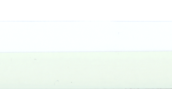

I've been printing quite a lot of RA4 in the darkroom over the past few years, relying mostly on Fuji Crystal Archive Supreme and also Kodak Endura papers. I use Fuji Hunt RA4 chemistry in trays at room temperature. I have also tried processing in a Jobo at official RA4 temperatures, but noted no appreciable difference in print quality, color rendition or the problem explained below, so I stuck with trays (which I find easier and less fussy).
One thing that has bothered me for quite some time and that I haven't been able to solve is the whites of the Kodak Endura paper I sometimes use when I need more saturated/rich colors than Fuji gives. The whites I get on Endura always are slightly off-white, with a sickly yellowish-green tint to them. I would describe it as a dirty lime color. It's slight and does not stand out if a print is viewed on its own, but once held next to a white piece of paper or compared directly to my prints on Fuji paper, the difference is very distinct and bothersome to me.
Things I have tried so far are:
* Developing the paper without exposing it whatsoever to see if it's somehow an optical fogging artifact. Turns out it isn't. Besides, prints on Fuji paper consistently come out perfectly fine.
* Sticking to RA4 specs in terms of development time and temperature, using a Jobo and drums. Didn't make a difference.
I have not tried Kodak chemistry as it's more difficult to get around here.
There are four possible causes I have been able to come up so far:
1: The Kodak paper I use was bought from a reseller in Germany who cut it to sheets from rolls. In this process, some kind of fogging (light or chemical) may have been induced.
2: The paper may be past its use-by date and fogged due to old age.
3: There might be a compatibility problem between the Kodak paper and Fuji RA4 developer. However, I have tried developing the paper in a DIY RA4 developer (made from dry chemicals; i.e. TEA, CD3, carbonate etc.) and the problem persisted.
4: A final possibility is that Fuji paper imparts chemicals to the developer it is developed in, which consequently fog Kodak paper. I would not have thought of this myself, if it weren't for problems with a pack of Mitsubishi paper I acquired a few months ago exhibiting similar problems (although much more severe). I put this down to the paper being fogged due to age, but the seller insists the paper is fresh, fine, and used by many other customers (including professional labs) and that the problem is in the Fuji paper effectively messing up the developer. I find this hypothesis somewhat far-fetched, but who knows?
Has anyone else encountered this problem with Kodak Endura?
Edit: I've tried to capture it in a scan, but that's naturally always a bit deceptive. However, the image below approximates the hue of the fog fairly well. Top layer is the white pressure plate of the scanner, the middle layer is the white of Fuji Crystal Archive Supreme Lustre (which is sometimes a tad cool depending on lighting, but not as blue in person as it is displayed below) and the bottom layer is the 'white' of the Kodak Endura paper (F surface in this case, but I get more or less the same with a pack of N-surface I have lying around). Note that the effect is somewhat exaggerated in this image, but it is very apparent nonetheless in the real print.
Edit 2: I have printed on very old Fuji Crystal Archive (non-Supreme, original/old version) which was fogged by age, but this paper fogged to a cream yellow and not to the greenish tint described above. Then again, I can imagine every paper will fog somewhat differently depending on how the various color layers age.
