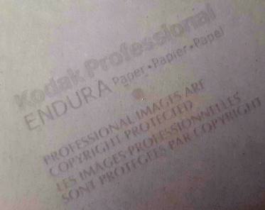

I have never cut from a roll before and it looks like I fogged the paper. I did cut the paper using a Thomas safelight with new color filters installed and the flaps closed. I could barely see. Here's my results. Endura on the left Fuji CA on the right. I printed the Fuji with the same settings as the Eundura. Does anyone know if this is the correct back printing for Endura? The Endura is flipped because the edge was less fogged/blue.
It's different from the Endura back print I'm familiar with:
Note not only the different text, but also the different ink color. I'd have to root around for some prints on Kodak Royal paper that I must have somewhere, but as I recall, the back print on that paper explicitly stated the 'Royal' moniker. I don't remember what color the back print was on that paper.
I don't believe Kodak Endura ever came with a 'digital paper' back print. At least not the Kodak/Carestream-produced Endura.
I find it a little hard to tell what's going on exactly. On the left hand print, I see some cyan fog around the edges that is consistent with orange safelight fogging. My experience is that by the time you have this amount of fog on the white borders, the color balance of the image itself has shifted substantially and natural color reproduction is no longer possible. The difference with a properly made (unfogged) print will be very significant, even if you adjust the filter pack to compensate as far as possible for the fogging.
On the right-hand print, I don't know if the magenta gradient on the white borders is an artefact of the digital photograph or if it's really on the paper. If you have magenta 'fogging' going on, it's weird for sure and not related to your safelight. But I suspect it's just a white balance issue on the digital photo.
Fuji's papers are generally somewhat faster and therefore fog more easily than Kodak Endura.
