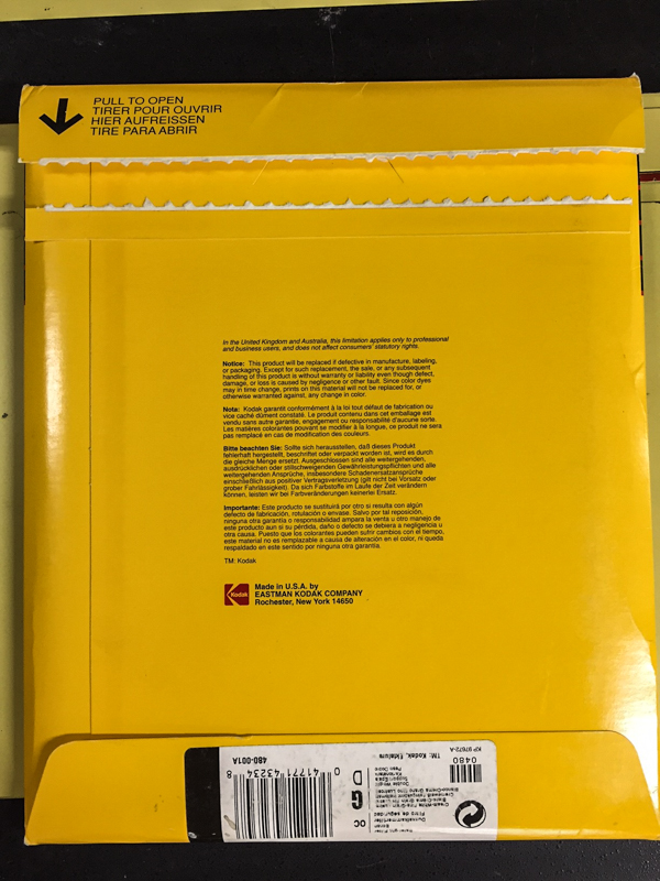

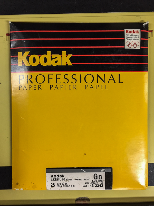

It's a G surface. Reasonably modern Kodak packaging, there is a logo on it that says "official imaging sponsor of the Olymipc Games". Doesn't say any particular games.
Jul 31, 2012
3,295
I'm guessing that would be one of the games that the US hosted.

... modern Kodak packaging, there is a logo on it that says "official imaging sponsor of the Olymipc Games". Doesn't say any particular games.
Interesting comments about end game Ektalure runs.
Humor me... I am one of these shooters old enough to have bought products new then, I remember Kodak putting Olympic stamp on products around the time leading up to the 1980 Lake Placid, NY Olympics. In that event, the 1979 data sheet I posed would be period correct. Kodak's big into Olympics but markings on B&W paper like Ektalure might be a one time event.

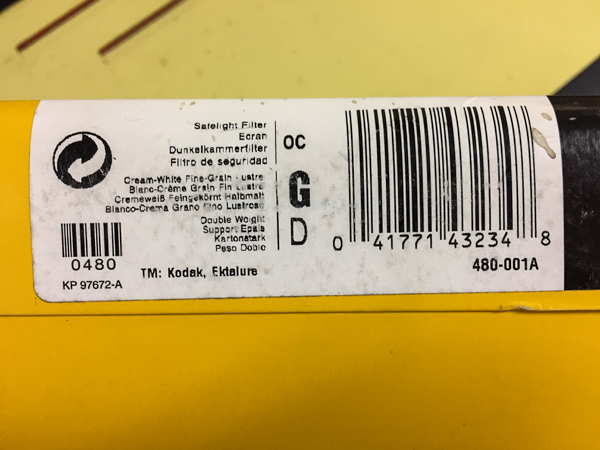

Craig in Alberta, could you post a picture or two of the package when you have a moment? Close up of the Ektalure label on front and back of the paper ?
kreeger
Jun 21, 2009
207
Missouri
From what I know, that packages is from the 90s somewhere. Too new to be Lake Placid Olympic era.
Kodak discontinued it all together in 1999 along with a handful of other papers due to formulas not kosher with the EPA. G surface was gone before 1999.
