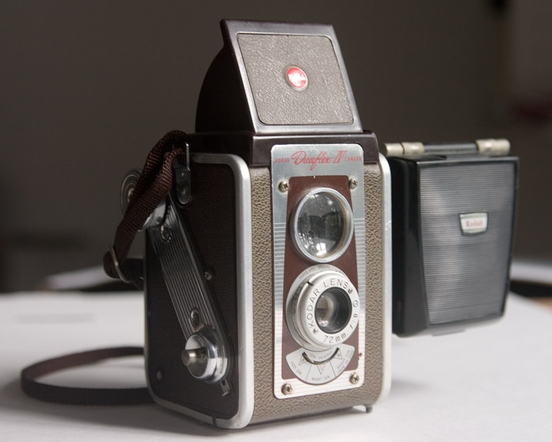

i've just picked up some 620 film for my grandfather's old Duraflex IV.
The lens offers f/8, f/11, and f/16.
Any sense on the shutter speeds?

Hey Paul - I have a Kodak Duaflex II and I love it. I keep with the sunny 16 rule, and that seems to work out with me. In fact, I don't have a light meter (I know!) so I generally do all my shutter speeds in my head according to the light.
You also don't actually need 620 film - just respool some 120 onto those lovely metal spools and it'll fit perfectly.
Hope that helps!

Thanks for the thoughts! I needed to get the film in order to have some spools!
Sunny 16 sounds good, except that I don't know how fast the shutter is -- maybe I'm just missing something.
Glad to hear you love your duraflex! I'm really looking forward to playing with mine.

Oh sorry Paul - I had replied before I finished my coffee that morning :wink:. Yes, the kodak cameras are generally around 1/30.
