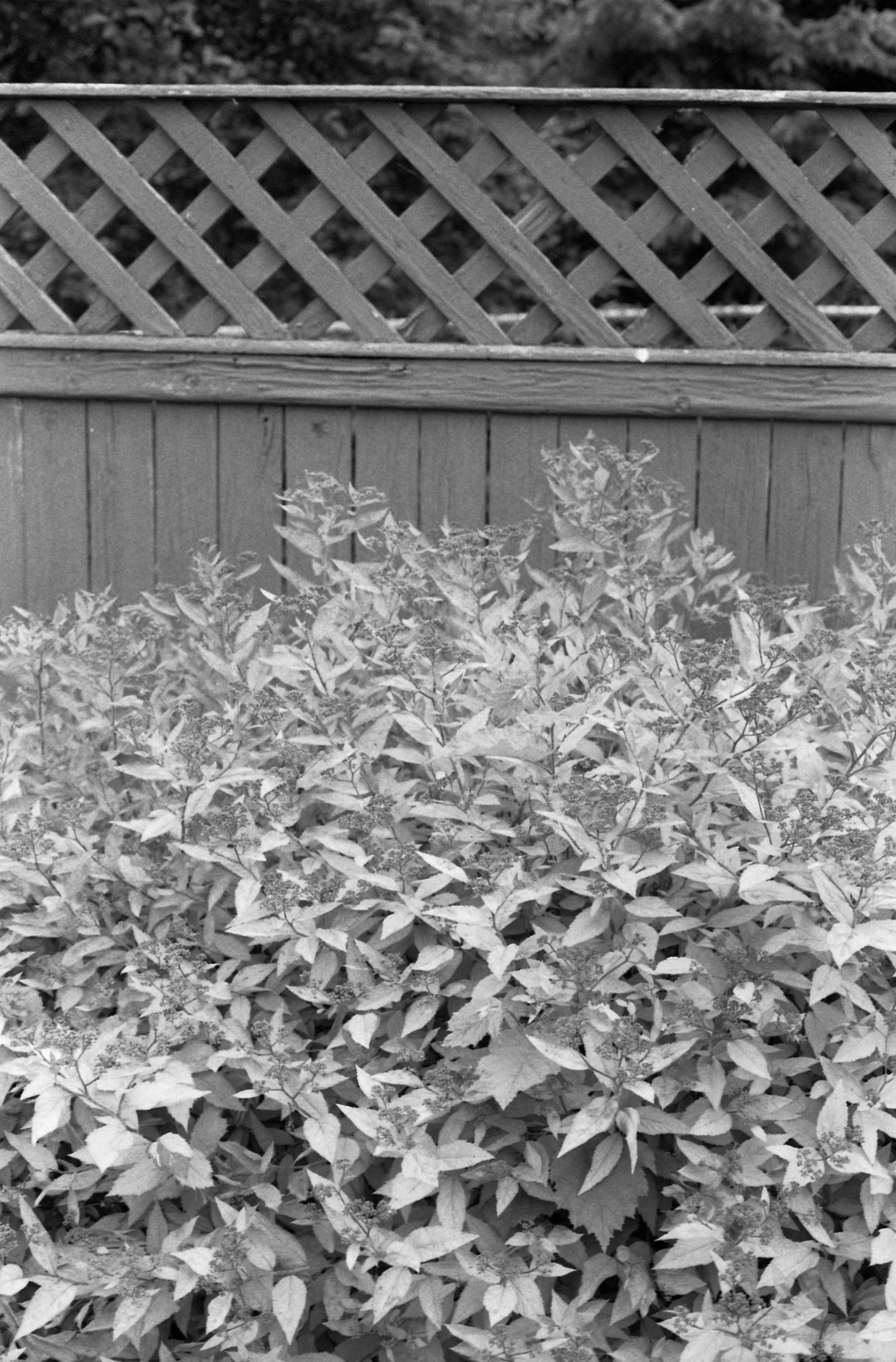

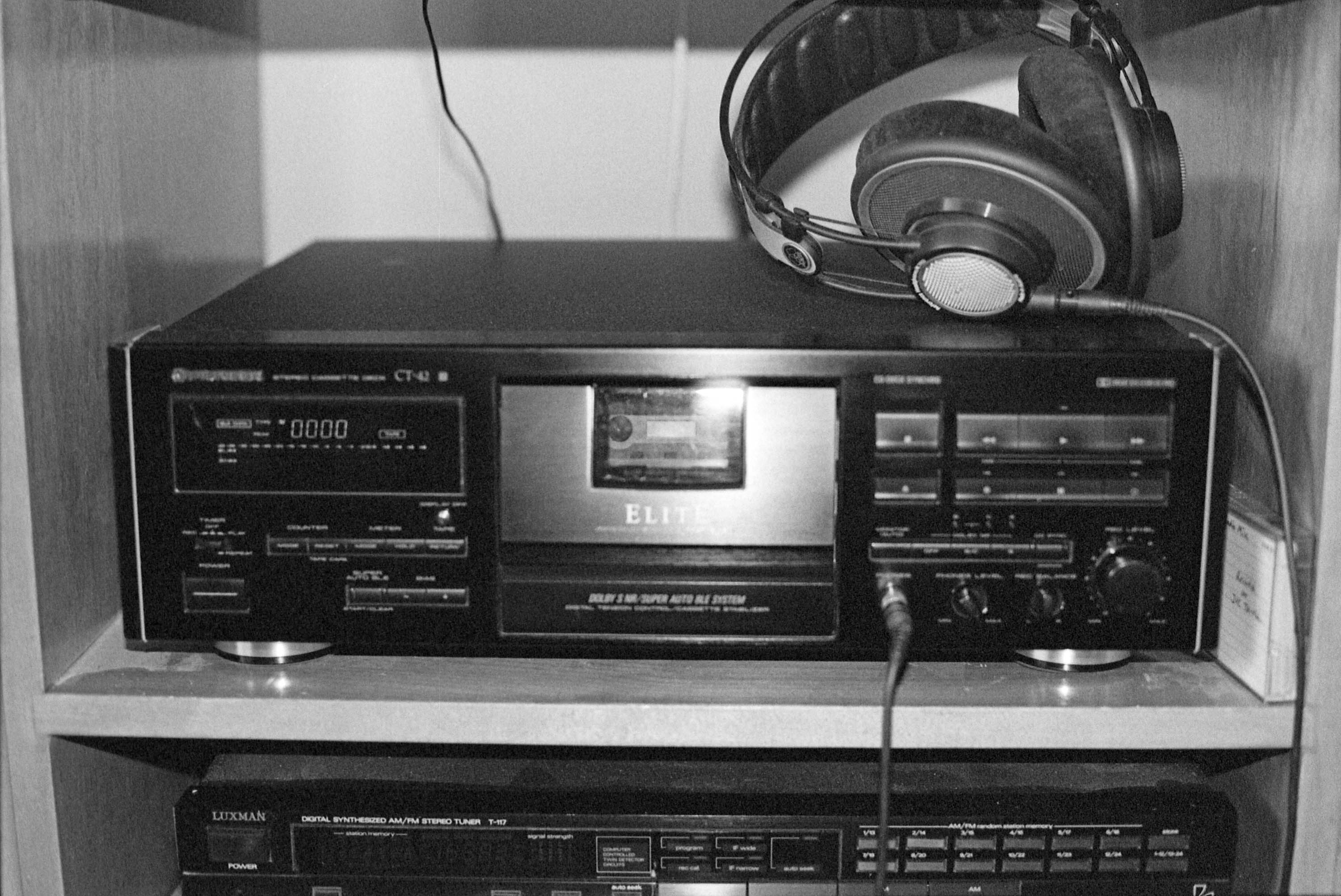

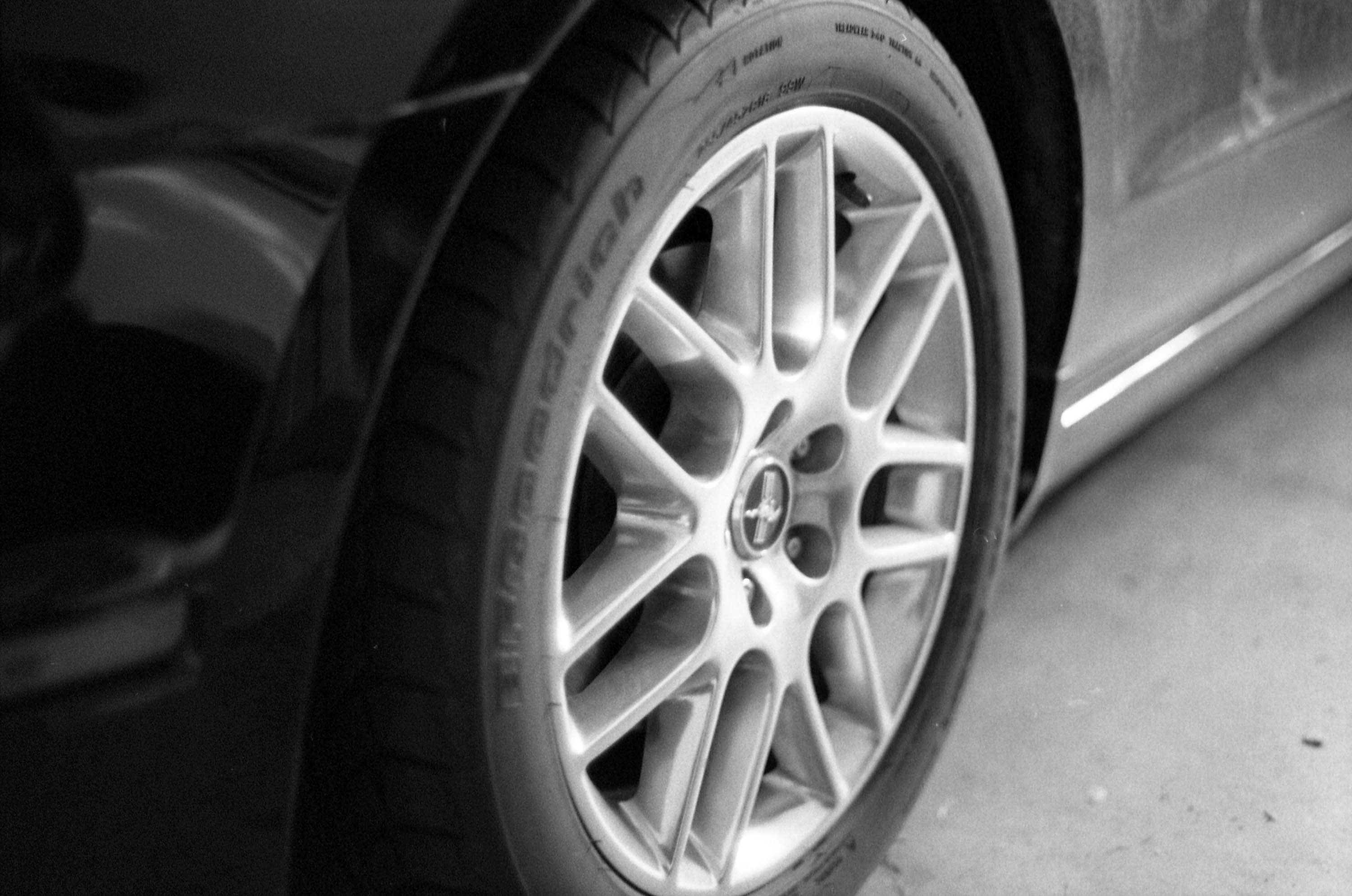

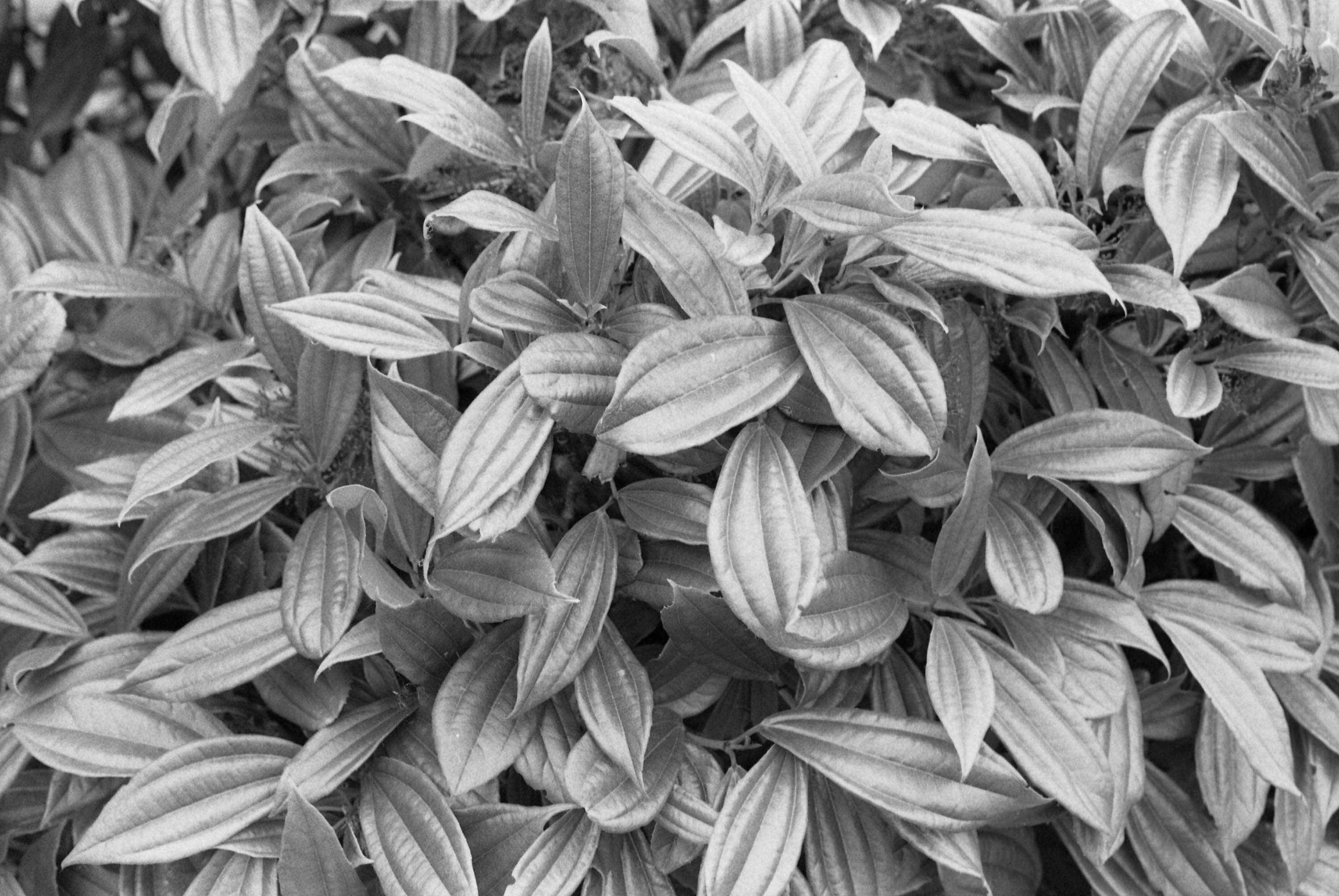

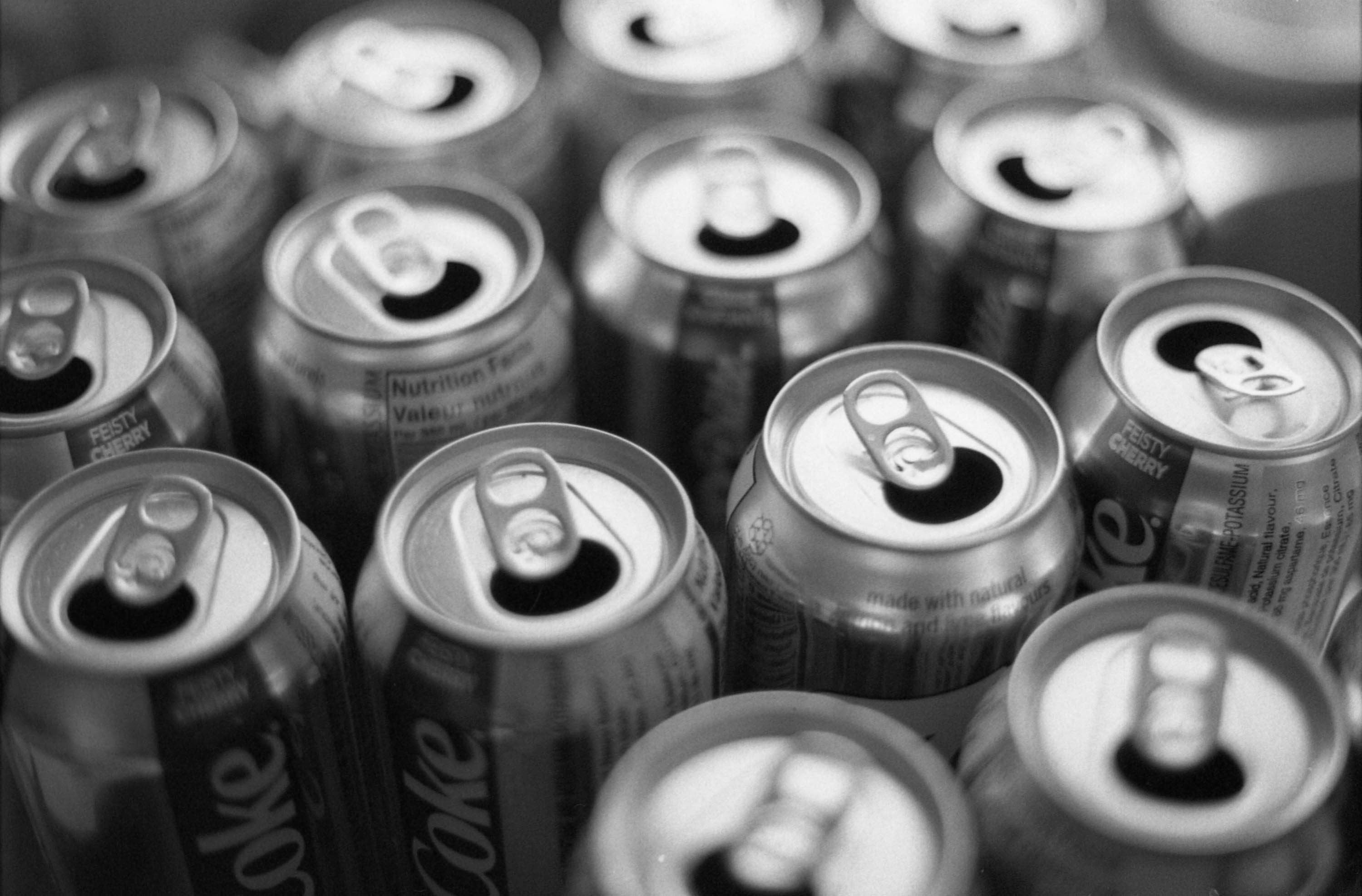

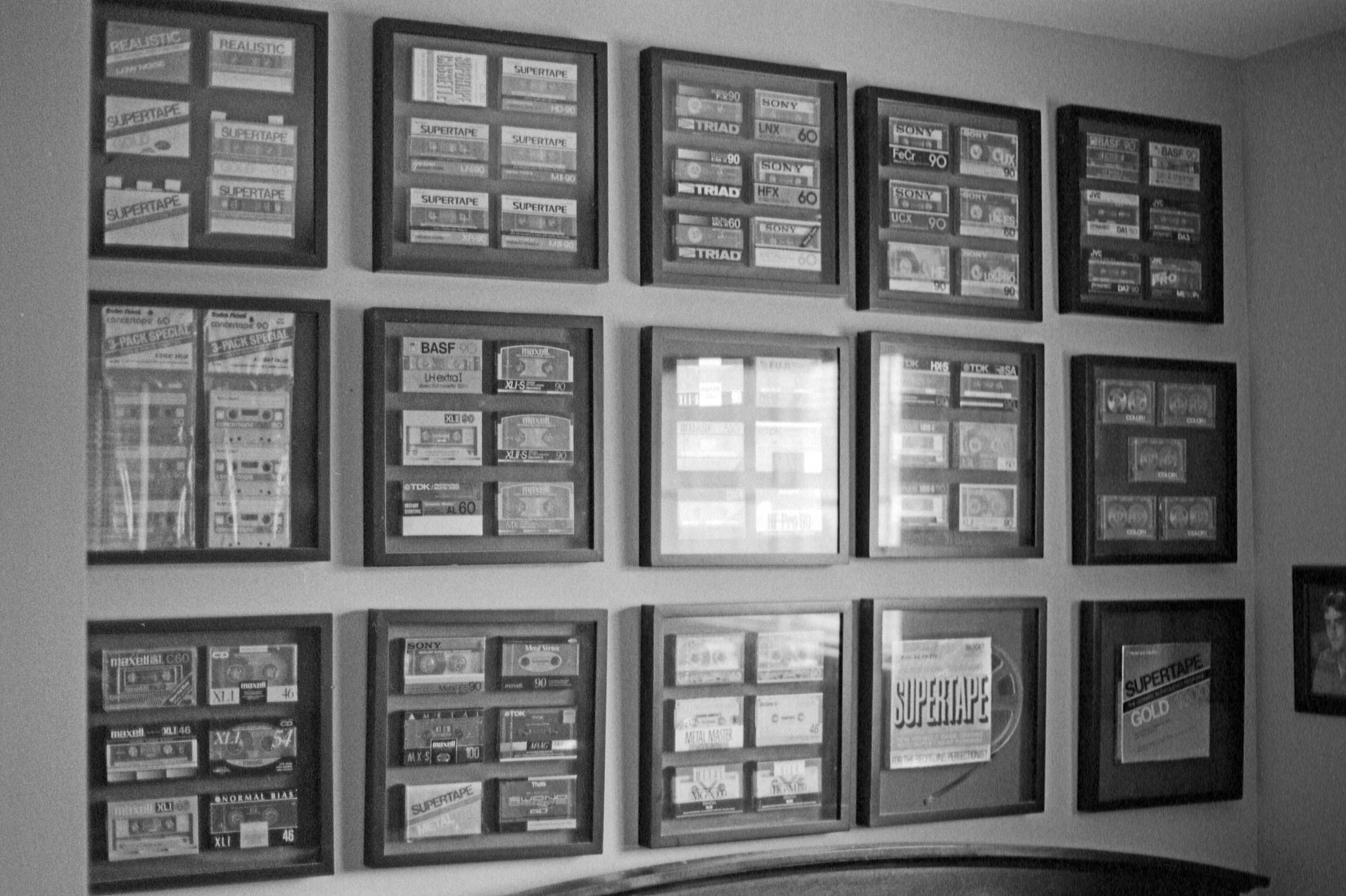

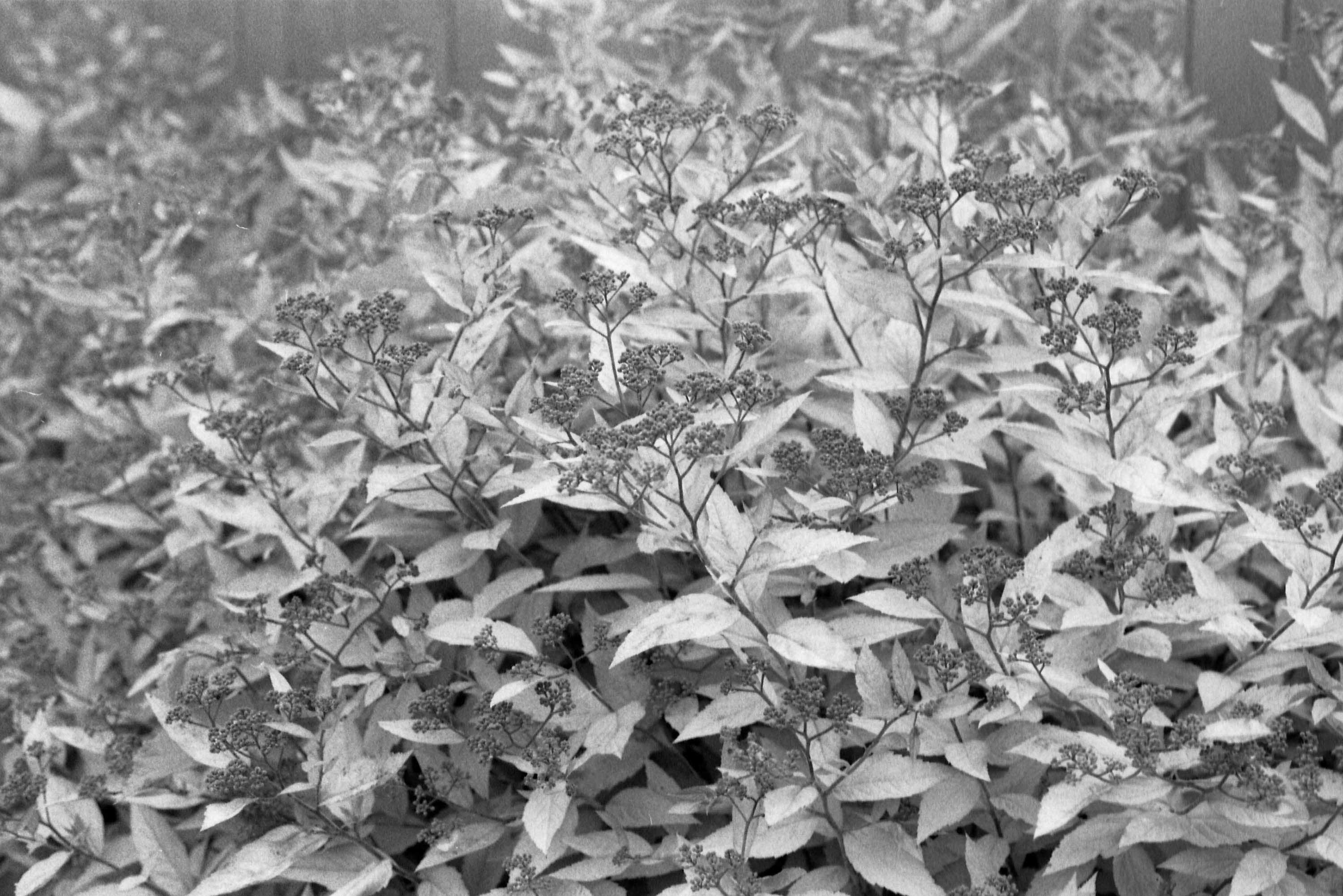

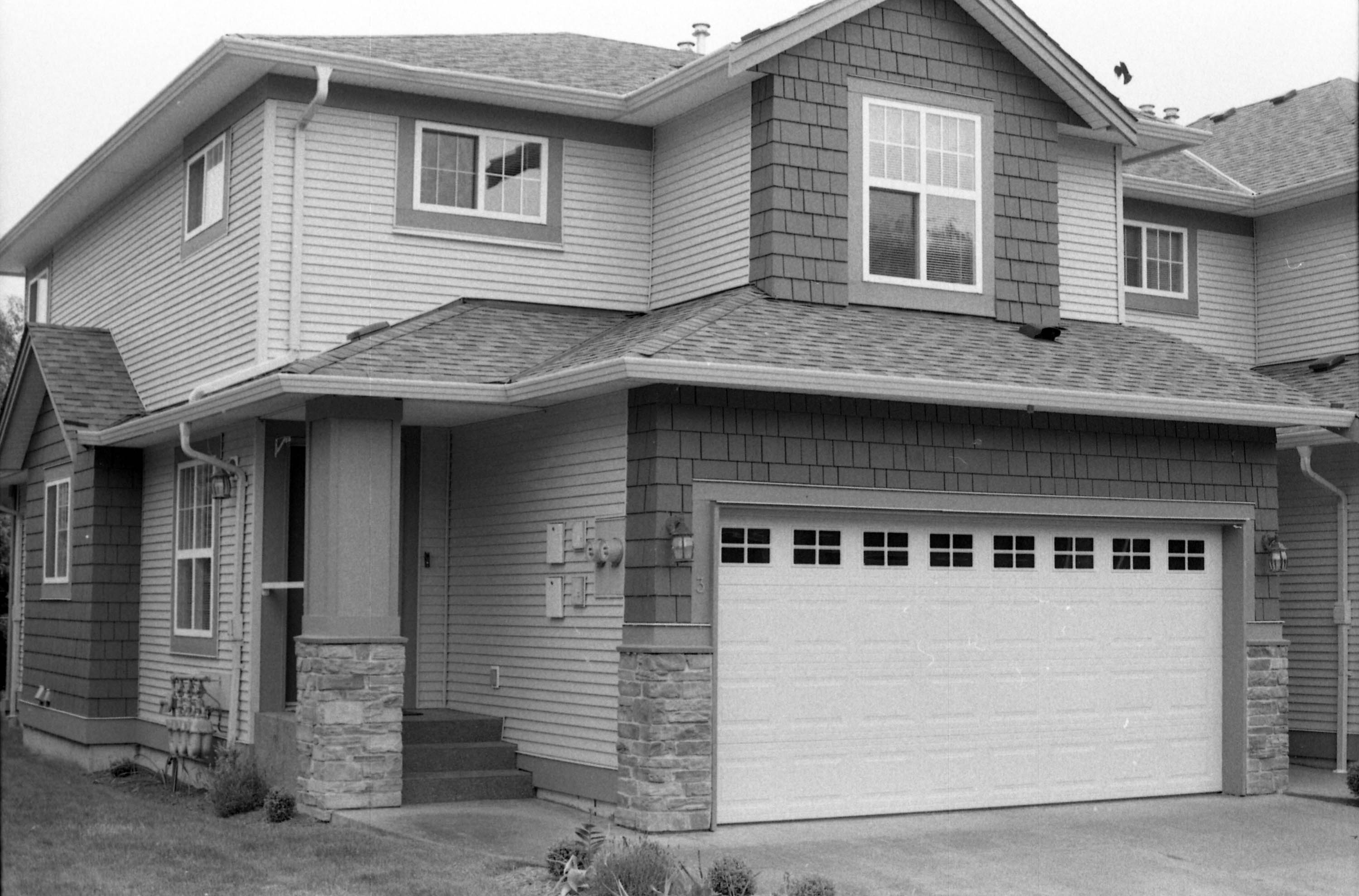

I loaded up my only 35mm roll (its really old, but kept frozen) and Im shooting it at 160 ISO. Some stuff around the house and complex. I'll take some more shots later. I'll try this roll in 1:1 Xtol at 9 minutes.
Done developing the roll. There is some fog, but the neg looks quite dense, so I think 9 minutes was too long. I'll see about some scans later.
Scans turned out with the kind of contrast that I find workable. Not too much (other then the odd blown highlights). Here are the pics. I wonder if the negs needed more fixing, as the emulsion side wasn't as clear as it should be. I fixed for 9 minutes.
Sorry for the soft scans. I used my flatbed which isn't the best for 35mm.

Nice cassette deck and tape collection. I have the similar Pioneer CT-910, but it needs new belts.
