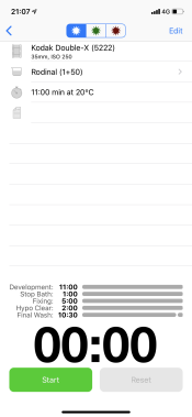

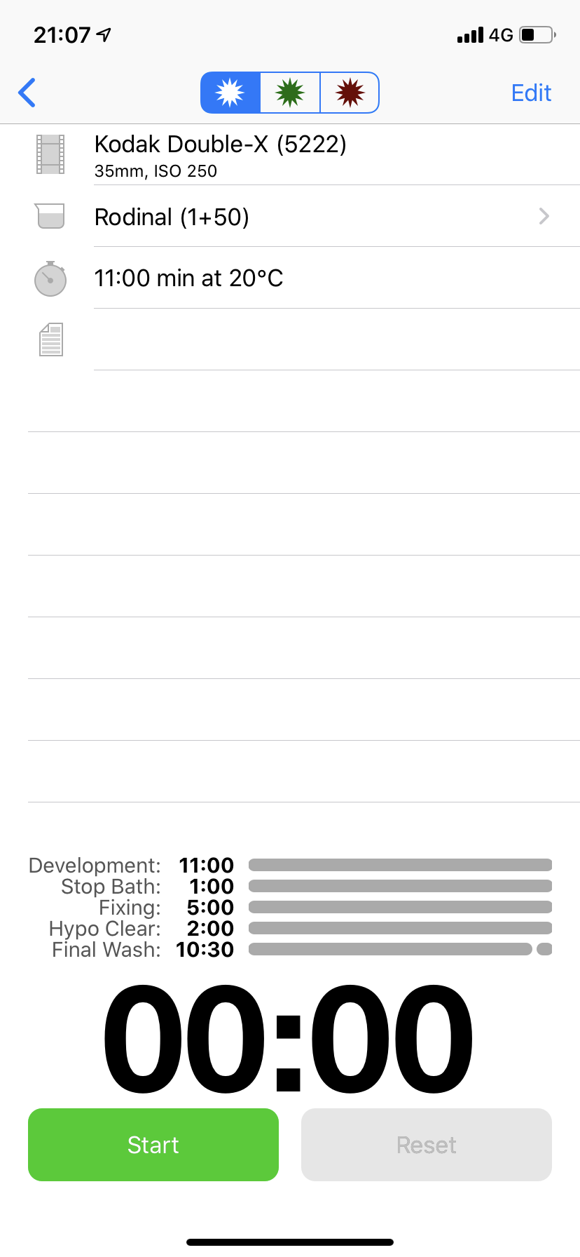

Here is mine. im really happy with the result
