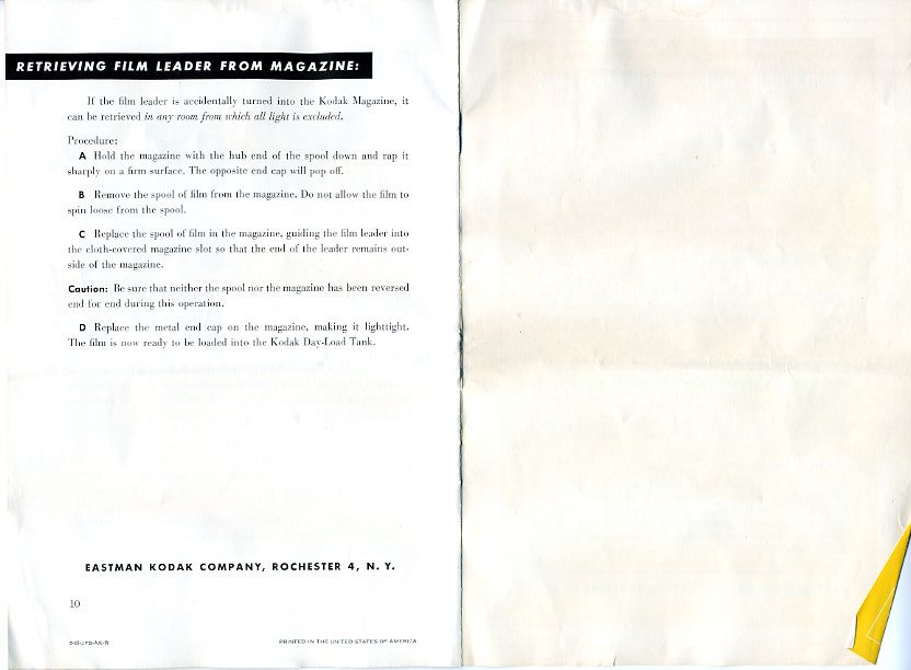

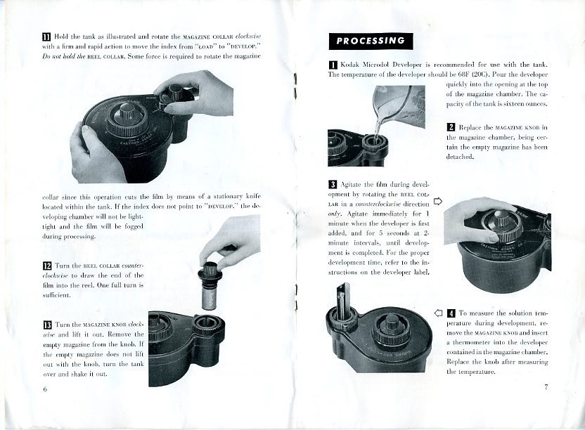

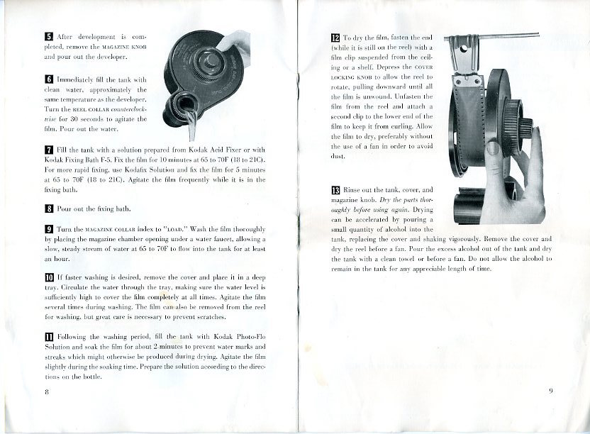

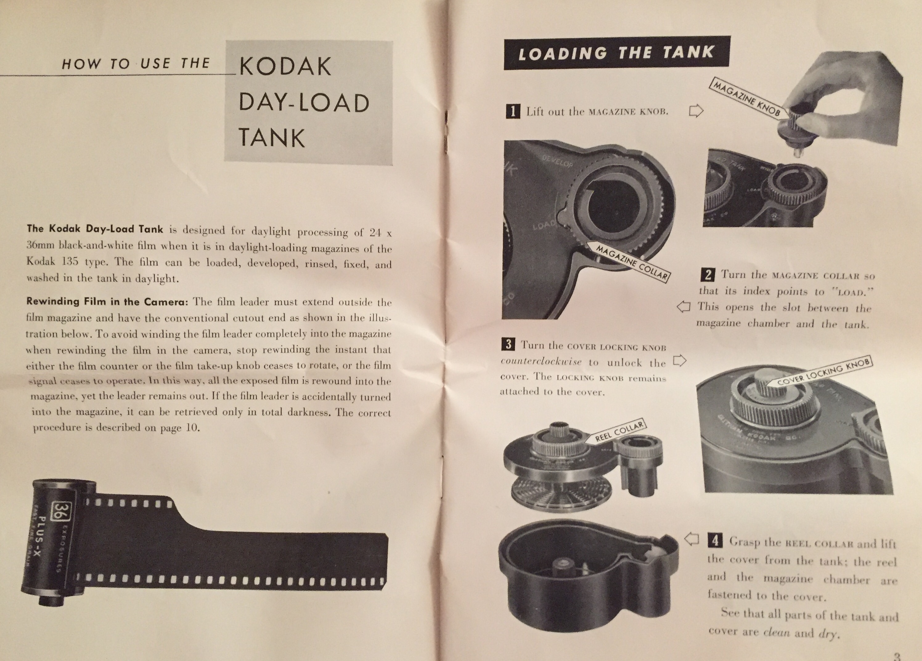

Hello friends,
recently I have acquired an old day-load 35mm developing tank by Kodak, apparently a nice gift from 1950s, made of bakelite. It has a cassette compartment with a knife, and a two-spiral reel - looks like some kind of odd bulk film loader. It is exactly the same model as (http://cgi.ebay.com/ws/eBayISAPI.dll?ViewItem&category=29993&item=3870017015&rd=1&ssPageName=WDVW) The question is simple - how on earth should I operate this machine? :smile: I can understand how the film should go there, and how to cut the film and pour in the reagents - but the film end obviously needs to be cut in SOME SPECIAL way, apparently! Does anyone know how to do it with such a thing?

Very nice answer. But you do not answer my question. How do we use this Kodak Day-Load Tank. You answer that it is difficult to handle but you do not tell how to use it, this Kodak Day-Load Tank.
Do not repeat it is hard to handle.
Explain how a normal human being have to do to use it.
Do not tell me once more that handling is not easy.
I am asking how to use it. I have a darkroom in my house.

Jaques, your post is very puzzling...
You address a member who made that post over 15years ago and who likely has not been here for months, as if he replied to you.
Furthermore you find the answer to your quest just in the post above yours.
