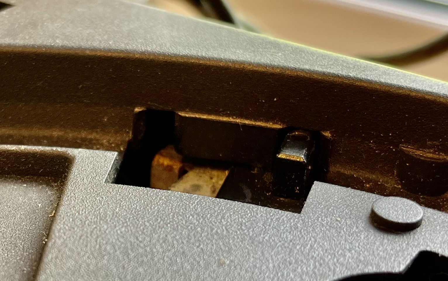

Hello all, first post😀. I have been sorting our historic family slides and bought a Carousel. It was in great working order until a plastic slide fell apart and jammed the gate. I had forgotten from years gone by how to remove the tray in any non-zero position and extracted the slide in bits!
Sorting resumed. After about 60 slides the transport failed - neither advancing nor reversing.
I found a video on the forum which incidentally showed how the transport should work - and mine doesn’t. The image blow shows the peg which doesn't move.
I have had the case off and admired the German engineering but can’t see how the mechanism should work.
Can anyone offer a fix or a steer to find out more please. Is the a service manual available?
Thanks in advance for any advice or pointers you can offer. I can’t face sorting 3000 slides by holding them up to a light!

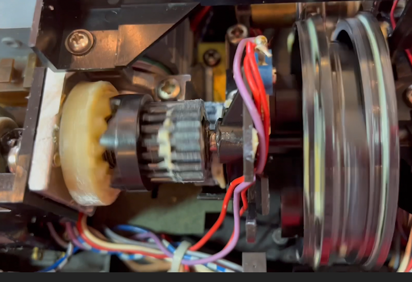

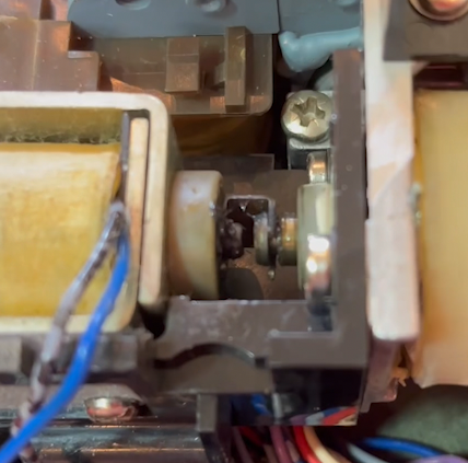

The shaft which ultimately drives the two cam wheels when activated by the solenoid (left) should be lubricated allowing the wheels to rotate freely on the shaft.
and...the shaft upon which the pinions slide also should br lubricated. It is exposed when the clutch (nylon colour) is engaged. I cleaned the cam wheels and lubricated them.
There was not much dry grease but lubricating the shafts has made everything run more smoothly. It also fixed my problem with the magazine/reverse - how the advance/reverse motion works is still a mystery.
