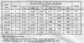

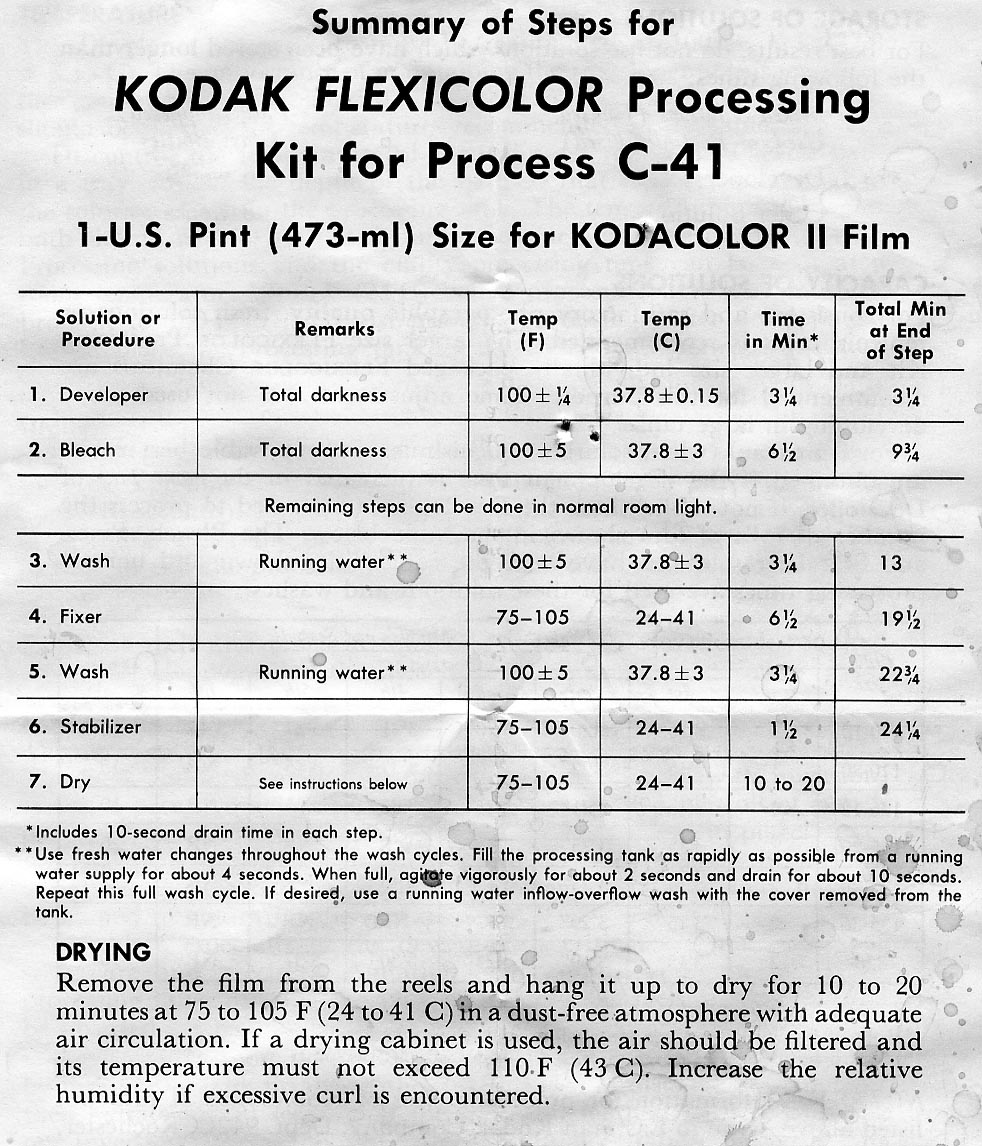

Well, it is probably 5 rolls per liter of 35mm without time adjustment as it says here: http://www.kodak.com/global/plugins/acrobat/en/service/Zmanuals/z131_03.pdf
However, my sheet gives time adjustments so here it is. I have two sheets that differ slightly. This one is a bit more conservative. I would be even more conservative.
Enjoy. These are official unreplenished values for tank and tube. I have used these since the 70s.
PE
