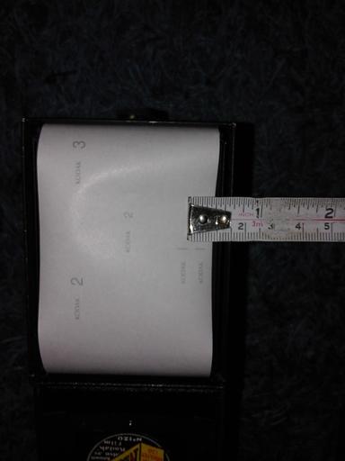

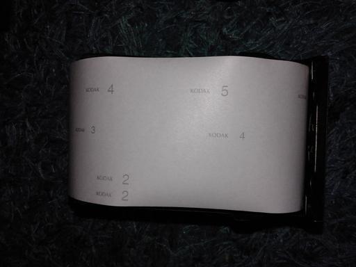

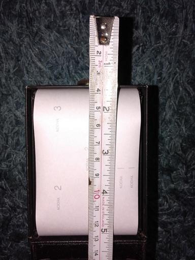

Hello ,
Following the instructions from both the manual and a Youtube vid I find that the numbers do not line up with the red window. As I have wrecked the first film I have taken measurements with the window being 20mm in from the edge of the camera and the film counter (on the film at 15mm ,the two do not line up so I have no idea where the film is. The film is Kodak Ektar 100.The film numbering also seems odd as can be seen in the one pic looking from left to right I have the number 4 ,3 just in front (in the direction of travel) in the middle then 2 to the right (which one should I be reading ?) Hope that makes sense any help appreciated.Sorry the photos maybe out of sync with the text I hope they make sense ! The one with the tape measure running top to bottom shows the line of where the glass window is compared to the numbers.
Am I making a really stupid mistake ?

do you have film that isn't kodak layng around ?
maybe something you already exposed and developed and you still have the paper with the # on it ?
ilford? fuji? ado? efke? foam? &c?
i ask because over the last couple of years, kodak has had troubles with the numbers &c backing paper somehow
transferring to the negatives and they had to change the backing paper / how things were numbered.
there are a handful of threads about it.
you might just have to use a different brand of film ... OR use expired film from before
they had the trouble ( within the last 2 years )

The 1952 ASA specifications for 120 film show the window for 6x9 cameras as being 20mm from the edge of the edge as you have measured on the camera. Therefore it would appear that the problem is in the film.

Rewind your ruined roll and try reloading. the numbers close to the tip of your tape measure are the ones you should see. the multiple numbers are for cameras which shoot a different sized negative. 6x6, 6x9 etc. Watch the video while you do it. Stopping the video, do what you just watched etc...

I just looked at the backing paper off several 120 films from Kodak, Fuji and Ilford, no Ektar though.
All of the show 3 numbers for the 6x9 series where you show # 2 in you first photo. In other words where your tape is shows 111, 222, 333 etc instead of 11, 22, 33 like on the film you show. The 3rd number on mine is 20mm from the edge whereas the 2nd number is 15mm. Interestingly the only 6x9 box camera I have lying around is a Zeus Ikon and the red window on it is 15mm from the edge.

don't be too hard on yourself
a lot of people didn't know that
their backing paper is wonky...
its only been within the last year
they switched papers ... before that
you would not have had trouble with the #'s
but you'd be posting " there are words or numbers
all over my negatives is there something wrong with
my film?"
btw you can still use your kodak film
you just have to attach it to a different backing paper
which is a very easy thing to do ... you take the new/used backing paper
and figure out where the tape is ( or if you removed it .. was )
and in the dark you peel the film out of the old kodak roll and roll it on the new roll ...
and then rewind it back onto another spindle so you put it in your camera with #1 at #1 instead of the end.
people who use 620 spools do part of this dance all the time .. they respell ... the repapering is just as ez.

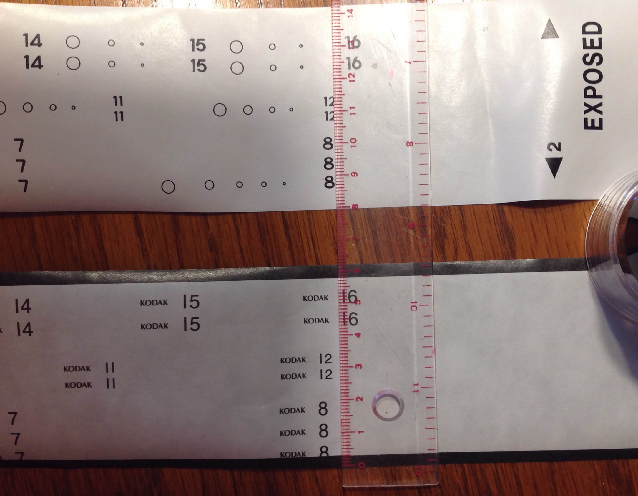

Interestingly enough, your camera was the very first camera to ever be made for the then new film designated as "120" film.
As I understand it, after Kodak removed a bunch of the numbers from the backing paper to deal with the problems they were encountering, they did end up having to add back at least one row, due to users having the problem you are having. What is the "develop before" date on your film? There is at least a possibility that the backing paper you have has since been updated for the better.

You may find with Ilford backing paper that while there may be a row of numbers that lines up with the window, that you will unfortunately have great difficulty actually seeing them through the red window.
Ilford had their problems with wrapper offset earlier than Kodak did, and as a result they switched to much fainter and hard to read numbers several years before Kodak was forced to do so. When Ilford made that switch, many with red window cameras switched to other brands of film.

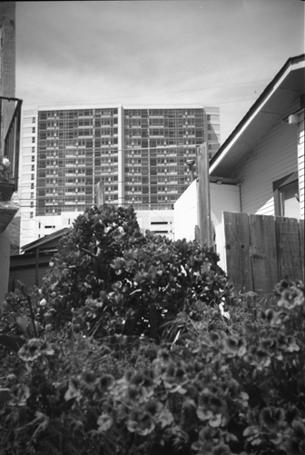

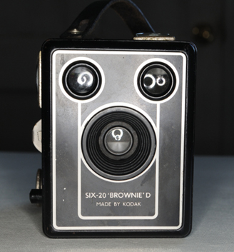

I have this Six-20 Brownie D on ebay.
That I fully disassembled, cleaned, lubed, reassembled and tested with a roll of Arista EDU Ultra 400 (Foma rebadged?) and a roll of Ilford Delta 100 .
The Arista was a light leak test that passed but my judgeing close distances with the portrait lens engaged and the 1/45 fixed shutter speed in my shaky hands is not presentable but this shot off the Ilford is.
Scanned on a V700 at 1200 dpi and reduced to fit here with no software enhancements by the scan software of post processing.
Backing paper numbers lined up center of the ruby window and spacing is near perfect stopping with the number centered in the ruby window. I have some of that green box fudge stuff that came Across the Pacific and I expect its backing paper numbering to line up perfectly also.
Yes, I respooled 120 film to use in this and other Six-20 cameras that I have and will dispose of in the near future. Vigilant 620 loaded at the moment, Tourist to follow and if I'm lucky a Billy Record.
