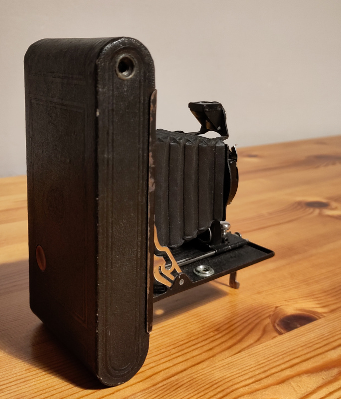

I'm afraid Andreas inspired me, and my ADHD is a bit unleashed nowadays... As I had some time today I had a first look at a camera I bought because it looked cool and was somewhat cheap (I think I paid €10 for it, and it looks clean enough)
The beast is a Folding that runs on 120film (it had a roll in it, some Verichrome Pan that's so old the paper is crumbling. I may try to sell if some collector wants to pay big money for it.)
Current known issues are that I'm unable to unfold the bellows, the shutter is a bit lazy and the lens foggy.

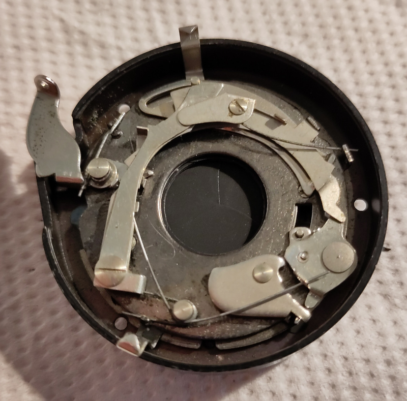

Today's work has been removing the shutter and lens, for cleanup and diagnostic. (And this is the moment I realize I have no images of the camera before I started working on it, sorry for this!)
Removing the shutter only needs a spanner wrench to remove the retaining ring from inside. The shutter is a tiny thing, and the lens is even smaller

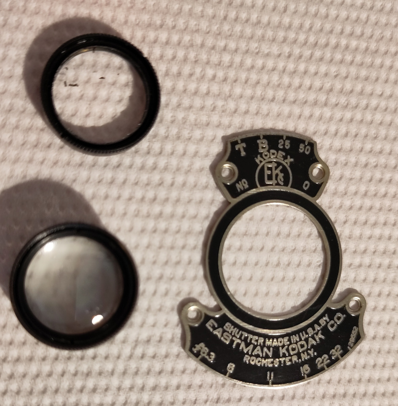

The name plate and the lens spent 15 minutes in the ultrasonic cleaner with a solution sold as a "metal degreaser", which is a soapy stuff and not too aggressive. This gives pretty good results on small parts.

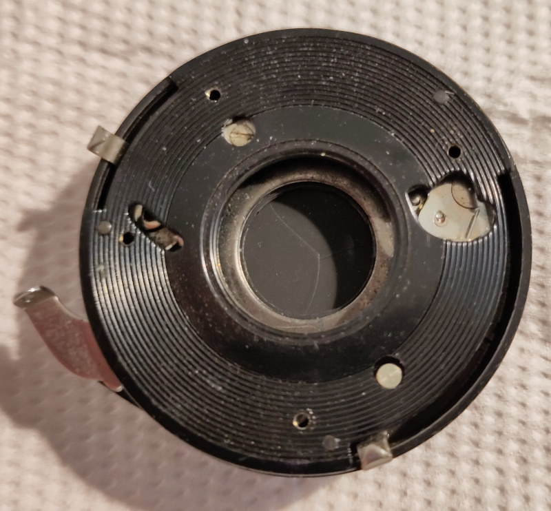

Three slotted screws (already removed) retain the lens back plate.

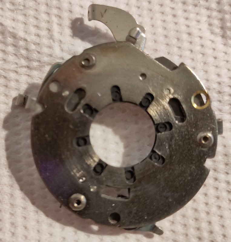

The shutter appears when the plate is removed, and looks clean enough.

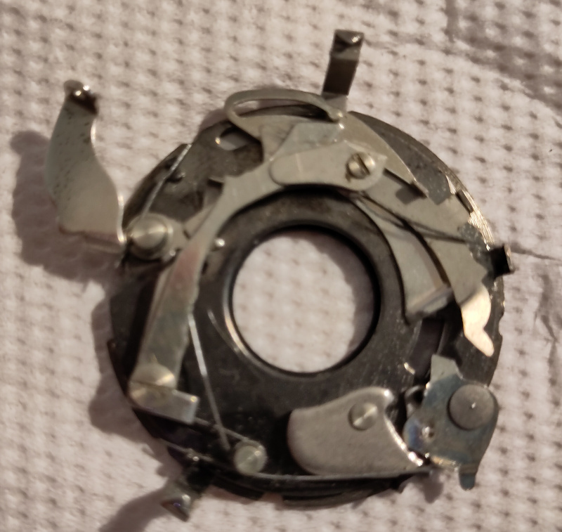

The shutter is held in its "carter" (not sure of the name) by three small slotted screws.
A first reassembly seemed to improve the operations, but at the moment it's still a bit random.
Proper reassembly is a bit tricky, I'll detail this in another post when I have more energy.

I lubricated the shutter a tiny bit and it seems more cooperative. It also seems fiddly and picky: if you want 1/25, you have to go full path to 1/50, then back to 1/25 otherwise you're using Bulb. Since this is not an action camera it should do the trick.

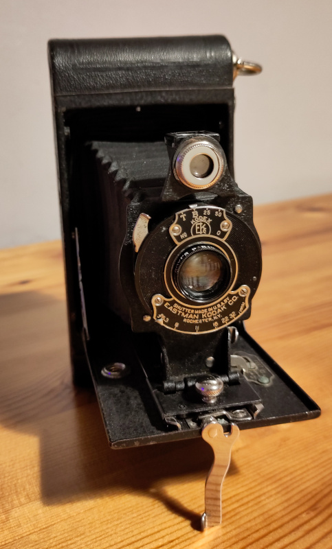

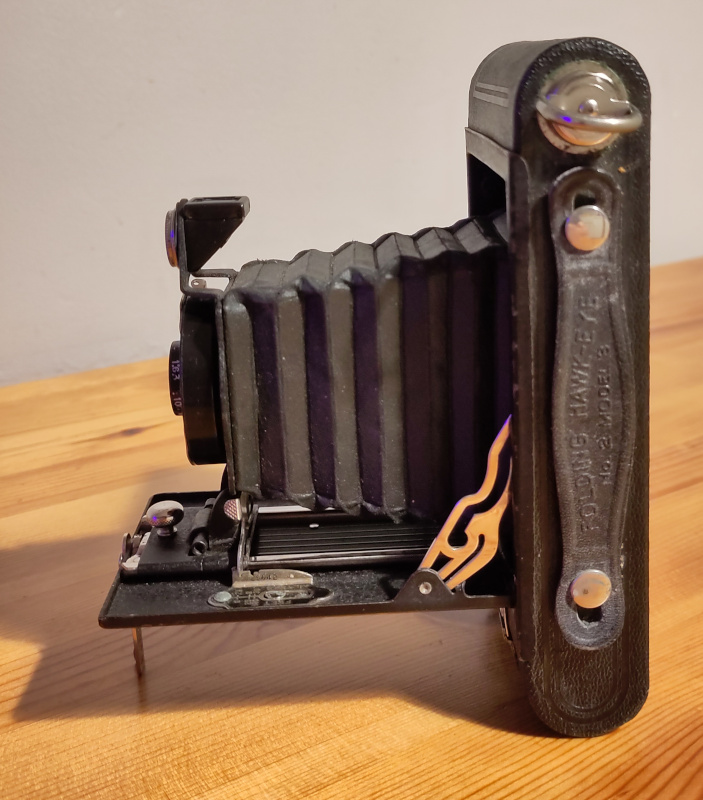

I did not resist the opportunity to make some photographs of the camera...

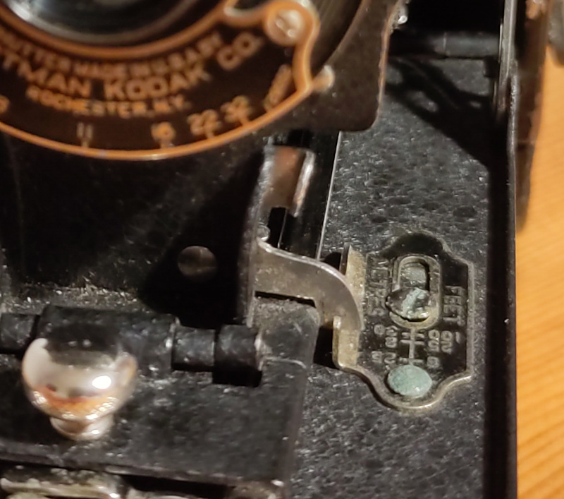

I like the way the camera is focused, by moving the front standard to an index which can be adjusted:
