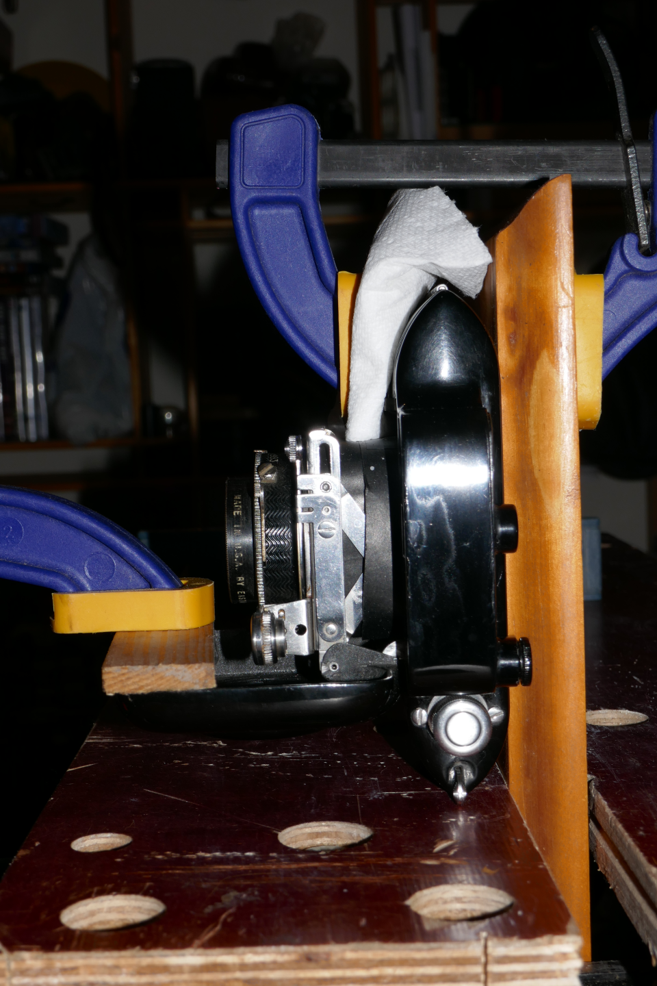

An update on my own issues with the "bent" KBS I mentioned above: I have reset the 90 degree door angle by clamping the camera to a plumb vertical board and using another clamp to slowly (over the course of several days) return the door to its correct position. Obviously this puts strain on the hinges and riveted connection points to the struts and lens board, but I was determined to shoot with it and try to reverse the damage done previously. l was fortunate in having an optical datum - the rangefinder had been doused with copious amounts of lacquer (externally and internally!) when set during an earlier service so I could believe there had been no movement and used it for the "infinity" position. This agreed with a collimated lens test and film test (bellows wrapped in black paper - negatives viewed by 10x loupe) - so I'm fairly happy. A better method would be to dismantle the camera and use a jig whilst heating hinge points - but I bet this would damage the finish. Only time will tell whether the open position will "drift" again. Bellows replacement hopefully will be soon. By the way, the famous enamel coating is not fired enamel, it is paint, and it softens in acetone (used to remove excess lacquer) - so I advise care with this solvent around this camera!! P1000144_960.png
