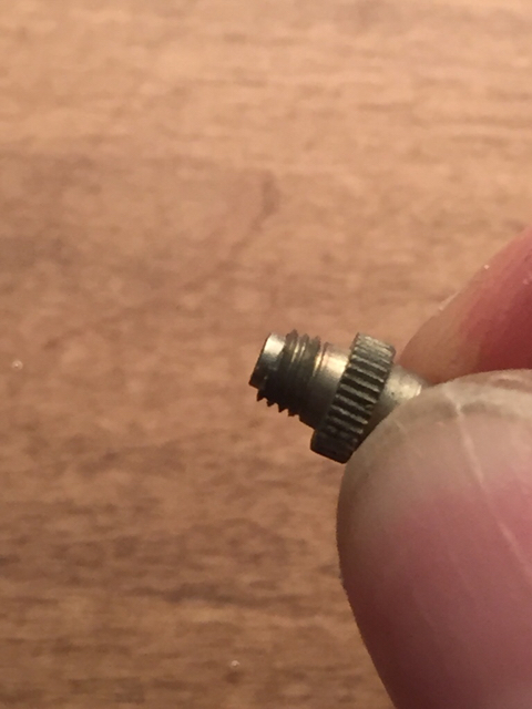

It may take the old straight thread cable release with a 5-44 thread instead of the larger now popular tapered thread with 50 threads per inch.

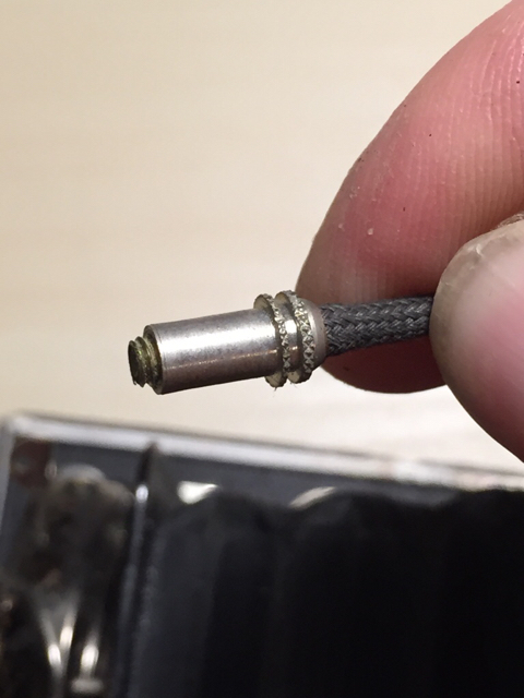

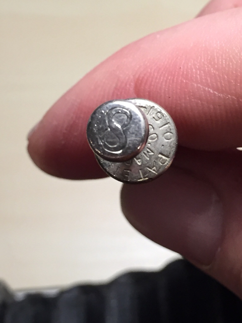

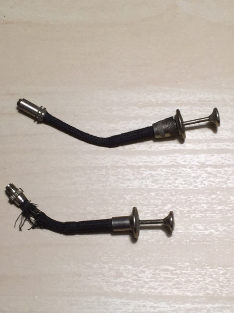

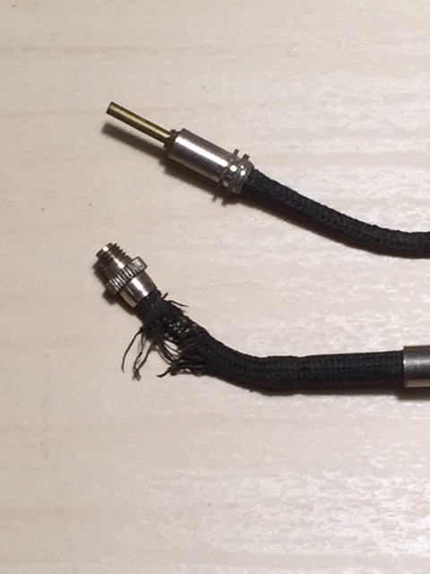

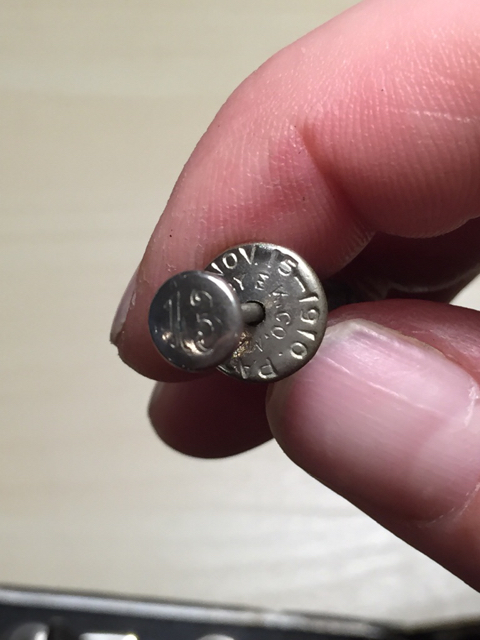

Ok I wasn't really in my darkroom all this time, but here are some photos of the shutter release that came with a couple of No. 1 Autographics that I own.
Looks like a couple different styles. One has an "8" and the other has a "13"

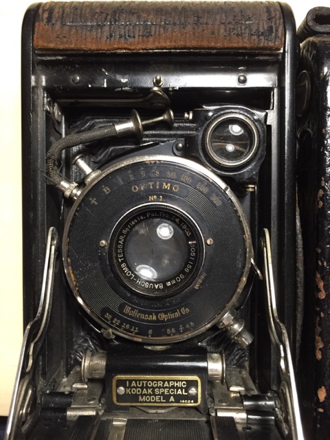

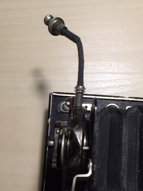

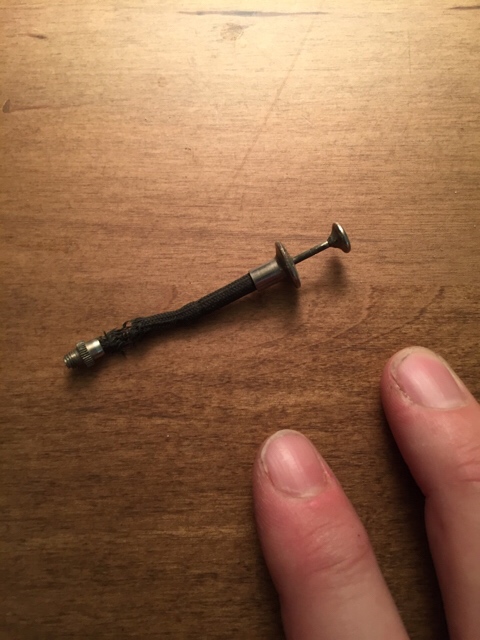

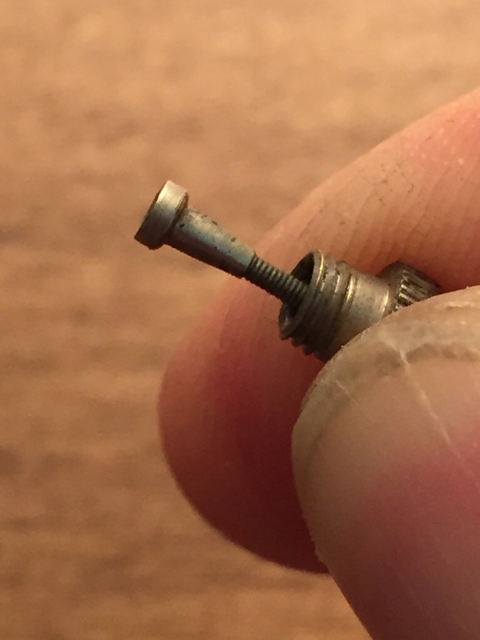

Couple more pictures.
"13" is on top and "8" is on bottom

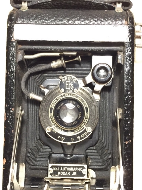

and this is how it folds up into the camera
Hope this helps

I have tested 4 cables. I had an old Prontor cable, another and a Promaster one made in the 80s. The 3 had the same conical threading. I stumbled upon some in a recent purchase, I originally bought the Prontor for $8 and then found an estate sale with the 3 ft nylon coated Promaster for $1 and just bought a view camera that came with 2 one 6 inch and one 12 inch. Go figure... I would acquire 3 just after I bought the first one... However, I one of the new ones had the straight threads like to talked about. It fits perfectly.
Summation: The conical standard style works, but doesn't thread all the way. The straight thread is a perfect match. I guess they were made for the older style. Thanks everyone.
