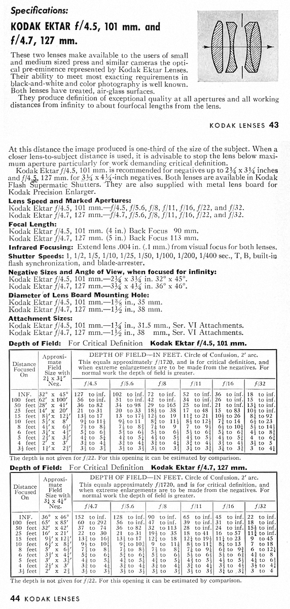

Here's Eastman Kodak's data for the 101mm and 127mm Ektars. It's true some were used on the 5x4 Pacemaker Graphics but edge and corner sharpness will be quite poor.
There's a difference between illumination and coverage, my Ross 105mm f3.8 Xpres will fully illuminate a 5x4 ground glass screen at Infinity at all apertures, but the usable part of the image circle is much smaller. Of course this can be exploited creatively, we only have to look at some early work by Emmet Gowin
