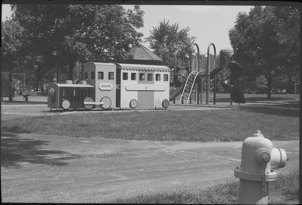

Here's the best image so far (note that I could probably fix it up a bit in PhotoShop but I've scanned it with no correction and it's a pretty fair representation of what the film looks like in real life.) Also note that I'm shooting 2360, which is the Estar-based version of 5360.

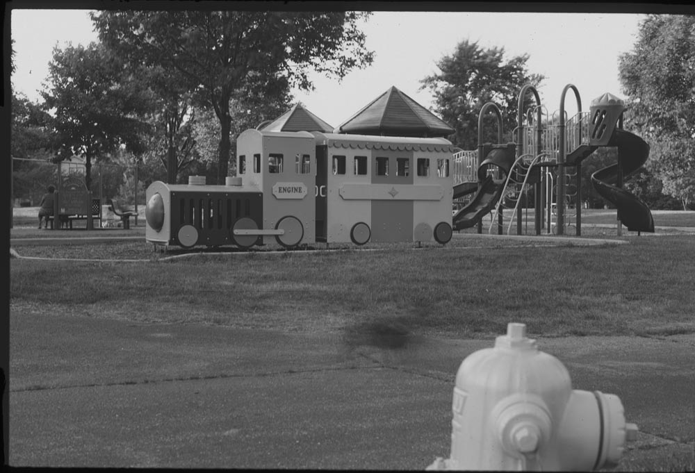

So here are the results after the film dried. First is ID-11 1:1 for 13:00 at 70 degrees F. The results look pretty good, with just a touch of thinness to the black areas of the film:
(That smudge in the middle is a dog on a leash who wandered into the picture during the 16 second exposure...)

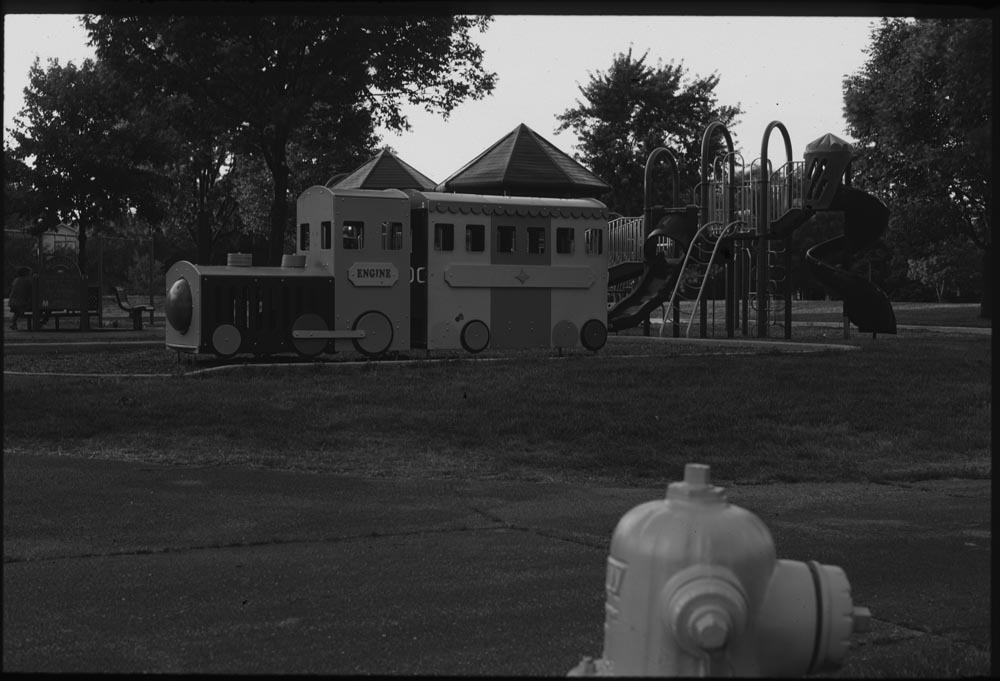

Next is ID-11 stock solution for 13:00 at 70 degrees F. I'm very happy with the results of this in terms of black density. I think one thing that threw me a bit is that black on this film (clear base) is never going to look as black as I'm used to on B&W negative film with its darker base. Plus I think the emulsion is just flat out a thinner coating. I mean, before you even expose it you can see right through it! The results here are about a half stop too dark - maybe because of more development, maybe because the light was fading... but I was bracketing full stops. Could no doubt be fixed in printing but I was scanning with no correction at all to show the actual results:

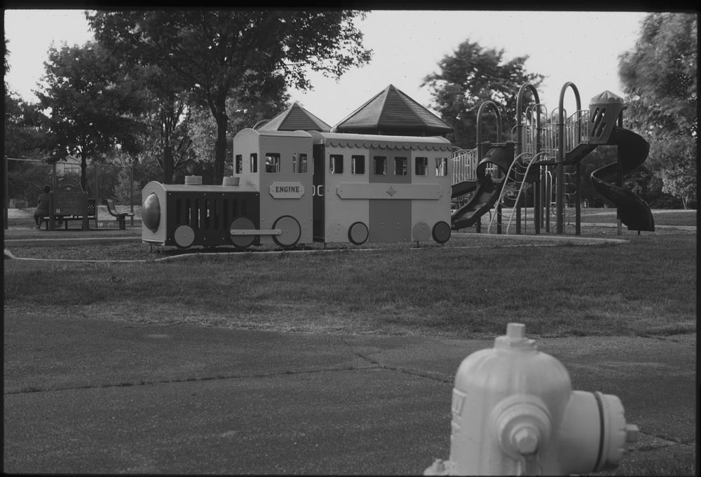

Last we have ID-11 stock solution for 20:00 at 70 degrees F. This was just flat out too much development. Even the clear sections of the film were starting to turn grey again! But the black portions didn't look appreciably blacker than the 13:00 ones, so I'd say at 13:00 I had pretty much fully developed the film to its most usable level. The exposure one stop more exposed than this was actually too thin so I'd say this was a failure in terms of getting the proper tonal range from the film too:
As in my previous tests where I had shot at a speed of 1 (well, really 1.5 because my meter only goes down to 6, and then I calculated 2 stops more exposure than that as my middle point on bracketing) my best exposures were two stops overexposed from that... meaning the film speed is "negligible" or certainly less than 1. Though I should probably try it with at least one other camera. If the one camera's meter were off at ASA 6, it's not something I would have previously noted, and the guy who did the CLA may not have tested it down there!
Given the almost certain need for a tripod and stationary subject, I'd say that bracketing the heck out of this stuff when using it isn't that onerous a requirement. And definitely do it by half-stops if you can. (My Canon FD lenses do half stops, but a lot of other lenses don't.)
