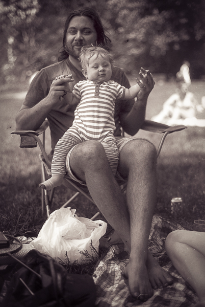

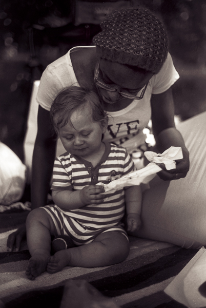

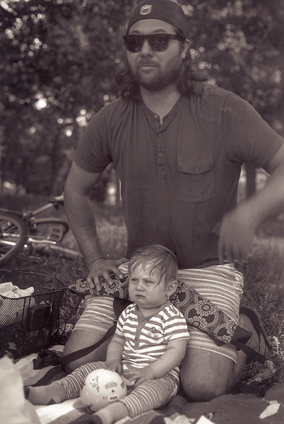

I wound up using Adonal 1:100, 12 minutes with 5 seconds agitation every minute. the negatives are a bit thin, so I'll probably give the next roll a few extra minutes. I also noticed that the whole roll is fogged, so I'll have to look at whether that happened in camera (most likey, as it's an old camera that could use a little TLC), or if it was from when I loaded it.
I'll reply with a scan later this week if anything looks worth sharing.
Trey
Trey
Dec 24, 2007
93
NYC
As I said, here are three scans. I think with a bit of work this stuff can be very cool:
