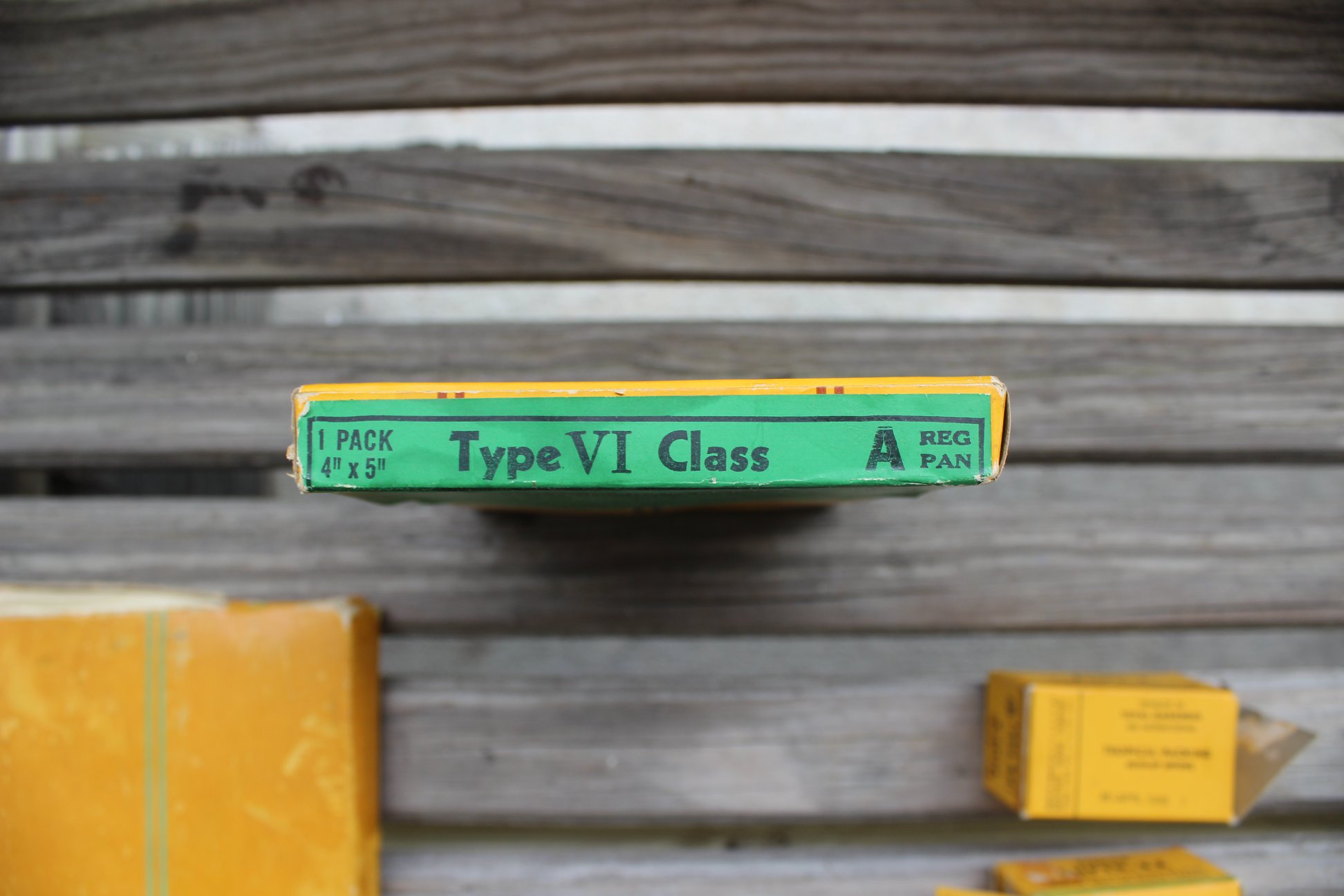

From that list of film, I did a random search on one of htem and found old boxes of htat film on ebay, dating from the era that you are interested. Might want to try that approach too.
For example:

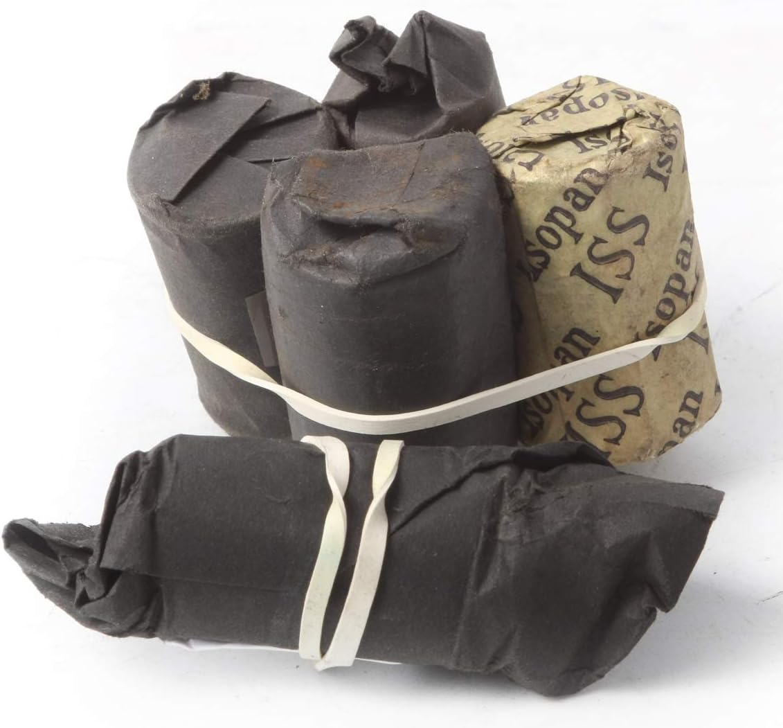

From Amazon; I can't seem to make the link copy and paste here. This is 1945 Isopan, Not sure about the size... surely not 4x5

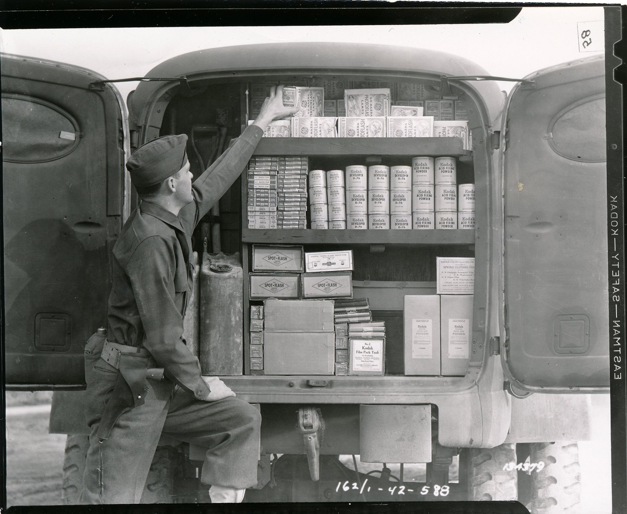

Zoom in, you can make out some of the boxes and film brands available in 1942, during training state-side.
"Rear of the mobile darkroom of Photo Unit #1, showing the storage space for supplies."
Camp Funston, Kansas.
26 January 1942.
Photo by Lt. Jack M. Judge, 162nd Signal Photo Company.
SC 134379, Credit NARA.

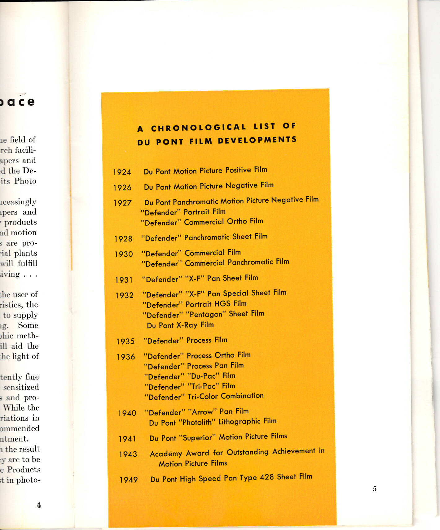

Dupont would have been another source of sensitized material. I've printed on Dupont paper and I know they made film.
Here is a list of DuPont Films. This is from DuPont Data Book that I'm selling on Protrio.com classifieds in a few minutes. I am selling many of my books. I am also selling Kodak Film Books from 1938, 1952, and 1958.
