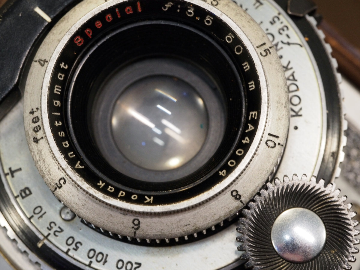

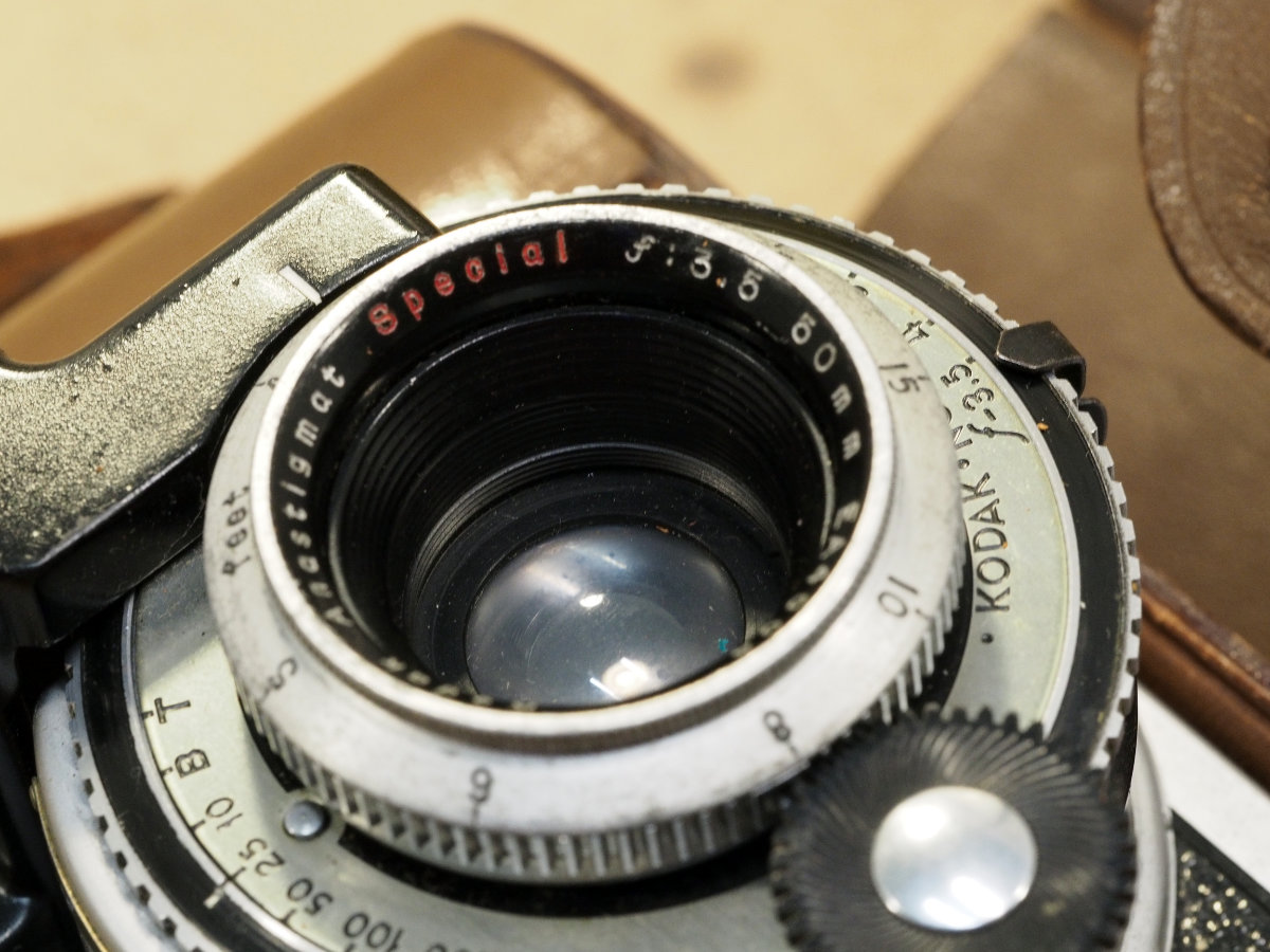

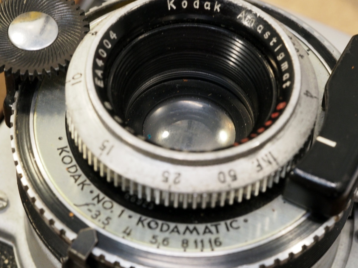

If anyone has one of these cameras, any chance you can look at the lens for me? I recently was sent this sample, and it appears to me that the front element is missing. And then I focus back and forth, I see no motion of any lens element. This is a front-element focusing camera as I understand it.
Attached are photos of the lens. At the bottom of the opening, above the small glass element (dirty glass), are threads that sure look like they could be for a lens mount.
Any feedback appreciated. Thank you!!

Nothing missing but recommend a cleaning.
Filters for it were Series VI in a press-on adapter. Nothing screws into the lens.
The movement is within the lens. Nothing to see here, just move on.
The front element is on a multi-lead screw thread and moves less than 1 mm from infinity focus to 4 ft. focus. The position of the lens is fed to the range finder by a cam cut into the lens cell and a feeler inside the housing to the side of the lens. When you put the front cell back on be sure to start it on the right lead, otherwise it won't focus. Don't take off the winding knob if you do dismantle the camera. There are three sets of tiny rollers and springs that keep the knob from turning the wrong way and they will pop out when the knob comes off. They're easy to lose or damage and a right pain to put back (voice of experience). Here is a good link: https://pheugo.com/cameras/index.php?page=kodak35.
