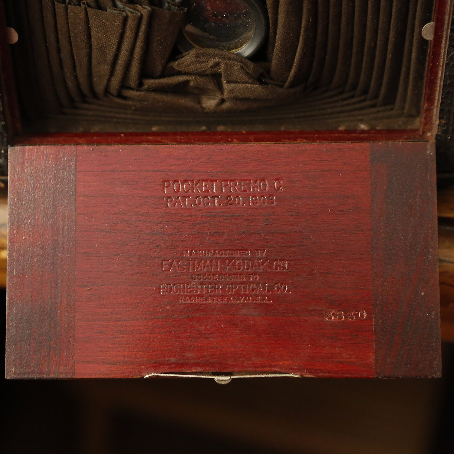

Well, I was browsing a local antique shop, not really expecting to find anything interesting, but it turns out that I did. One item was a severely beaten Rollei TLR, not a Rolleiflex but still Rollei-somethingorother. The other was this wonderful folding Kodak that looked similar to some brownie's I have seen, but larger. There is a door in the back revealing a ground glass, and as far as I can tell there is no spot for anything like a modern film holder. The back pulls backwards on some spring like feeling thing revealing the inside, presumably where the film goes. Does anyone know anything about this camera? The markings on it are as follows:
Lens:
Bausch & Lomb Optical Co.
3 1/4 X 5 1/2
Planatograph f8 E.F. 6 3/4"
Inside the door for the groundglass:
3-A
Pocket C
Pat. Oct 20, 1903
July 21, 1896
July 5 (I think) 1902
Oct 19, 1909
Feb 4, 1908
Mar 21, 1911
July 8, 1913
Manufactured by Eastman Kodak Co.
Successor to
Rochester Optical Co.
Rochester, NY, USA
0913

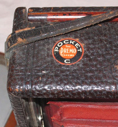

The camera is covered in leather, and embossed on the carry strap is the word "Premo", spelled just like that. There is a small dot on top of the main body of the camera that says, "The Premo Camera Made In Canada"

Is this the camera you are talking about?

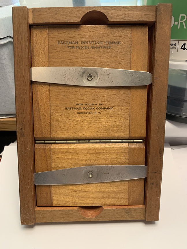

I know this is an old thread, but I just found it and wanted to see if anyone is still out there to talk about the Kodak Pocket Premo C cameras. I have one that my grandfather used back in the early 1900's....I can't pin down the years exactly. It's the 3 1/4 x 5 1/2 version that used glass plates. I have several of the plate holders, a couple of boxes of unused glass plates. At least one of the holders still has unexposed (until I cracked it open) glass plates inside. Inside the back door it only lists one patent date..Oct 20 1903.
It doesn't appear he ever tried to use this with a roll film, or if so, I don't find any film or holder, etc. The frosted glass focusing plate was in the camera, but was broken in two. The little dot on top that some of you referenced is there, but it has no writing or is faded away, etc.
I see many references to these cameras being 3 1/4 x 4 1/4 or some such, but this one is definitely 3 1/4 x 5 1/2.
If you know anything about these or want to ask me anything, please do..
My grandfather was a photographer in the early 1900's (likely in the 1905 - 1925 time frame) in South Alabama. I don't think it was his full time occupation, but I'm not sure of that. He also left me a 5x7 SEROCO (Sears Roebuck) View camera and some holders, etc for that. Also in the stuff he left were 10-12 developed 5x7 glass negatives that I've recently converted to digital pictures.....that was fun and interesting.
