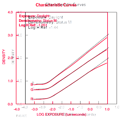

Ive always photographed with the Kodak Portra 160, starting with the NC and VC versions. I just read somewhere (not sure where) that the ISO 400 has a larger Dmax range and better Highlight latitude. Can anyone with experience tell me if that's true, and how much of a differens in real usage this would make?
I shoot a lot of indoor Large format, and the range between indoor and outdoor (window) can be up to maybe 4-5 full steps. This works with the 160, exposing for the dark parts indoors and pulling back the outdoor a bit in the computer after scanning (Imacon). Would the 400 handle this better?
thanks
4-5 full steps
That's not a whole lot to be honest. Well within the range of any color negative film.
Perhaps there's something with definitions going on here, though. Both the indoor and the outdoor parts of the scene have a brightness range. What's the total range between deepest shadow you need to register and the brightest highlight where you want differentiation?
Overall, you can expect a little more usable DR from Portra 400 due to crossover behavior, although when scanning and digitally post processing this is fairly easy to correct for, rendering the practical difference very limited. Have a look at the overlayed curves of 160 (red) and 400 (black):
Before crossover on the red channel sets in, you can expect some 8 stops of DR on 160, but 400 does take more overexposure - in fact, the point where serious crossover happens isn't visible on the Kodak charts.
Always take these curves with a grain of salt as datasheet curves are generally not 100% accurate and they of course also depend on how the film is processed (quality of chemistry, temp. control etc.), but they do give a general impression.
