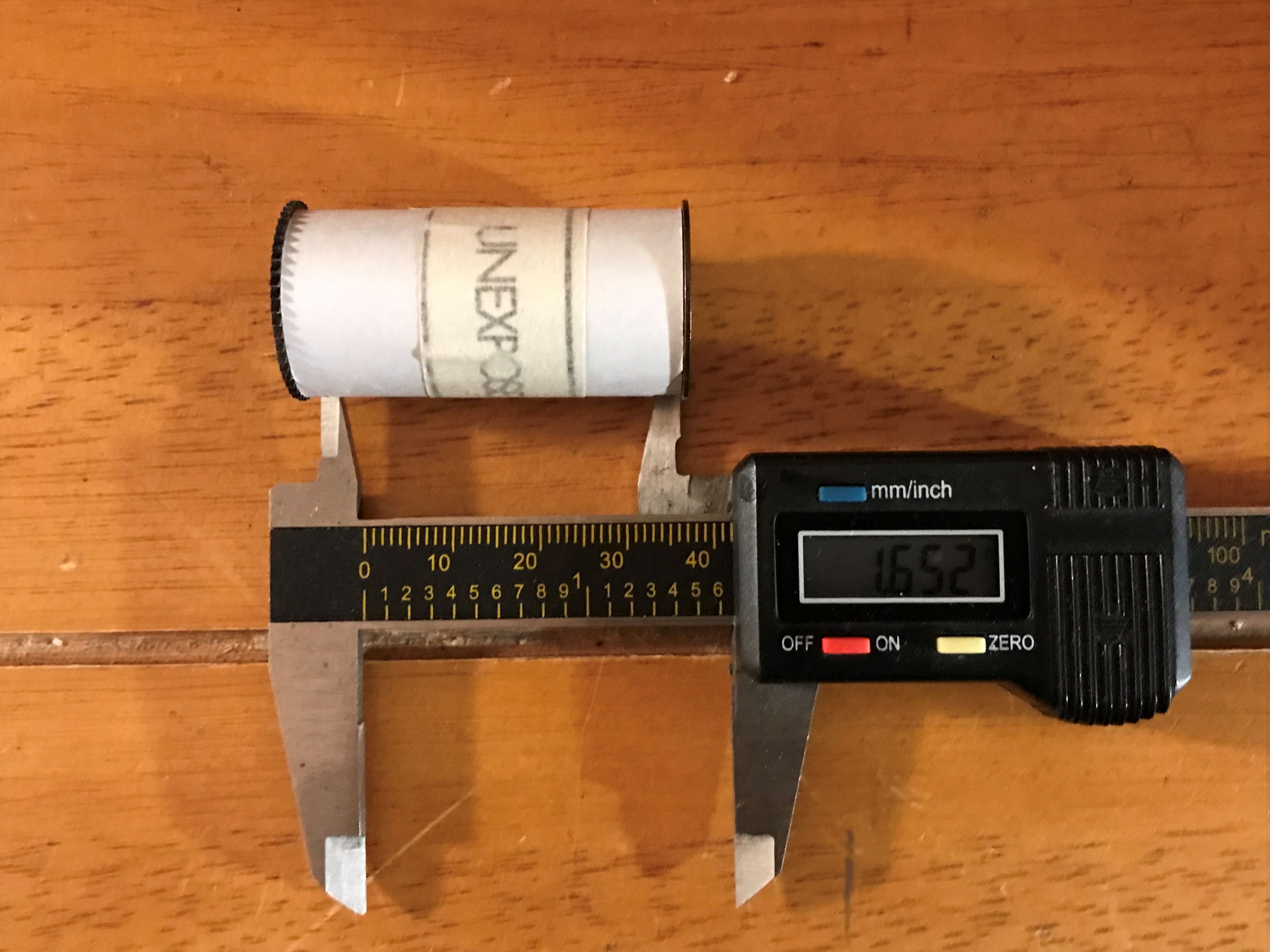

I can also confirm the film width measurement as with Dwight above. Measuring my original spool gives a width between the flanges of 1.652" or 41.96mm which is why I cut my film to 42mm in width. This would make a nominal 1.65 inches as the maximum permissible width of the film. More often, film was originally slightly narrower than this, and the backing paper edges are skived so they slightly curve around the film base to give better light sealing characteristics.

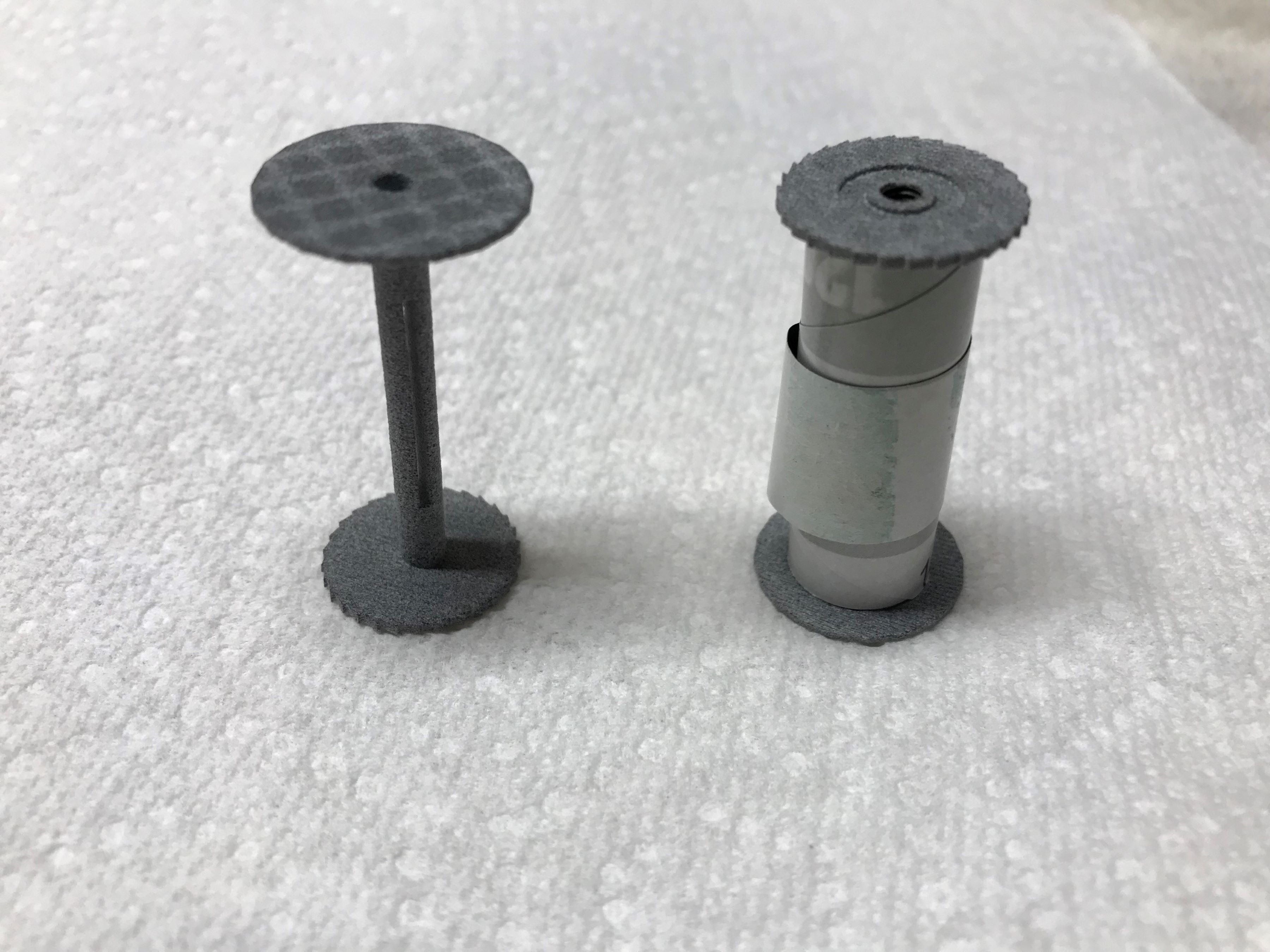

Brian, Thanks for asking. At this point, I was able to locate a manufacturer that was able to make me some reproduction 102 film spools out of nylon. They are of quite good quality and work in both the feed and take-up positions. (I paint the ones I use in camera black although the material is very opaque).
