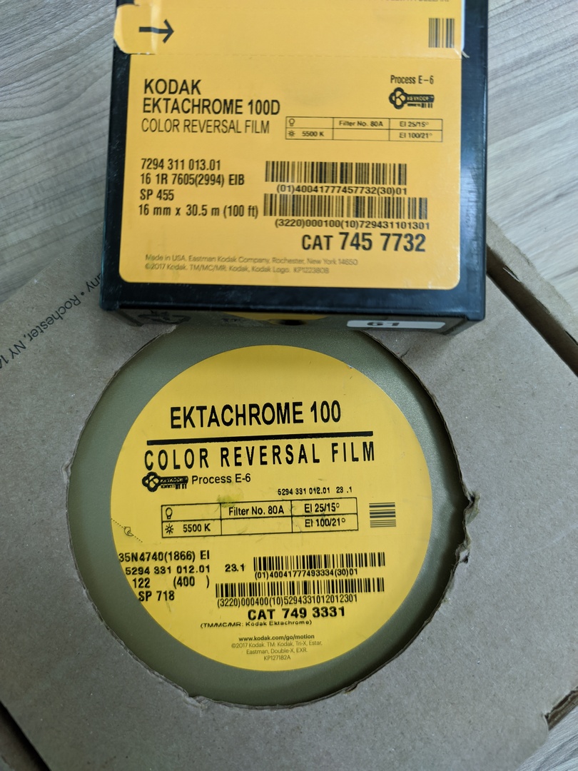

Thanks.
They arrived today - everything is fine. There were some interesting moments with the order, but I am very satisfied. And the price is better if I had bought them from B&H. The price without VAT (that's how the invoice was issued) is EUR 648.85 (EUR 778.62 with VAT, which is somewhere around $858), and in the current version it can be used for a company expense and possibly a tax credit, while the order from B&H was $979.74 all , without the possibility of a company expense.
However, we in Europe are not completely left behind :smile:
By the way - yesterday I received a notification from B&H that the 100D is now in stock.
