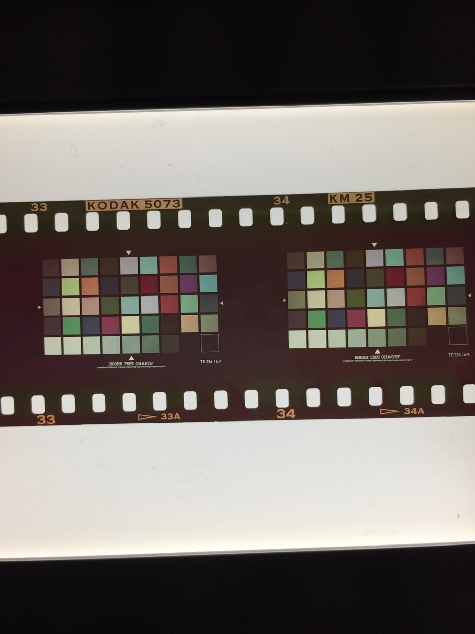

Ive processed Kodachrome as well and I can assure everyone reading that it’s a tall order to process that takes a lot of time, precision and extremely tight process control. It’s like E6 processing on steroids. Still working out the details and color balance, but Kelly-Shane (guy in the picture above) and I have worked together on this. Hopefully we will do a full write up on it once the project is completed. Here’s a sample of what we achieved.

Looks nice! How do you do the re-exposures of the film roll?

You have to have a timed red light in the right color spectrum for the red sensitive layer in which you then develop the cyan layer after and the. A blue light in the right color spectrum for the blue sensitive layer and then you develop yellow layer after. If you’ve exposed both red and blue layers to completion without contaminating the green layer (for magenta) and have developed cyan and yellow at the right amount of development time you then exposure the last layer, green sensitive to tons of full spectrum light and develop the magenta layer.
