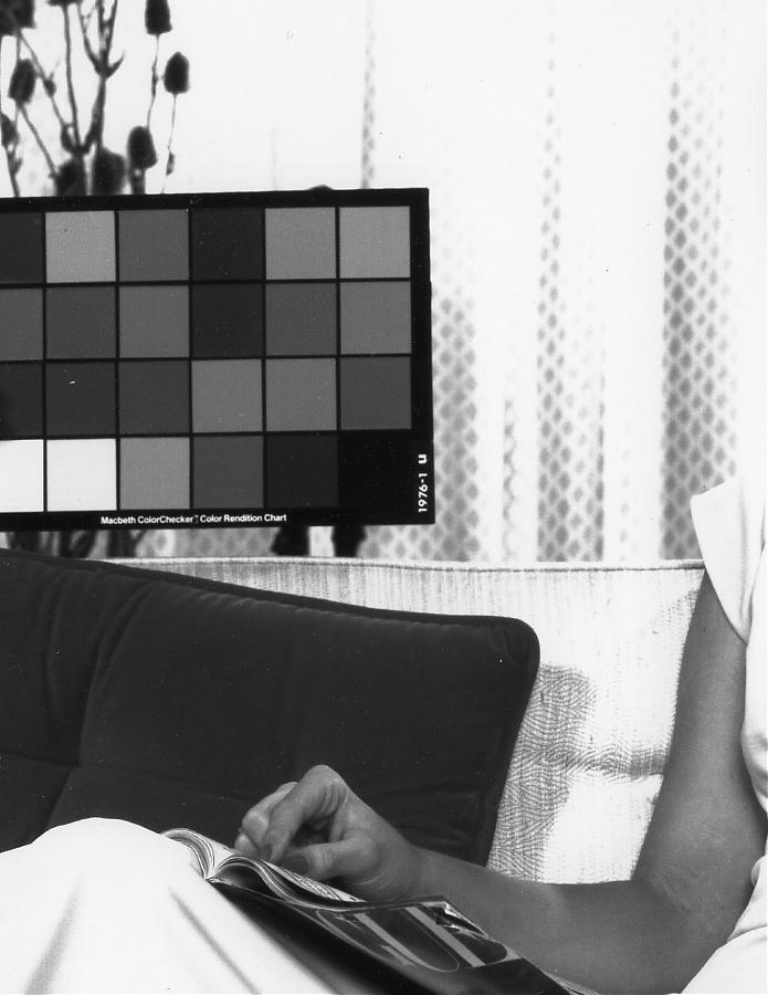

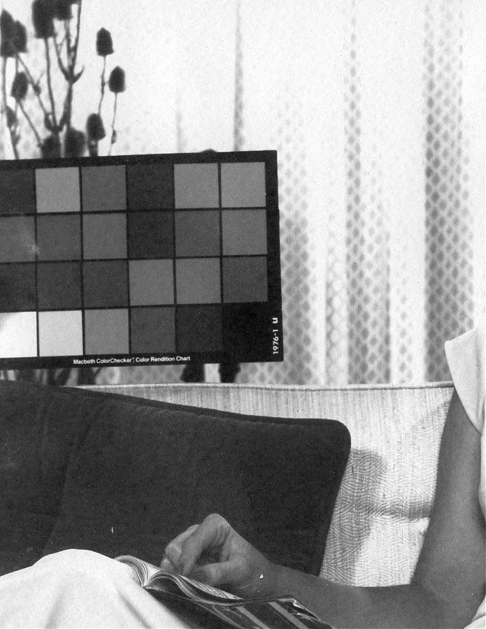

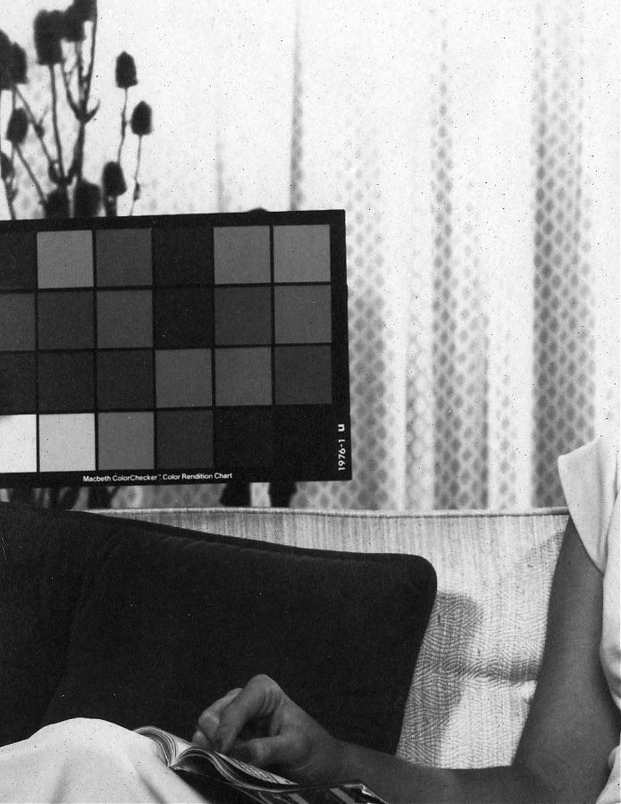

I tried to paste them to my post above and it failed to work. So here goes as attachments.
Left to right
1. Ilford MGIV with grade #2 filtration (reference)
2. Above posted emulsion with no filter, but same exposure
3. Same print using my Azo type emulsion.
#1 and 2 were contact printed on the easel of my enlarger set to give an even exposure of 8x10" from a 4x5 negative, and the Azo type emulsion was contact printed from the same negative using my usual contact setup with a tungsten bulb. They were all scanned with the same settings and no alterations were made to the digital images.
You will have to forgive a slight density difference between them as I usually do not have that much paper to play with. I have so many tests to run.

Excellent comparison samples! Thank you. Which contrast grade is the KoBro paper you posted here?
For rhodium chloride, you might check with mostlymetals.com. He's an alt-printer who buys in quantity and supplies a number of photographers, and often has good prices. I've bought gold chloride from him, and I know he gets rhodium chloride.
That is grade 2. It is the ISO washed version mentioned and varies only by using PA gelatin (from the Formulary). You saw my methods in the workshop and I show a picture of this in the DVD thread.
