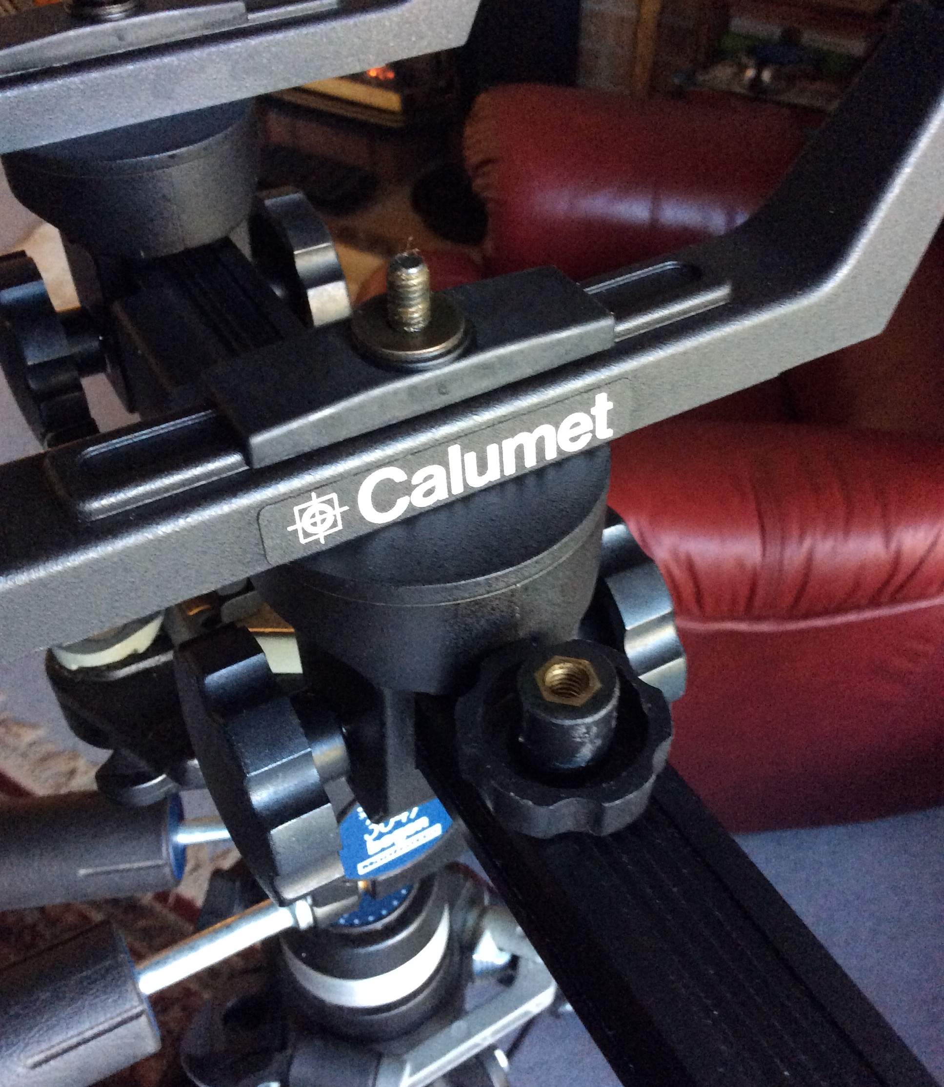

I was tightening a knob on my camera when the plastic just broke apart in my hand! I retrieved all the pieces and super-glued them back together to restore the knob, but I don't feel it is a durable fix. I could use epoxy to stabilize the walls around the embedded brass nut inside the knob, but I would prefer a strong long term replacement part.
Options I'm pursuing:
1. Does anyone know of a source of spare parts for this Calumet model?
2. I would have to determine the thread size and depth, and wonder if there a source of durable plastic knobs that could replace the OEM knob. Garden variety cabinet and drawer knobs available in hardware stores use a thin screw and will not fit. The thicker screw is necessary so that it will hold up under repeated tensioning.
3. I could use a bare nut and a box wrench in a pinch.
Thanks for any help,
John near Seattle

I do use the shift movements, so I'd like the convenience of a knob. I also checked knobs at a regular hardware store and all they had were the thin screw variety for light duty drawer and cupboard applications. I will go to Lowes and Home Depot to see if they have knobs that will take the thicker screw dimensions that I can crank down on with confidence.
John near Seattle

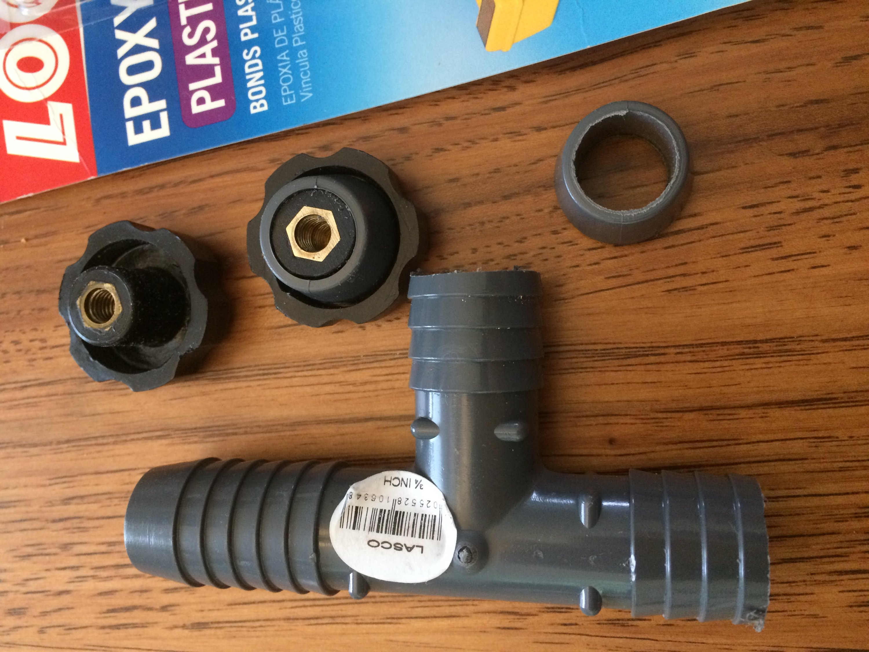

I decided to try to fortify the existing knobs and found a delightful solution that cost me 74¢ and some epoxy glue for plastic that I had on hand.
I found a plastic hose T-joint at Lowes. The ends of the T-joint fit perfectly over the fragile shaft of the knob. Like replacing both headlights in the car when one burns out, I decided to do both the front and rear standards.
I cut off two of the ends with a fine tooth hacksaw, sanded them down to a flush fit, generously glopped them with epoxy then assembled them with a twisting motion to evenly distribute the cement.
This addition has effectively increased the mass of the knob shaft by 100% and secured the new assembly to the main knob body.

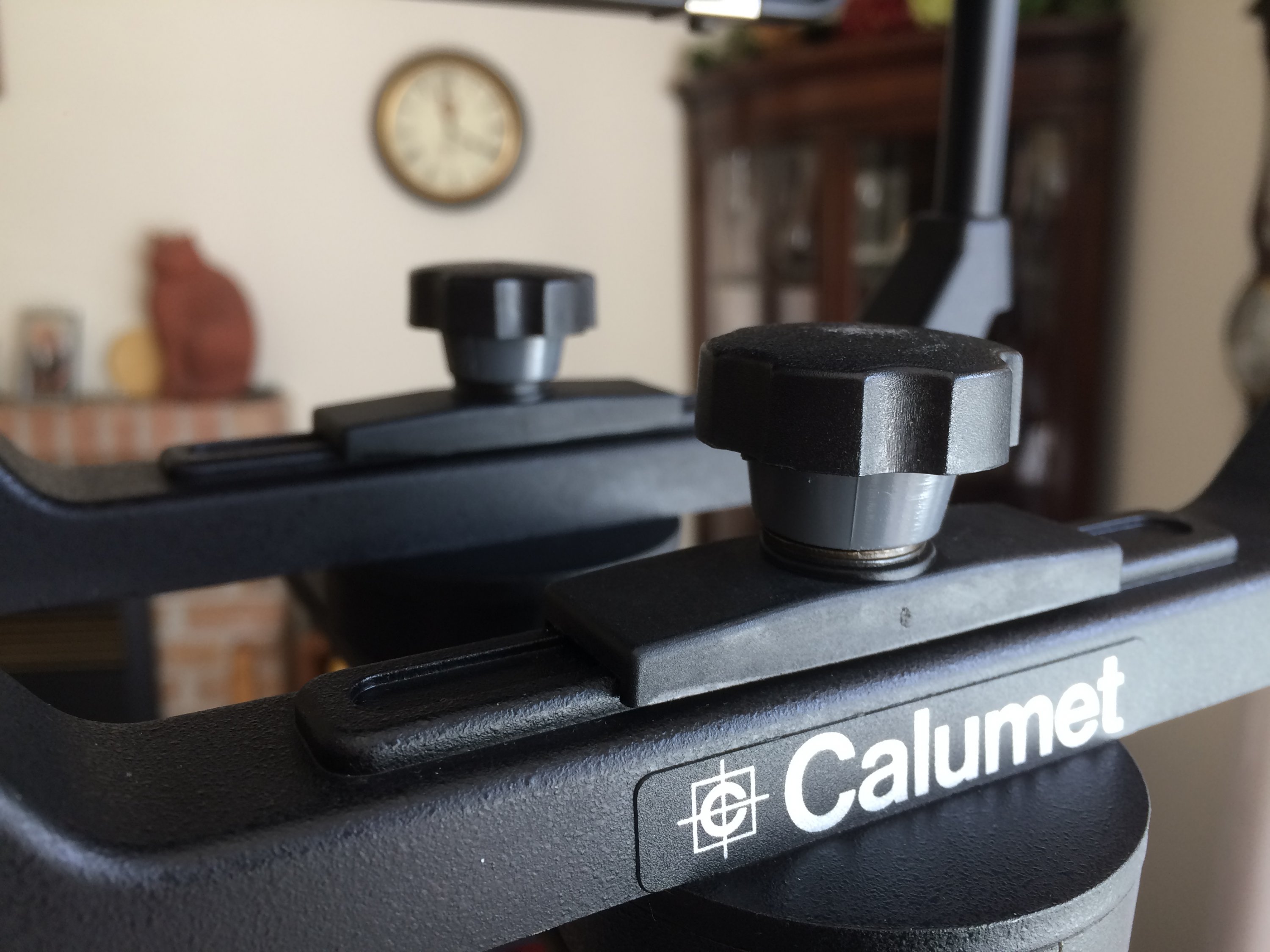

A nice Saturday view camera repair project.
John near Seattle
The beauty shot.
