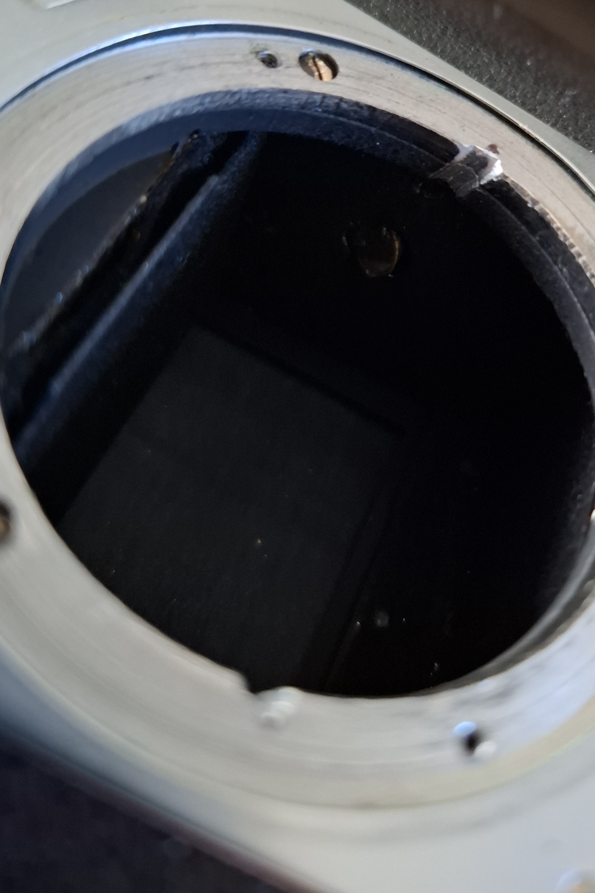

As in my original post above, I mentioned that other, probably later models of the Exakta have handy cutouts once the lens mount is removed - at 90 degrees and 270 degrees. So I decided to make my own.

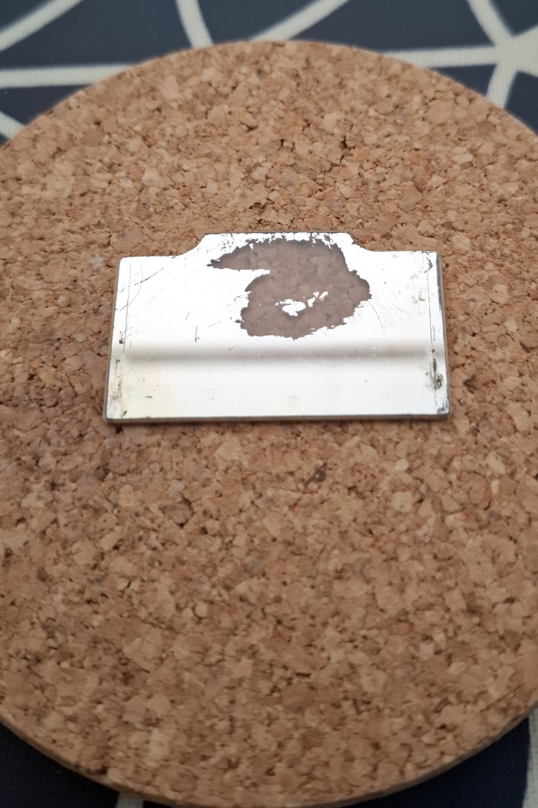

After removing the mount and setting the camera on Z to retract the mirror and open the shutter curtains I gently filed two channels at 90 degrees and 270 degrees using fine needle files at a slight angle as the mirror won't be coming out 'flat' - it only needs around 2mm per side to allow enough space to cleanly extract the mirror. And Bob's your uncle, one extracted mirror.

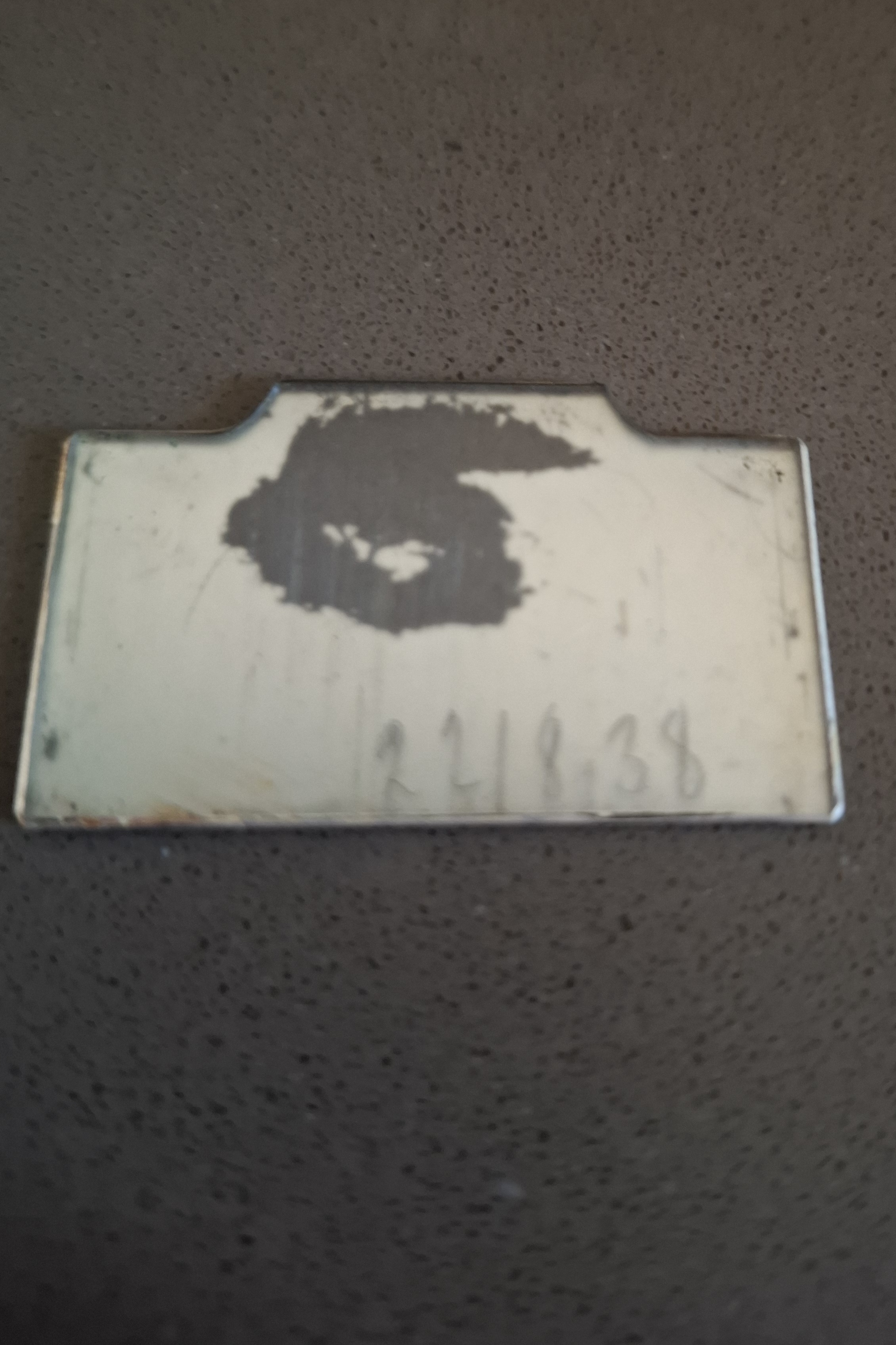

The reverse of the mirror gives a date of 22/8/38 so narrows down the production date of my particular camera.
Mirror extracted it's next stop will be scientificmirrors.co.uk for a resurfacing, then re-installation and a touch of black paint to any losses around the mirror box.

That is certainly direct! Though it seems like a harmless modificiation that will save the risk of much disassembly. I think I'd do it itoo.
