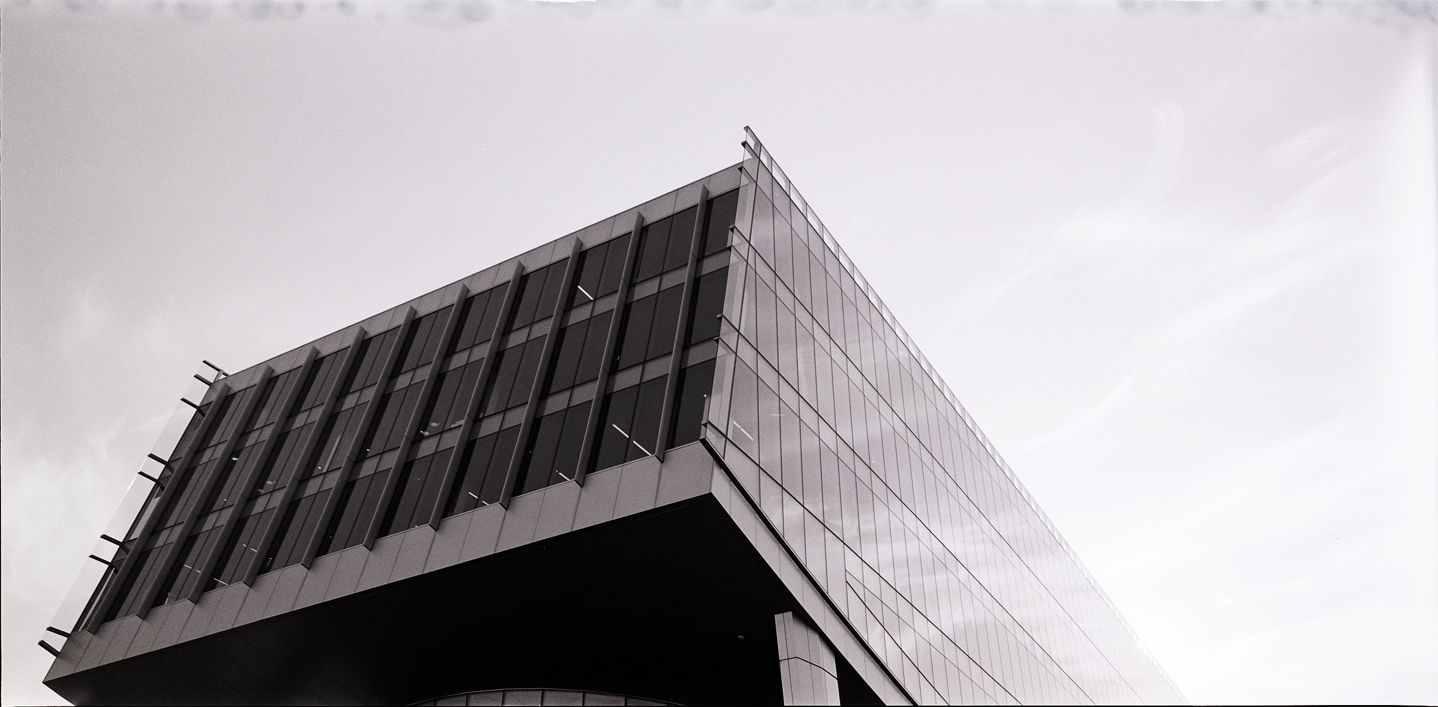

What on earth is causing these circular patterns at the top of the frame?
I use Jobo 1540 tanks. This example here is TMY 400 ISO400 HC110 for 13 minutes at 68 degrees. I do a 1 minute anti-halation pre-wash. 2 gentle inversions at the top of the minute.
My notes say that this particular roll was in the *bottom* reel. Both rolls in the bottom and top exhibit this problem. This problem occurs in about 4/5s of all rolls I develop.
4th frame in a 6 frame sequence (6x12 camera).
Thanks!

From what I can gather, you are developing 120 film, is that correct?
From a quick look at your image, I would think that the marks are from air bubbles.

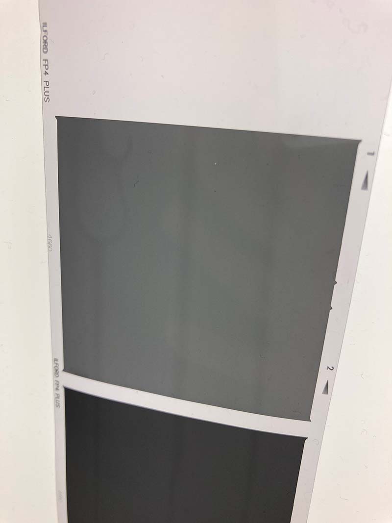

Can you upload an image of your negative, please (the same as the positive image you have uploaded)
Something like this.

Follow Kodak's agitation instructions and the problem should go away. Rap the tank firmly several times after filling to dislodge the bubbles. 5 inversions in 5 seconds every 30 seconds for agitation.

Air bells, you need to give the tank one or a few hard raps when each chemical is poured into the tank.

JOBO reels are prone to this with 120 film and inversion processing. Bubbles get trapped between the film and the edge of the reel and there is no where for them to go. The best way to eliminate the bubbles is to use a drop or two of Edwal LFN in the developer. Prewetting will also help. When you fill the tank, fill it at an angle. It also will help to use aggressive agitation at first. The design of the JOBO 1500 system doesn't allow the reels to move on the stalk. Other plastic systems are like that too but the reel designs are different. You rarely see bubbles on metal reels because they easily move around in the tank which dislodges any bubbles that form. Whacking the tank with the JOBO doesn't work all that well. I'm an almost 30 year JOBO user so I just know from experience. You can whack all you want but the bubbles are trapped in there.
I just noticed you use HC110. You might not be able to use LFN with that. I've had issues with Pyrocat mixed in Propylene Glycol. The combination of the Glycol and the LFN turns the developer into a bubble bath. LFN works great with every other developer I've tried though.
Keep in mind the JOBO system was designed for roller processing. I think the design of the reels isn't the greatest if you don't process that way. With roller processing the developer is always moving through the reels dislodging any bubbles that form. Not so with inversion processing.
Hope that helps you.

After the "thumps" recommended above, you might consider giving the film its first 30 seconds of agitation by rolling the tank continuously by hand on a flat surface or a roller agitator (which is what I do).
