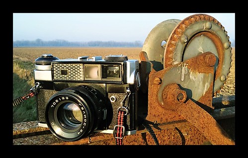

Kiev 5 has frames lines and a wonderful viewfinder. The generous and contrasted rangefinder is like that (almost) of Leica.
The gigantic problem is that the lens design is aborted almost immediately. The external bayonet does not include the mounting of any lens (Jupiter 8 and Helios 94 - 50mm only).
It exists in some private collection or in some Soviet museum, a lens for this camera... the extraordinary Rekord-4 !!!! 0.9/52mm

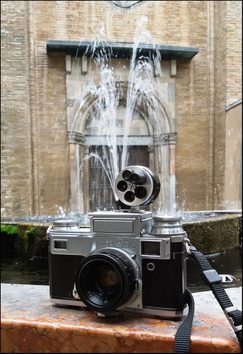

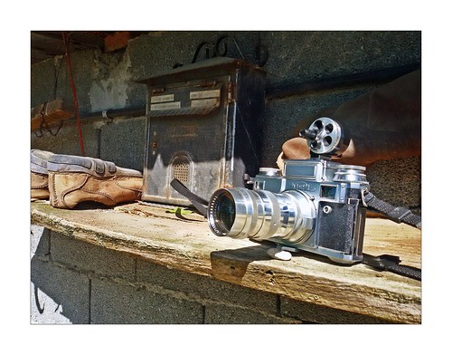

They made a turret viewfinder with parallax correction for the Russian rangefinder cameras suitable for lenses from 28 to 135 mm http://www.ebay.co.uk/itm/Soviet-Universal-Turret-Viewfinder-28-135mm-For-Leica-Zorki-Fed/371891312909?_trksid=p2047675.c100011.m1850&_trkparms=aid=222007
Those finders look great but I'm not sure how practical they'd be. For one thing the view is a little pokey, and I can't imagine many people using all those focal lengths on a rangefinder camera. Also there's no focusing aid. On balance it's easier to guess the extra coverage round the edge of the 50mm view for my 35.
It is easy to use and even bright. Frame the scene and focus it with range finder, then frame it again with the turret.
I have 3 lenses for Kiev 4A ( Jupiter 8 50mm - Jupiter 12 35mm and Jupiter 11 135mm); with 35 and 135, use the turret.
