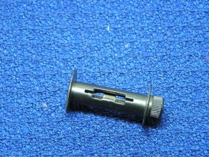

One other difficulty with this camera is the removable take up spool. The original must have been lost, because the previous owner cut a slot in a standard plastic 35mm cassette spool. The problem is there's nothing to stop the film leader slipping back out the slot when I wind on, and it's often a case of "third time lucky" (or 4th or 5th!) which isn't efficient or quick.
The question is are Kiev spools worth purchasing because they have a retention method for holding the film in place, or is there a better bodge with a regular spool? It's come to the point where I carry masking tape to connect film to spool which is a bit silly.

The Kiev spool has two slots, I feed the film through and fold the end over by about 3mm then tuck the fold into the second slot. Very secure, I can't pull it out with the rewind knob. You can carry a second roll of film pre-threaded into a spare spool for quick reloading.
Thanks, it sounds like it's worth getting the real thing.

The upper spool is the original, the lower spool, I don't know if that's original but later, or what. I have both, the lower one requires cutting the film leader with a central tab; maybe it's from a cartridge?? My 4a came with one of each.

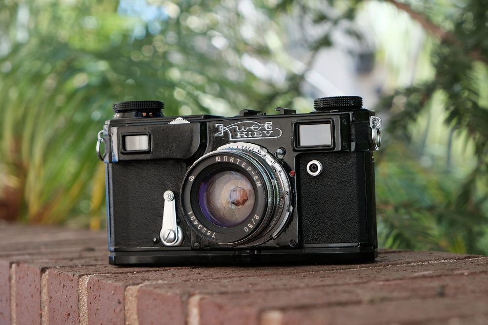

I just got my Kiev 4a, Type 2 (black) with Jupiter 50/2 ($55, ebay). I had to figure out that film trick, because my first roll did not wind right. I just tested the self timer, and it advances, but does not fire (must have been twisted). I have not yet tested the flash sync. Everything else seems to work, but it is going to take some getting used to this camera. The viewfinder is hard to frame without removing my glasses, and then the engravings are small and closely spaced so I need to put them back on to set shutter speed and aperture. Setting the shutter speed is tricky, and if you do not advance properly, you can get messed up (advancing is in two steps, first wind film, second continue winding film plus cock shutter). Focusing is a little difficult because the viewfinder is small and not too light. The Contax hold is pretty easy, and I got used to it quickly. I do like the wide spaced rangefinder. These impressions are based on my first roll of film through. The camera itself is beautiful, and seems to be well constructed. If my test roll looks fine, I will likely start shooting some B&W with it.
