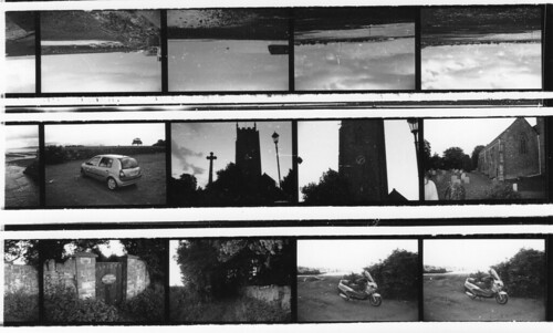

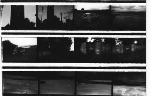

OK, here are 3 quick setup contact prints
to hot in the Darkroom to stay to long.
Kentmere 6 secs
Kentmere 3 secs
Kentmere 3 secs
Ilford 6 secs MGIV cut from 8x10
Ilford-6-secs

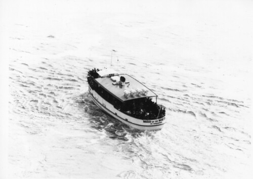

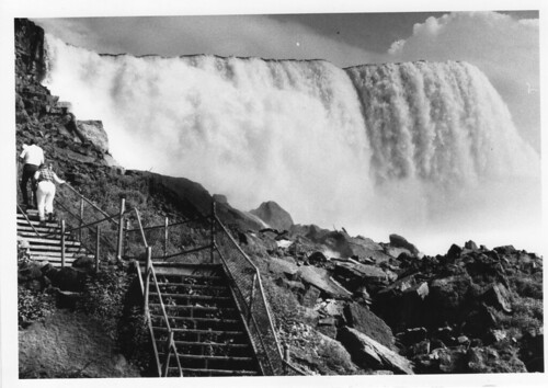

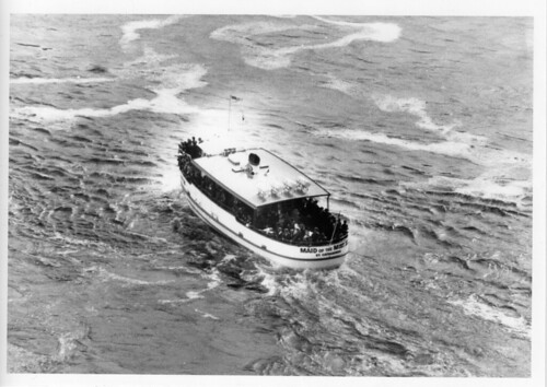

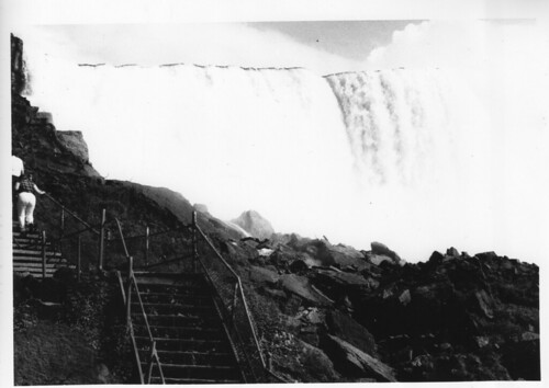

Dear Mr.Yoda,
I got your neg today, neg a little thin and somewhat lacking in contrast.
In saying that it printed OK ish,
I started at the bottom end G3 ( print 1 ) and topped it out at grade G4.5 ( print 2 ) to see what I could do...
I finished up at Grade 4 19 seconds @ f 5.6 I dodged as follows
LHS bottom of print - 10 seconds, middle bottom of print - 7 seconds RHS of bottom - 4 secs
shaded entire LHS print out -2 seconds then + 8 seconds bottom to top of image.
( Print 3 )
The above is printed on ILFORD MGIV RC Pearl
I then stopped down 1 stop ( f8 ) and printed on KENTMERE VC RC and shaded as above, the print looks fine, perhaps a little more contrasty ( gloss effect ). Sent teh prints and negs back to you in the post today. Printed on an KAISER VCP7005 with ILFORD Below lens filter kit. Processed automatically in an ILFORD 2150 RC processor.

As expected, you get similar density with the Kentmere that you get with the Ilford if you just expose by closing the lens one stop, or half the time. It's known that the Kentmere paper is faster, and I believe this has been told a few times in the thread above.

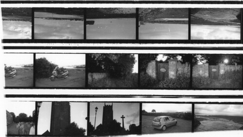

Kentmere 6 secs
Kentmere 3 secs
Kentmere 3 secs
Ilford-6-secs

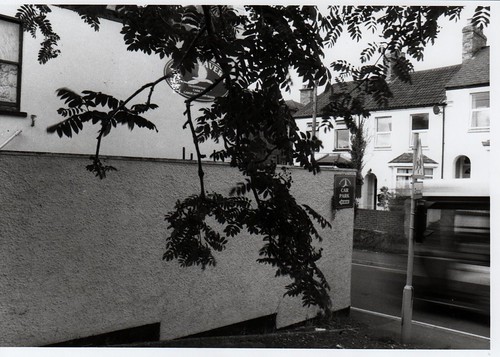

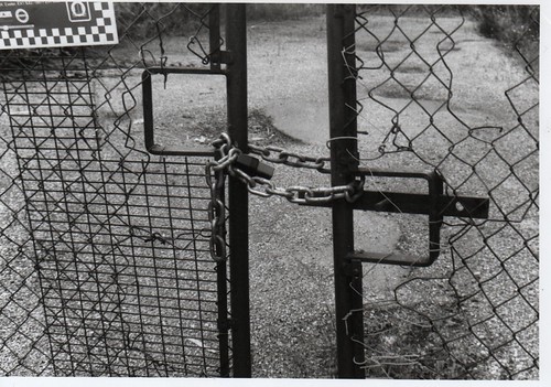

Here are a couple of shots using the Gamer Enlarger still on Kentmere paper
There was no filtering done at all, it has a drawer for filters, so i have some of them on order
Both shots were exposed for 10 seconds.

You have a nice range of tones in these prints, and I would say it would be better to work on your technique with your existing materials than switching developers. Developing film isn't rocket science; it just takes a keen eye and an understanding of how to correct for things that aren't going right. Use Grade 2 filtration as your standard, and try to make negatives that fit the scale you need for grade 2 printing.
Too little contrast - develop longer. Too much contrast - develop less. Negatives too dense - expose less. Negatives thin - expose more. Repeat as necessary until you get decent work prints at Grade2. Learning these steps, how to recognize the problem, and how to correct them, will make you able to appreciate the differences between different films and developers.
I say just keep doing what you're doing, lend your results a critical eye, and try to compensate for any problems at the negative exposure/development stages by altering your technique. For example, you could, just to see the difference, expose your film, on purpose, -2 stops, -1.5 stops, -1 stop, -0.5 stops, normal (box speed), +0.5 stops, +1 stop, + 1.5 stops, +2 stops, +2.5 stops, +3 stops. And then develop normally according to the manufacturer's instructions. Print all of the negatives to the best of your ability, which includes using the contrast filters and different exposure times. This will tell you an awful lot about how you prefer your prints to look, or not to look. It teaches you about mistakes, without having to blow it on important shots. Then when you find a preferred film speed (+/- however many stops from box speed that may be), expose an entire roll at that speed. Then develop one third of the film at a time, and develop it using different times, say +20%, normal, and -20%. Print one of each to the best of your ability. This also teaches you an awful lot about how to get negatives that you like how they print.

Hey Dorf, the developer i used for the paper was Ilford Multigrade and was at 20c, it was a new batch.
It was really warm in the darkroom, but i was only in there 10 mins, that why the contact prints look so bad lol, i rushed them

This shot i exposed standard at 10 secs F11
1-Standard
This shot below, was the same image, dodged and burned for 20 secs at F11
2-Dodge-Burn
Again below was exposed for 10 secs at F11
3-Standard
Same image again, Exposed for 20 secs at F11, doged and burned also
If you look at the front of the boat, i got a bit dodge happy lol
4-Dodge-Burn
From looking at modern pics of Niagra Falls this is not the same boat they use now
All pics above were using a Grade 2 filter and developed in Suprol paper developer.
Both shots only took 3 peices each of Kentmere VC glossy 5x7
Remember its just practice for me, so all comments are really welcome.
So what do you think ?

Wow, what an interesting story. Have you heard about the Vivian Maier collection? Worth reading up on. A substantial part of her films were undeveloped and lay in a box in a cupboard for years and years. John Maloof, who virtually by accident bought the collection, spent months afterwards to develop the remaining films as well as cataloging the already developed ones. She never printed her photographs or even showed them to anyone. Imagine that. Thousands upon thousands of unseen pictures, that close to landing on a trash heap.
5x7 prints are tricky to dodge and burn, because one has to work finely with small instruments. I think even a minor size bump to 8x10 or 9,5x12 will make life easier for you. It will, apart from giving you more space, also extend the column height and the printing time. More time is more forgiving in terms of minor mistakes.
If I were you, at least try the following: Instead of printing darker and dodging on the boat, do the opposite. Print a lighter base exposure and burn in the water and the roof of the boat. It is ease, not size, that matters. Remember to work far from the paper and to keep your dodging tools moving constantly. Use a piece of cardboard and work right round the boat, giving it equal exposure time in a 360 degree circle. For the boat's roof, make a small circular or oval hole in a piece of cardboard large enough to obscure the rest of the image, and burn in by covering the area you want darker. If you move to and fro at the same speed, you will burn in most in the center of the area, so move slowly one way, fast the other, or time it such that you do only one pass. For the water, you may perhaps use a higher contrast grade. Only change the filter, leave the rest as is.
It took me a while to understand how to apply contrast filters, or put differently, what I should be looking to achieve with them. That this is non-obvious is perhaps surprising, and the degree to which it is subjective also complicates matters. In simple terms, you can use your grade 2 to determine the time to expose your highlights optimally. That will give you an exposure with just the right amount of details in the brightest parts (below pure white). Then keep this exposure time, and change the contrast filter to give you the corresponding dark tones, including a solid black if that is what you want. For grades 4 to 5, you will usually have double the exposure time (read the manual to be sure). It means defining your white point with the timer, and the black point with contrast, to use histogram terminology. Then use minor dodging and burning to cover the areas that need attention.
