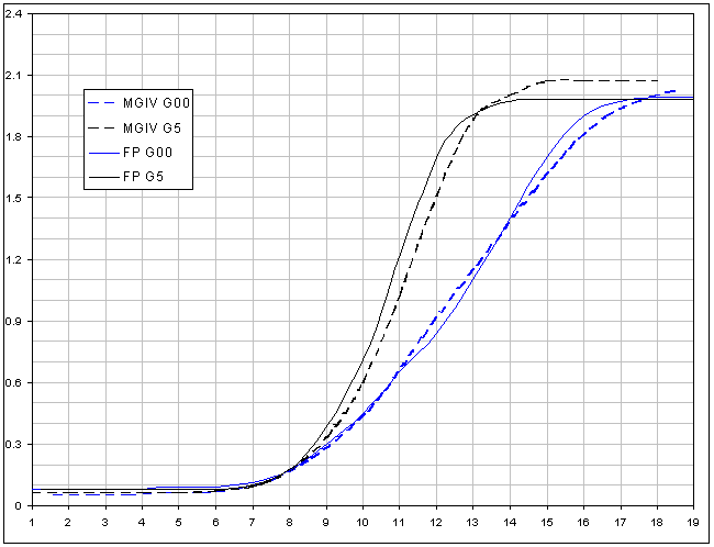

This is what I found using the recommended "equal exposure" filter values described in the Kentmere documentation with Ansco 130. Looking at the recommended values, the values do seem very close compared to the widely spread MGIV recommended values. The curves I plotted had very little difference from grade 2 to 4 and then a big jump to grade 5 which had much the same curve as G5 in MGIV-FB.
I have not had a chance to retest using Ilford MGIV filtration values on the Fineprint, which I suspect will give better separation. Ditto forgetting about "equal exposure" values and using the Kentmere "raw" grade filtration.
Good news is that the split-filter method works fine with a very shallow G000 (i.e. full yellow filtration gives a very soft grade indeed) and a nice steep G5 with full magenta...
Cheers, Bob.
[edit: added a plot of Fineprint FB and MGIV-FB for grades 00 and 5 (roughly speed-matched to allow easier comparison). As you can see, the grade G5 seem practically identical in slope and MGIV G00 is very slightly softer. Fineprint has slightly higher dmin and slightly lower dmax; whether you will see this in a print is moot. Without the speed-matching performed on the graph, Fineprint is slightly faster than MGIV - maybe a third of a stop. X-axis numbers are arbitrary - 1/2 stop steps on my transmission step wedge.]
