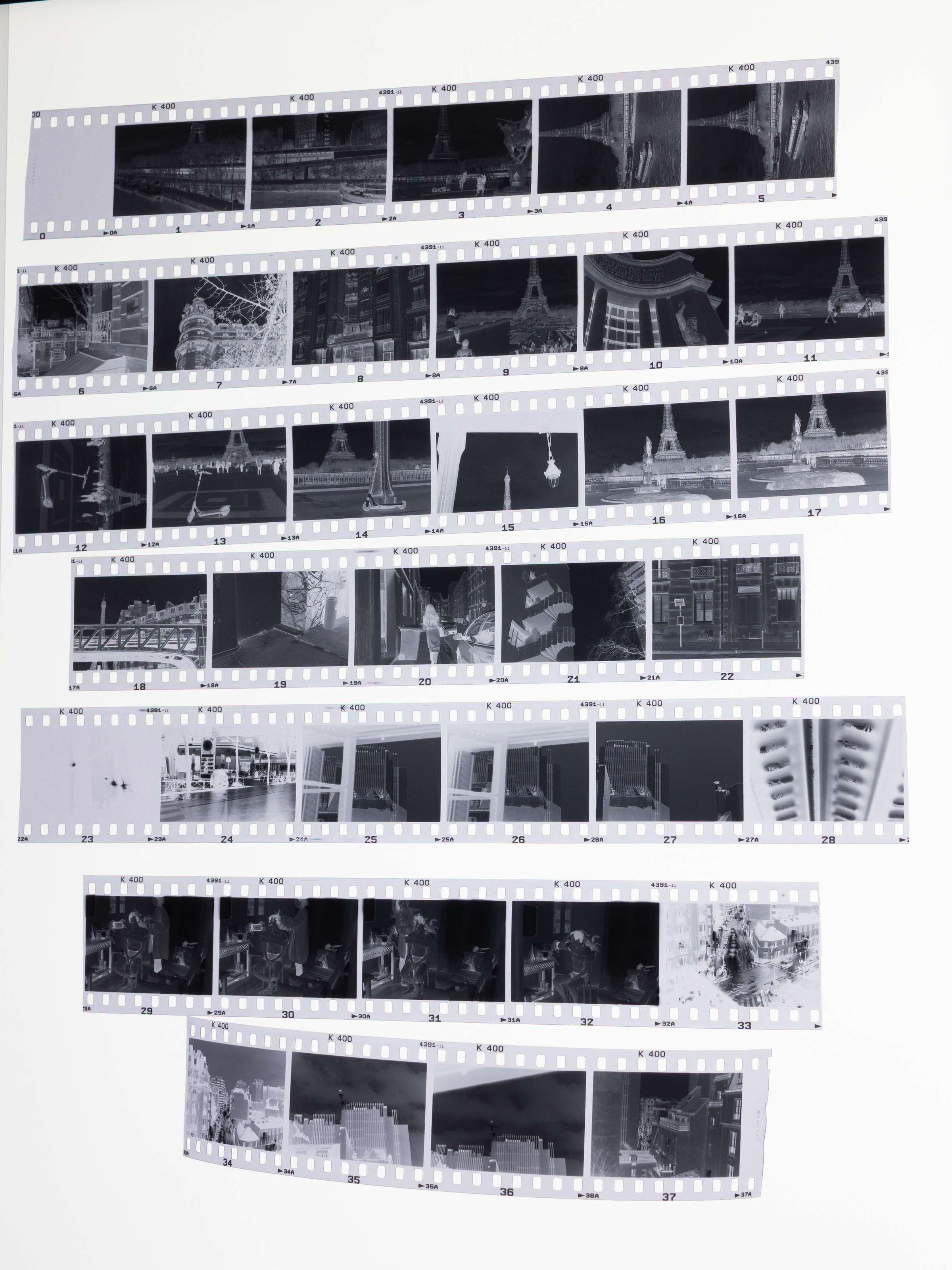

I just developed my first roll of Kentmere 400 in Xtol 1:1 for 12 minutes with three inversions every 30 seconds for agitation. The 12 minutes I got from the Massive Dev Chart.
The negatives came out a bit denser than I expected. I don’t think I’ve lost important highlight detail on this occasion, but I’m wondering if others have already pinned down a good regime for Kentmere 400 in Xtol before I develop my next roll.
I’ve got too many variables here: I was a bit casual with the temperature because I was in a rush, and I’m not 100% confident in my FM2n’s shutter.
The Kentmere 400 datasheet gives no clues about Xtol or the density I might expect from this film. I guess you pay for good documentation when you buy HP5 Plus or Delta 400 instead.

No sunlight here at the moment. I balanced a neg strip on two glasses over my phone display and took a picture of a frame with typical density.
Any use whatsoever? Click for bigger.

Right, I tipped over my iMac and laid the negs on the screen at full brightness on a white page. This is the result:
The dark frames like the one I showed earlier were given full exposure, whether metered with an incident meter or my FM2n’s built-in TTL meter against an estimated mid-tone. Frames 29–32 were given one-third stop more exposure than an incident meter indicated.
The much thinner frames are mainly underexposed hand-held shots with not enough light. For example, frame 23 is some crane lights against a night sky, shot through a window. Frame 28 was exposed for the light through the slats of another window. Frame 33 was a hand-held street at night from above.

They do look a bit on the contrasty side indeed. That might have many causes, like a not very accurate thermometer or a light meter not functioning properly and also agitation might add a bit. When you want substantially less contrast, you need to reduce at least 25% in your development time. Remember the data on the MDC are only suggestions, often from unknown and unverified sources. Developing your onw films should result in negatives that suit your individual needs. I would suggest in trying 9 or 10 min for the next film with this camera, using the same thermometer and trying to make sure the developing temperature is close to 20 C. as only reducing agitation won't reduce the contrast that much.

I second the idea of a much greater reduction in development time, like 25% to see a significant change.

The exposure looks decent, but the development looks to be too much.
Remember, within a fairly wide range, exposure controls how the shadows appear, while development controls the contrast and how the mid-tones and highlights appear.
