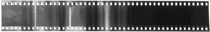

Recently shot (first time) some Kentmere 100 135. In an Oly 35RC, but that is immaterial as seen below. After ~12 frames, cut the film in the darkroom and developed. Result below.
Further down the strip (to the left) the banding progressively disappears and some frames were usable. Light leak from a known good camera?

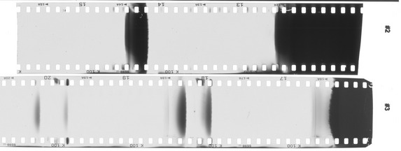

To be sure, I took the cartridge with the remaining film and left it for a few hours on a table, indoors, cloudy weather, never direct sun. Something I did without thinking in the past without any negative consequence. For good measure, I brought the cartridge close to a fluo tube for a few seconds. Then loaded some film in a tank and developed. Stripes again. No camera involved this time. See below #2. But maybe the part bringing the cartridge close to a fluo tube was excessive? So repeat, indoors, no direct sun a few hours, load, develop. See below #3 (with possibly some tail of the #2 experiment).
Do you agree with y conclusion that we are seeing a light leak at the cartridge lip?

There was a thread a couple of months ago. I think @logan2z had exactly that problem with some Ilford film - Ilford admitted to him that some of a particular batch of cassettes were faulty and sent him new film. Maybe someone could provide you with a direct email address instead of the online form? Your fogging looks identical to his.
It's light piping in the base, Kentmere does not have the same level of anti-halation treatment as Ilford films - and Ilford have been clear about this and other measures used to make Kentmere as cheap as possible. I've had it happen with K400 if you aren't careful about unloading in subdued light - can't give you an EV number though.

See this post in the thread I mentioned. Ilford admits it is a problem with the light-tightness of the cassette.

How would light piping from the outside jump over (or pipe through) ~5cm of film left intact and deposit a localized strip of insolation? I would expect piping to extend continuously and gradually attenuate from the exposed leader into the nominally unexposed film.
the classic "light pipe Effect" will result in the light coming out at the perforations., so black band around the perfs.
the roll is about 1 inch in diameter - so repeated fogging at PI inches would be the light trap.
Update. After sending an email to technical@harmantechnology.com, as suggested by @logan2z, I got a response from a nice lady who wrote to me on 25-Jan but had her message bounced by my mail server for an unclear reason.
She wrote that it's a known issue, but a rare one. She also wrote that Harman would send replacement films. When I pointed out to her that the three tests that I documented were repeats from just a single cartridge, she replied don't worry the films are already on their way.
